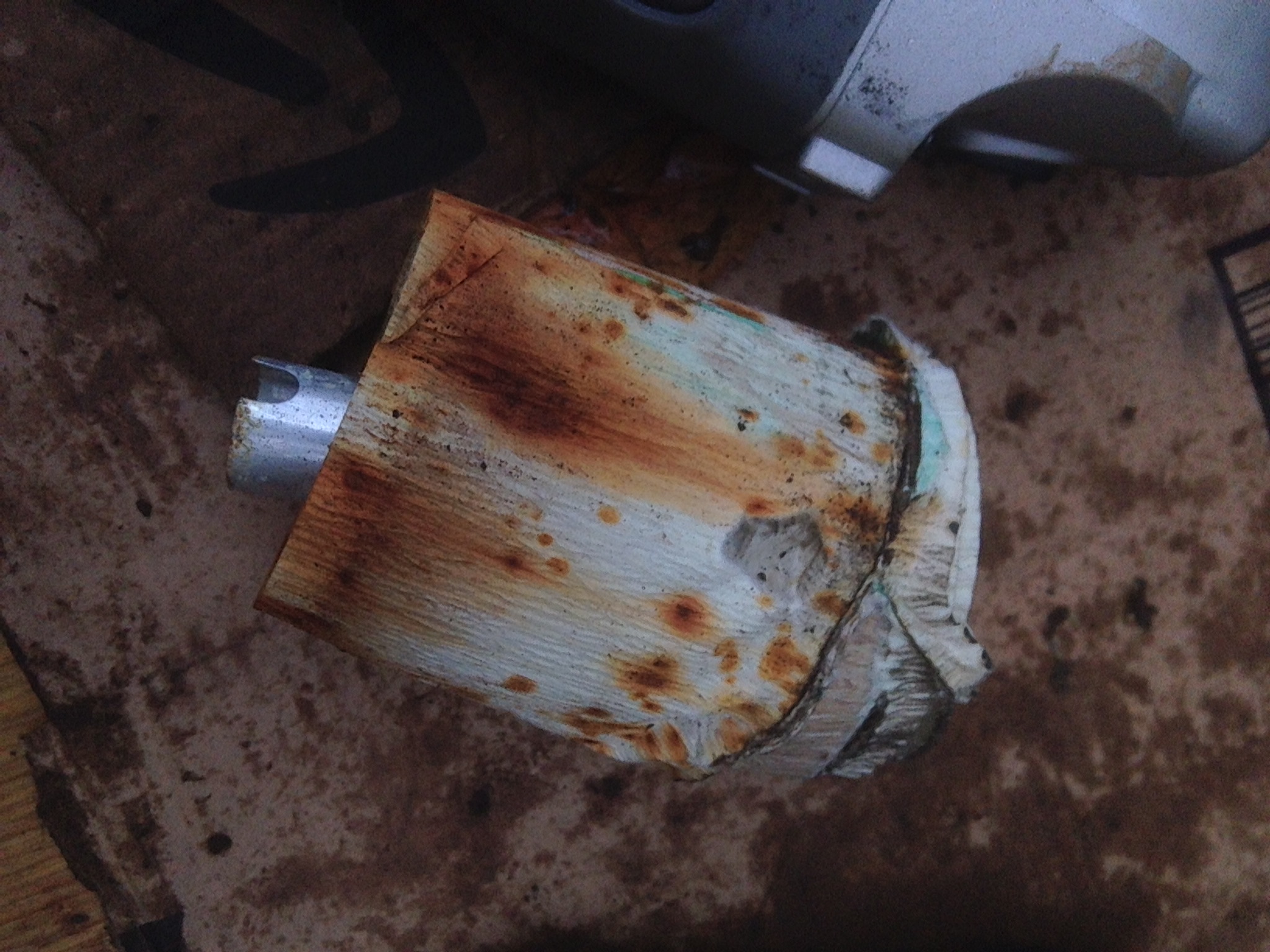

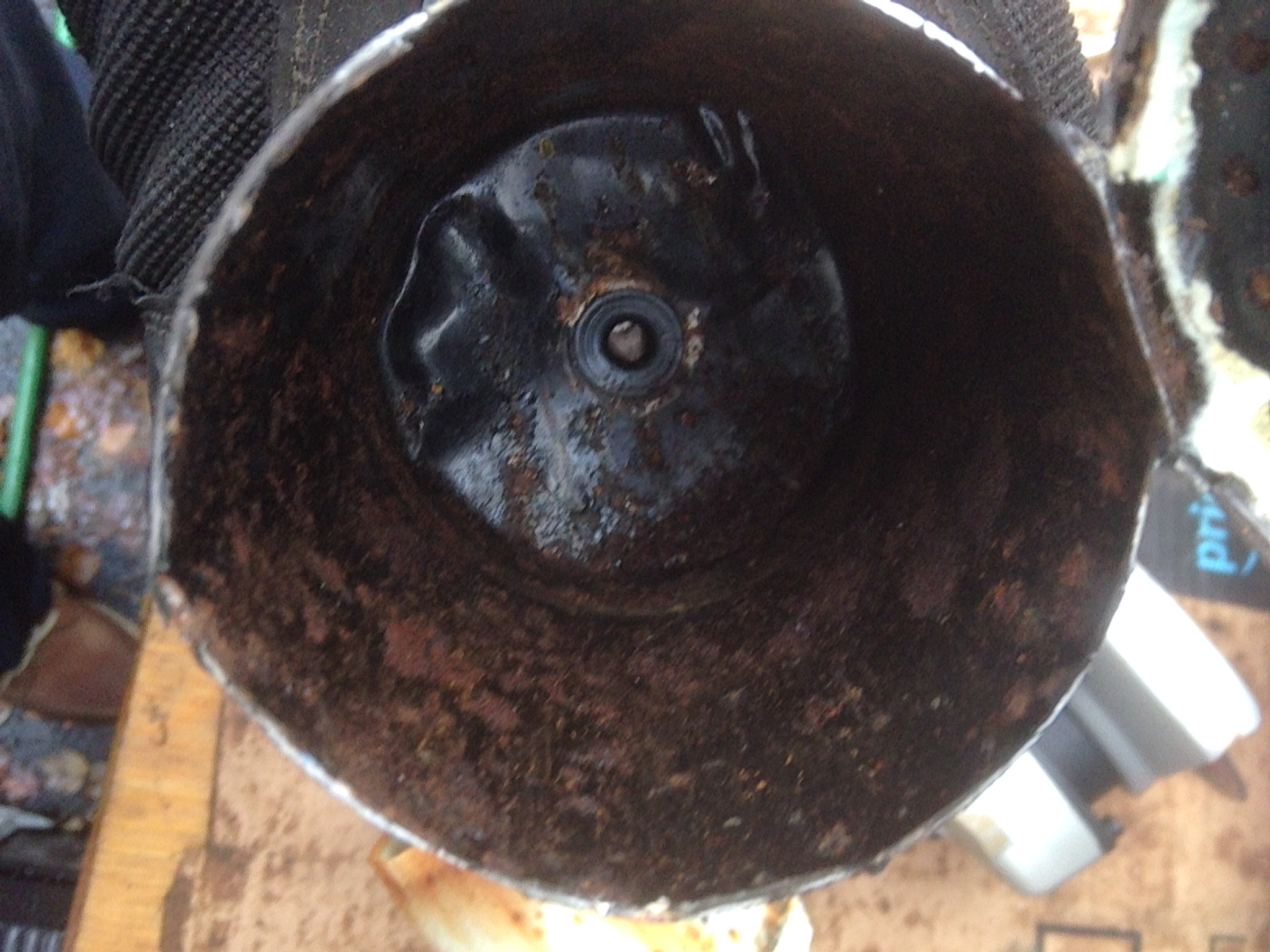

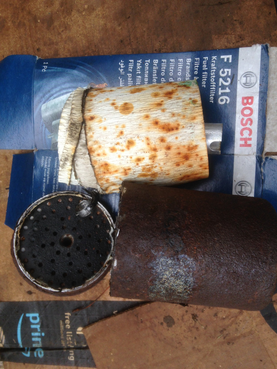

Might want to swap the fuel filter soon. Could be getting plugged which could cause some other nonsense.

Maybe I can sell him my old one.....wizechatmgr wrote: 08 Nov 2020, 18:38 Might want to swap the fuel filter soon. Could be getting plugged which could cause some other nonsense.
