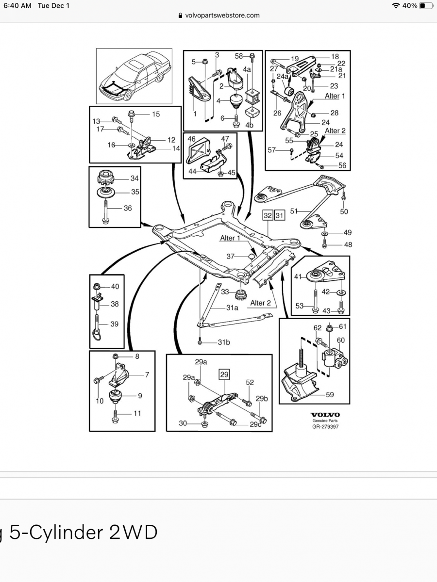

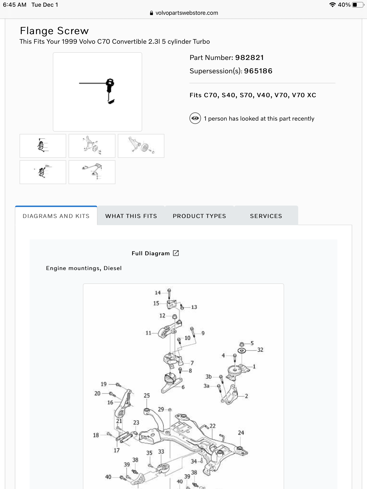

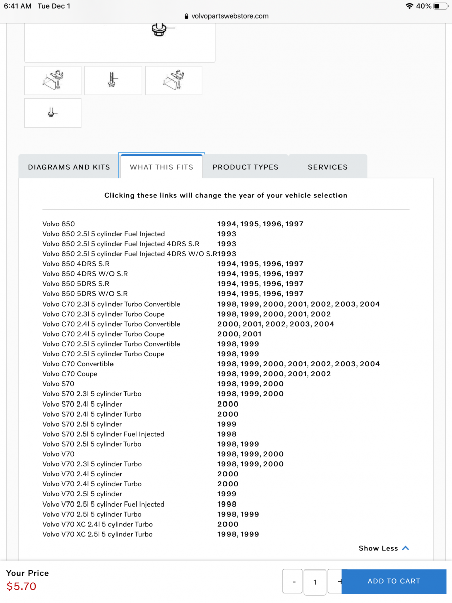

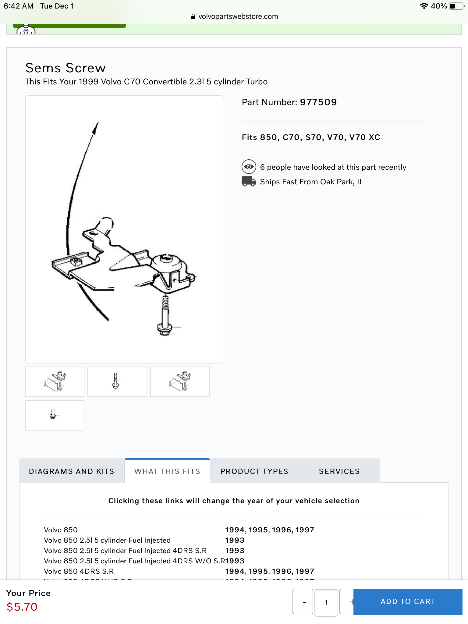

If you do go down that route you'll need to keep the subframe bolts from the breaker C70. They're slightly longer, and that length is needed to clear the additional thickness from the brace. The only reason I suggested simply swapping the subframe is because those solid mounts are a real pain to remove. As you say though, with a 2004 there is one different motor mount and the four bolt control arms can be a pain to deal with at times.
- Posts: 36175
- Has thanked: 1614 times
- Been thanked: 4078 times
I pulled up th C70 and got 977509 for the bolt hardware for the big ones
Looks the same?
Looks the same?

I was under the impression #53 and #50 are the same, but #48 differs. Being wrong here is definitely a good thing, though, as it's one less thing to consider.
- Posts: 36175
I think you are correct on this. 48 shows a bunch of different applications.Cookeh wrote: 01 Dec 2020, 07:08 I was under the impression #53 and #50 are the same, but #48 differs. Being wrong here is definitely a good thing, though, as it's one less thing to consider.
