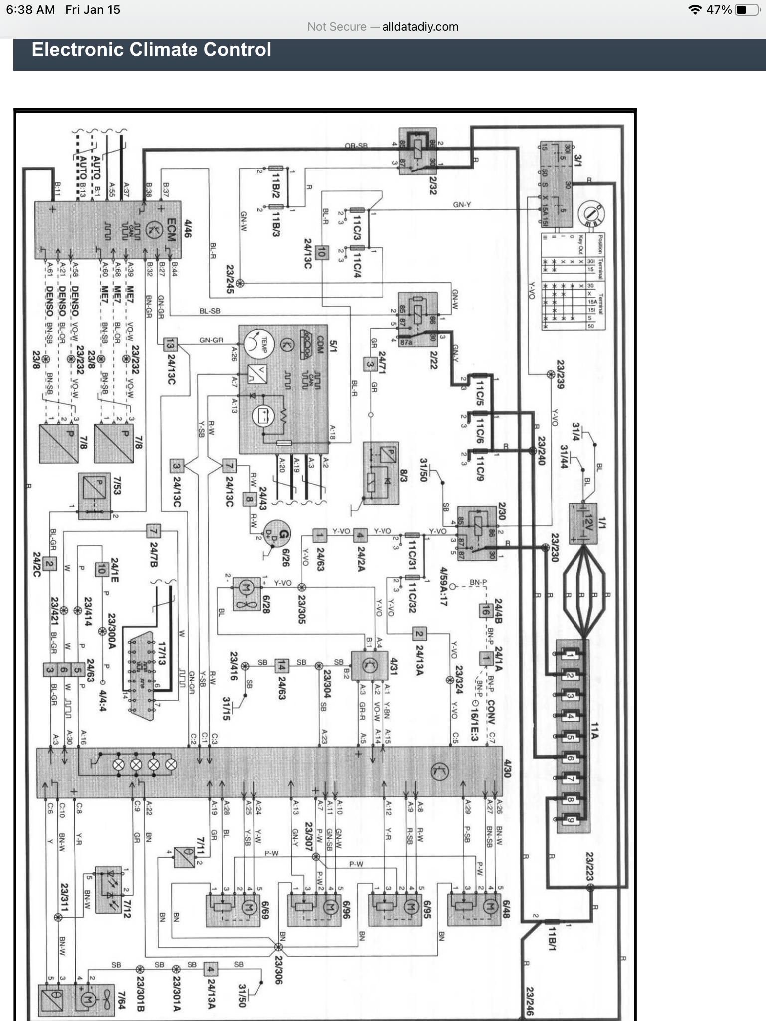

Posts: 35267
Has thanked: 1497 times
Been thanked: 3809 times
I think the whole unit Is electrically dead until it warms up, reading the top post.
11C/32 is the main fuse feed for the ECC CONTRIL UNIT, per the diagram
Pin C5 on the bus
