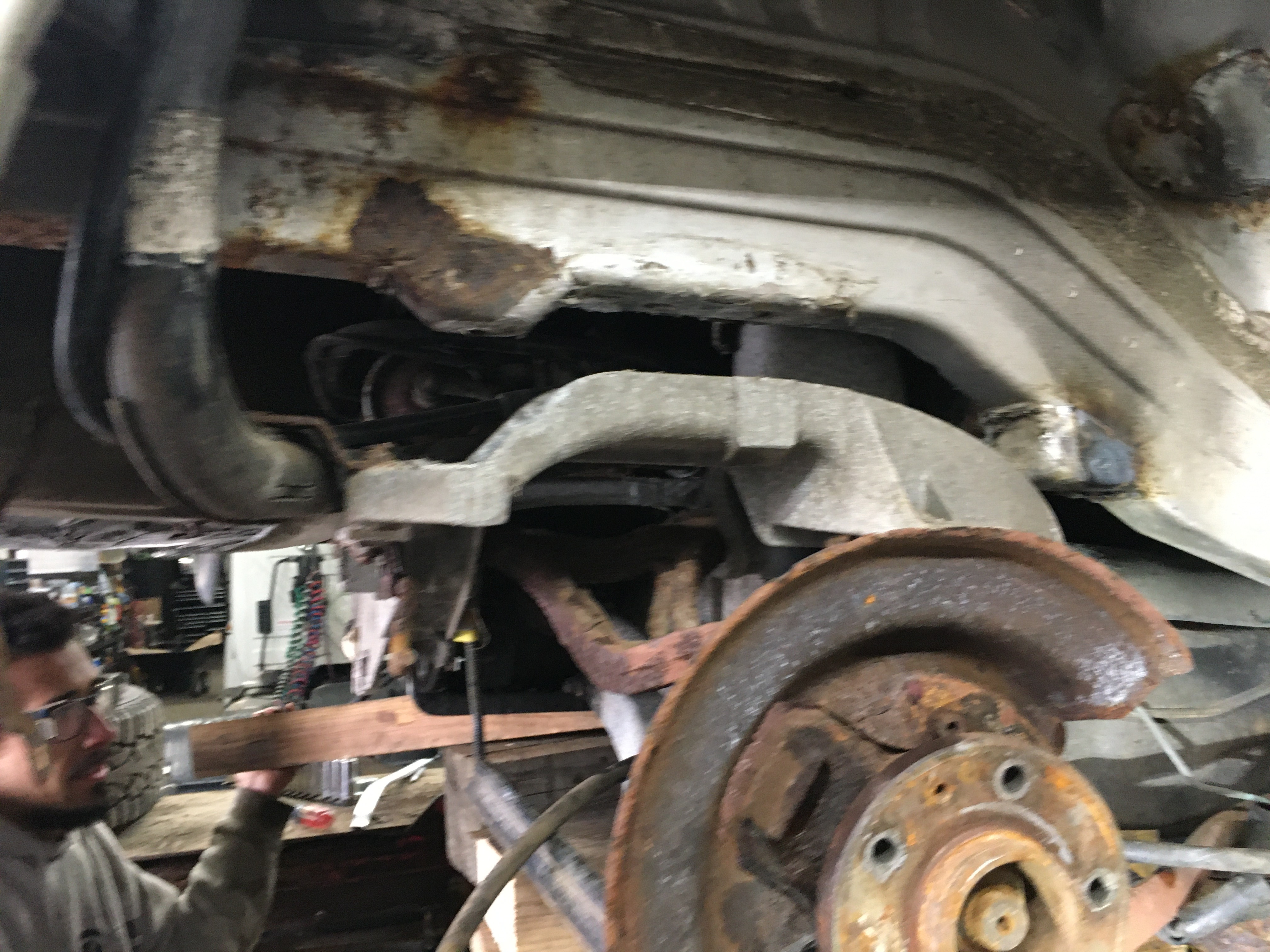

Well, this aint happening without a lot of welding...look at the mounting bosses on the Awd. Maybe the delta links bolt in but I don’t see it going FWD to AWD easily

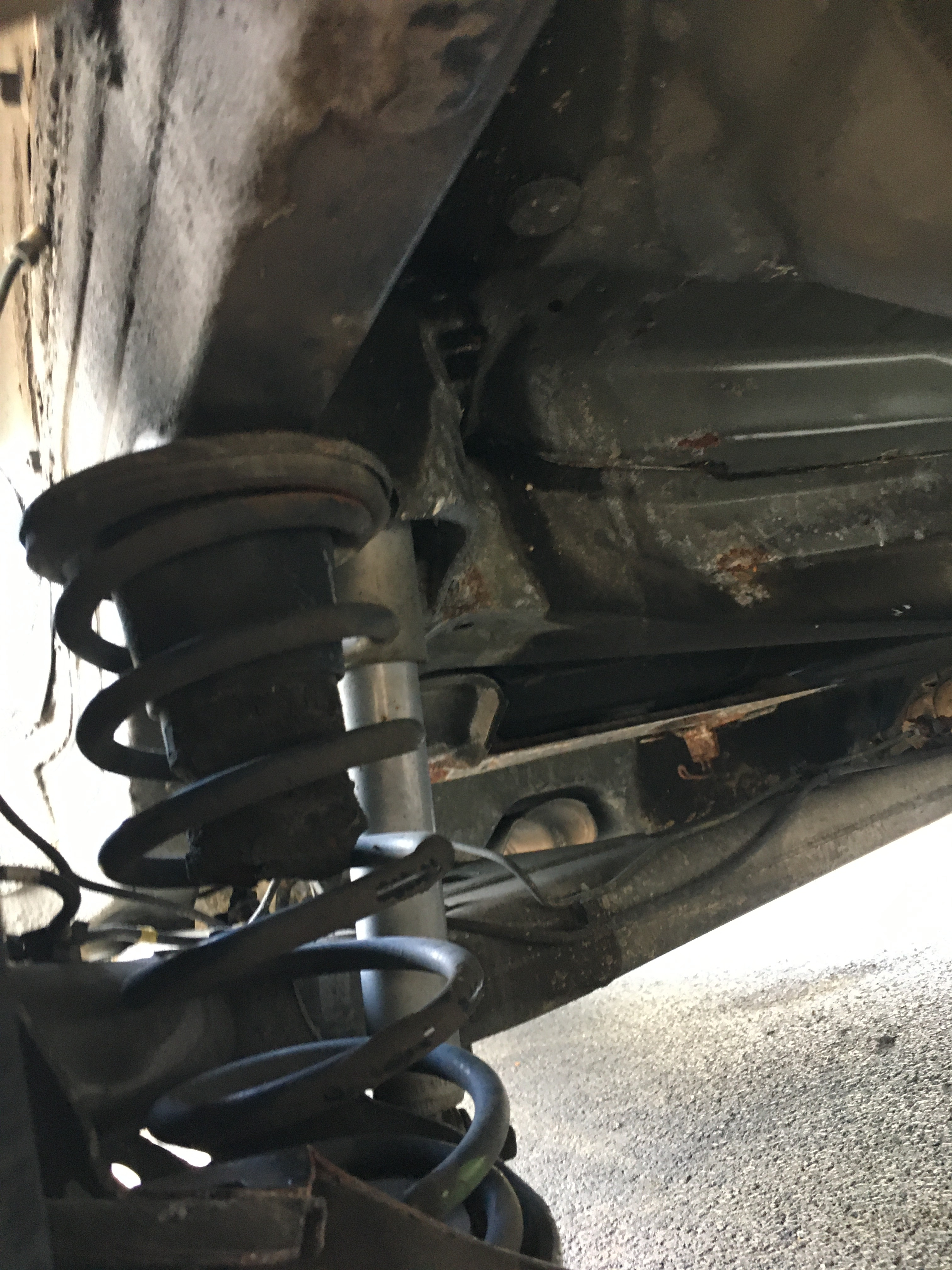

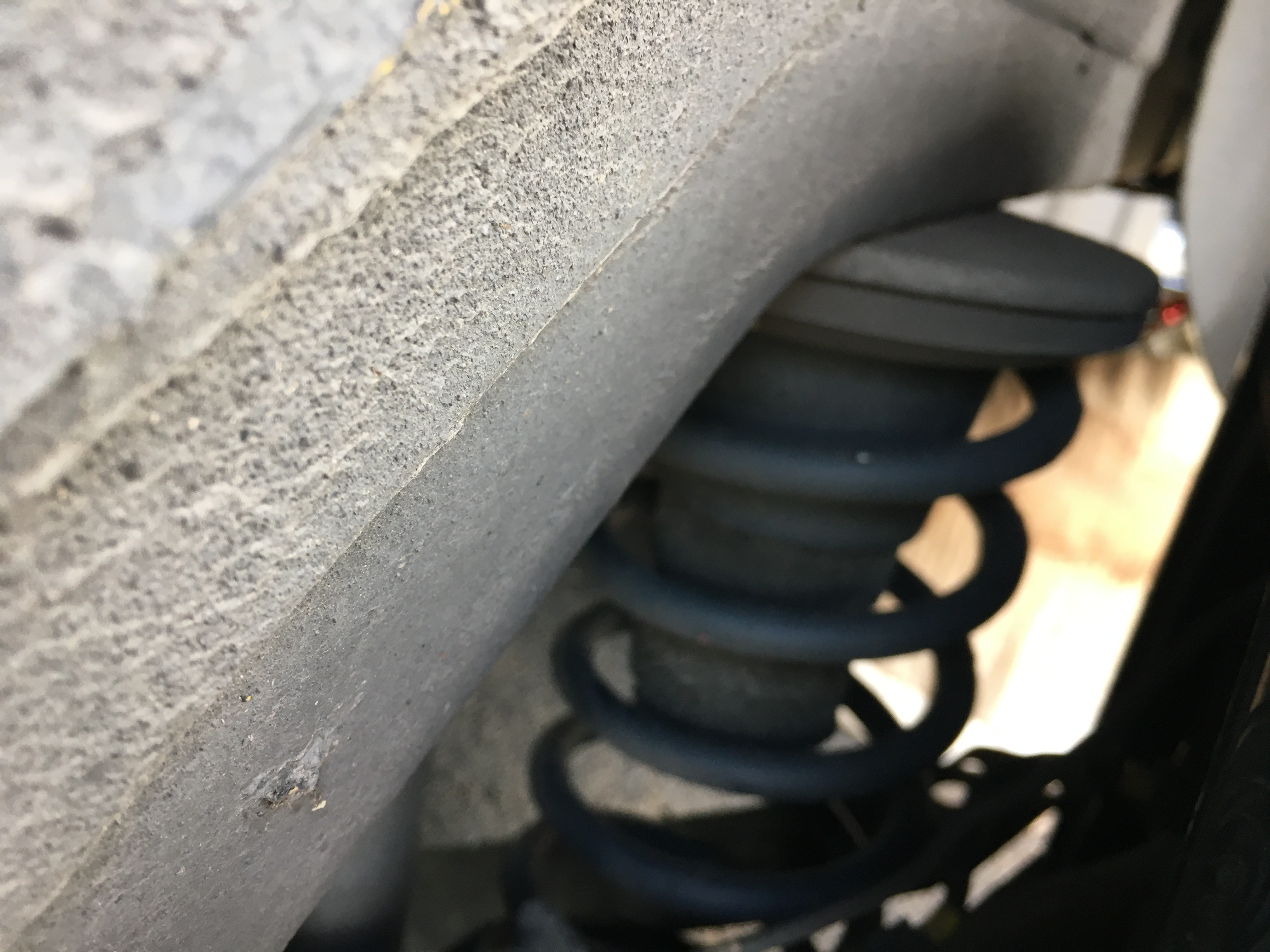

I’ll try to get a better shot of the FWD shock towers to see if the chassis are identical there.

I think AWD to FWD is bolt on in the rear, but FWD does not have the bosses to screw the AWD carrier into.
