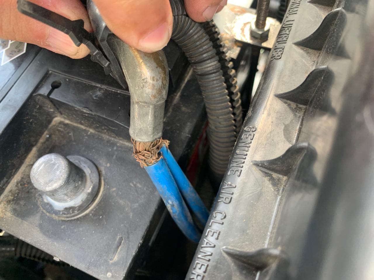

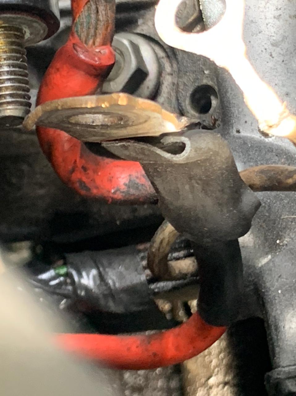

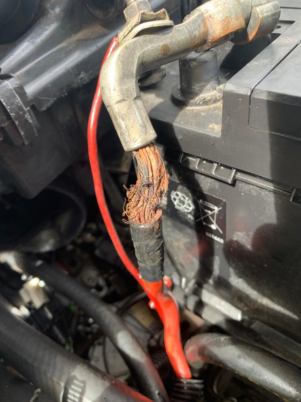

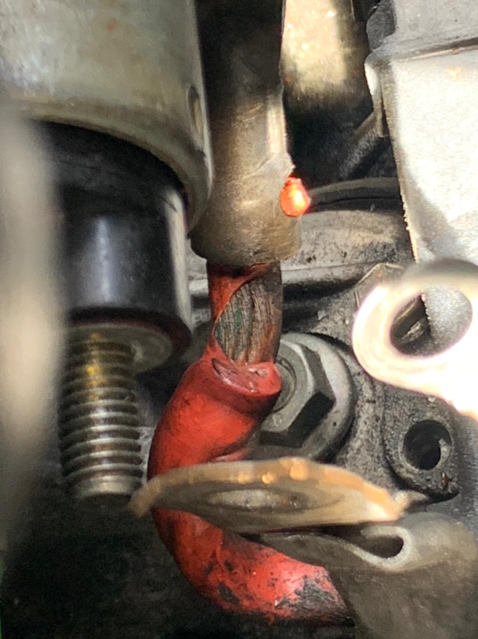

So, I checked the battery cables and found it melted a little bit near the starter motor, the insulation on the cable that connects to the alternator was also broken, and the cherry on top of the cake, I found a LOT of the cable was broken near the battery, under a full roll of electrical tape. The negative cable doesn't look very good either.
Anyway, I'll change those cables and report back. Do you know by any chance what gauge those cables are? Parts availability here is scarce at best and the few places that sell them charge up to 5 times the price because "if you have a Volvo, you should have money", so I figured it'll be much cheaper to have them made to spec.
Thanks in advance!
Edit: Pictures of the cables attached!

That's not terrible, and might not be the source of your stalling. But you do want to do that correctly. Sorry, I don't know the wire gauge. Park at a electrical shop and have them come out and show them.
I'd check grounds viewtopic.php?t=69375
