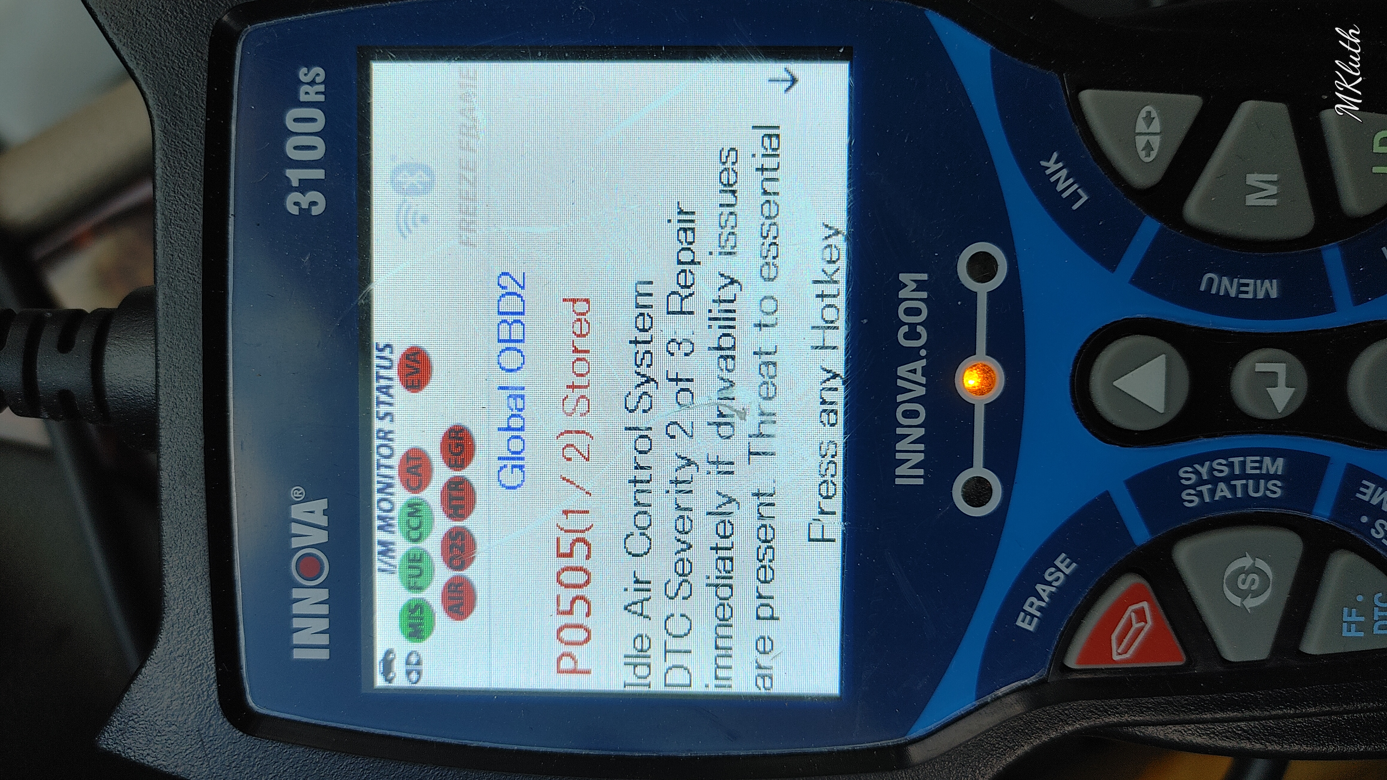

I drove it home from Fort Smith just fine with a slight idle/miss. The idle has only gotten much worse as ive been diagnosing the misfire/rough idle issue. I have searched 'p0505' within the first 5 search result pages on here. That stuff didn't help me. Please refer to pictures of code p0505 and Youtube videos of the idling. Please watch video #1 before #2.

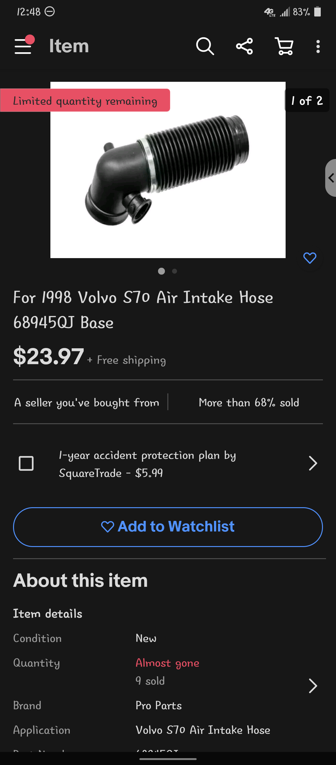

There is supposed to be a line going to airbox but there is none because previous idiot replaced it with cai w/o doing his research. He capped it off. Also my intake hose to the TB is almost completely torn and worn off. Idiot chose to use glue in order to keep it together. Its not together though. This dude chose not to replace any item needing to be replaced but thought blowing $900 on wheels and another $100 on CAI was a crafty idea. What a joke! Ive spent the last week NOT driving my car in order to replace all the parts he did not. My mom, not knowing anything about cars, called my GT a pile of junk. Both mom and dad think Volvo is trash because of my luck with Volvos. Id like my dad to trash his 2019 Ram before he talks about my car choice.volvolugnut wrote: 01 May 2021, 15:33 Rough idle is often caused by a vacuum leak. I recall you changed vacuum hoses and you may have left one off or loose. Check them ALL again.

Don't ever buy this replacement part on eBay. The pcv notches were wrong and the pcv connection was superglue on there. Im pissed off. My anxiety was hyped and after breaking this new part, it went back to being hyped again. The Chinese cant make crap right. And Im an idiot for cheaping out for that crap.

Gas system. This includes fuel pressure and filter. Also check injector leads and if any oil has leaked into the plus. Code P0505 is for an IAC fault. Check out this link:
