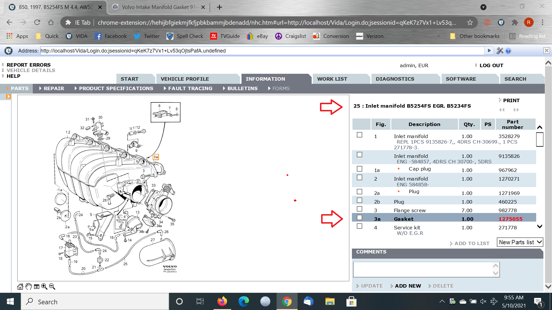

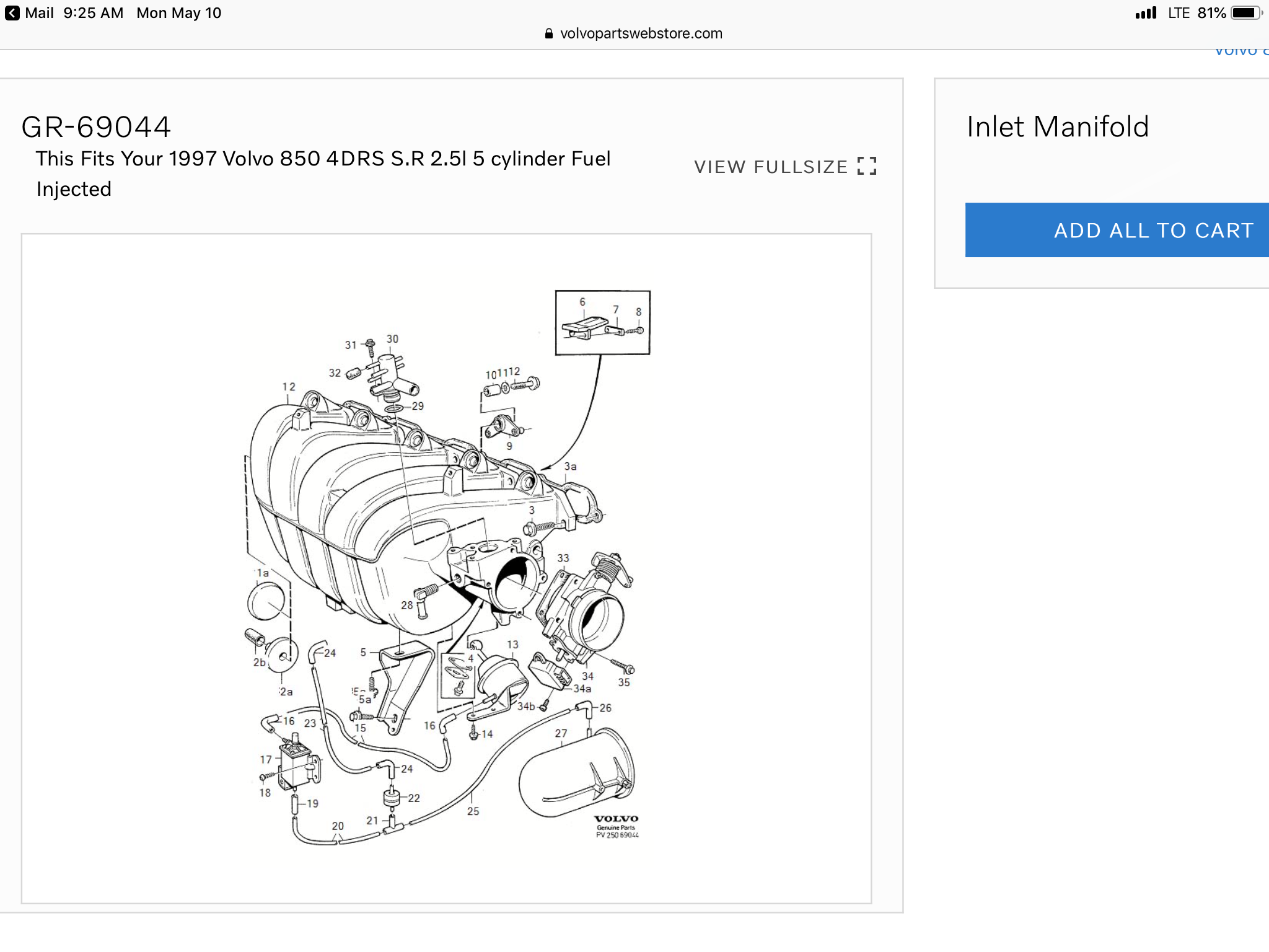

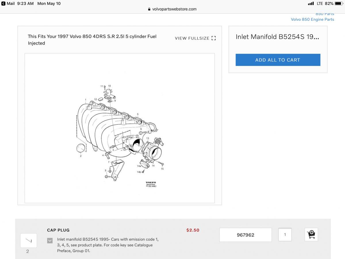

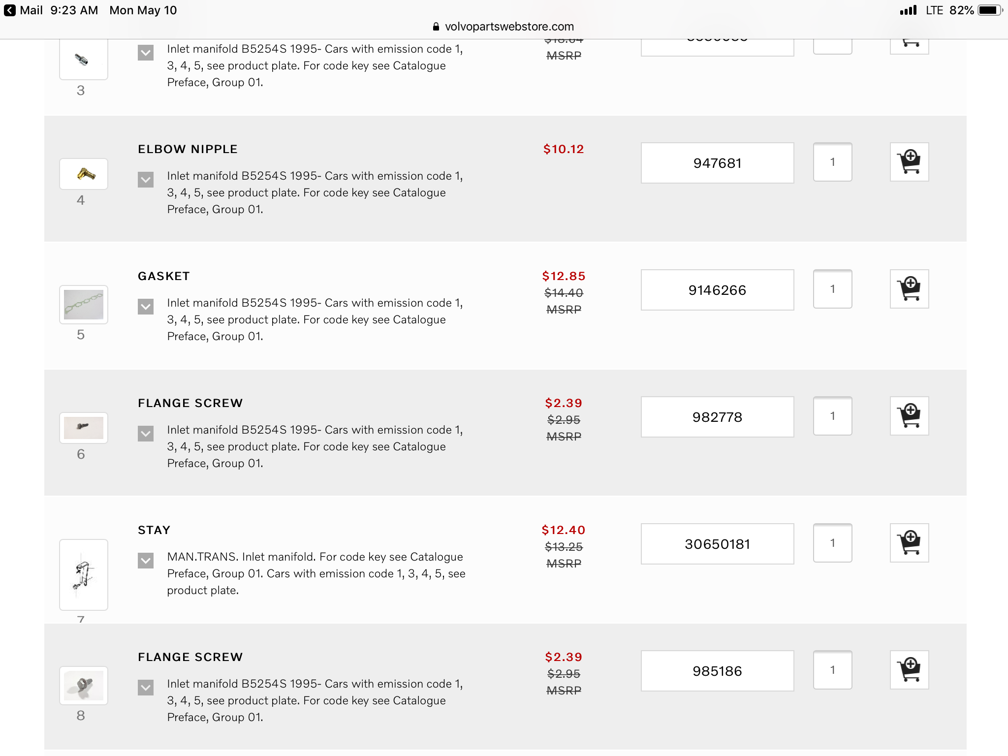

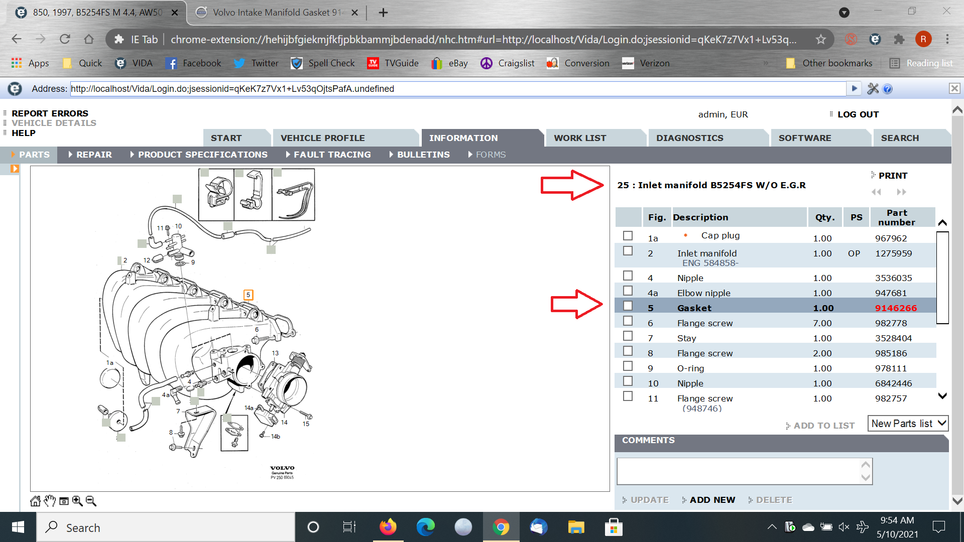

RickHaleParker
Posts: 7195
Joined: 25 May 2015, 14:30
Location: Kansas
Has thanked: 8 times
Been thanked: 977 times

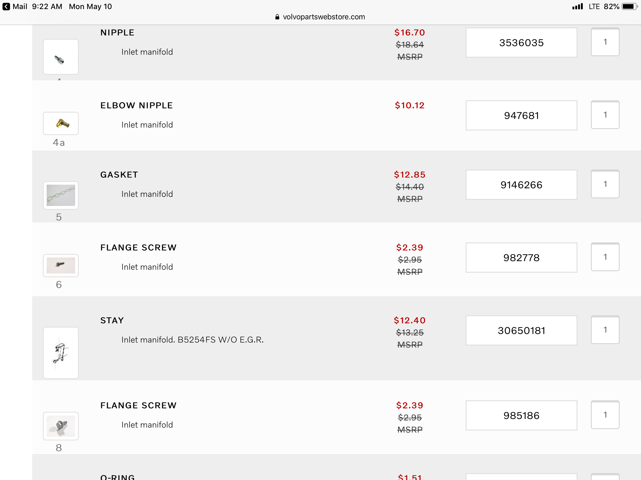

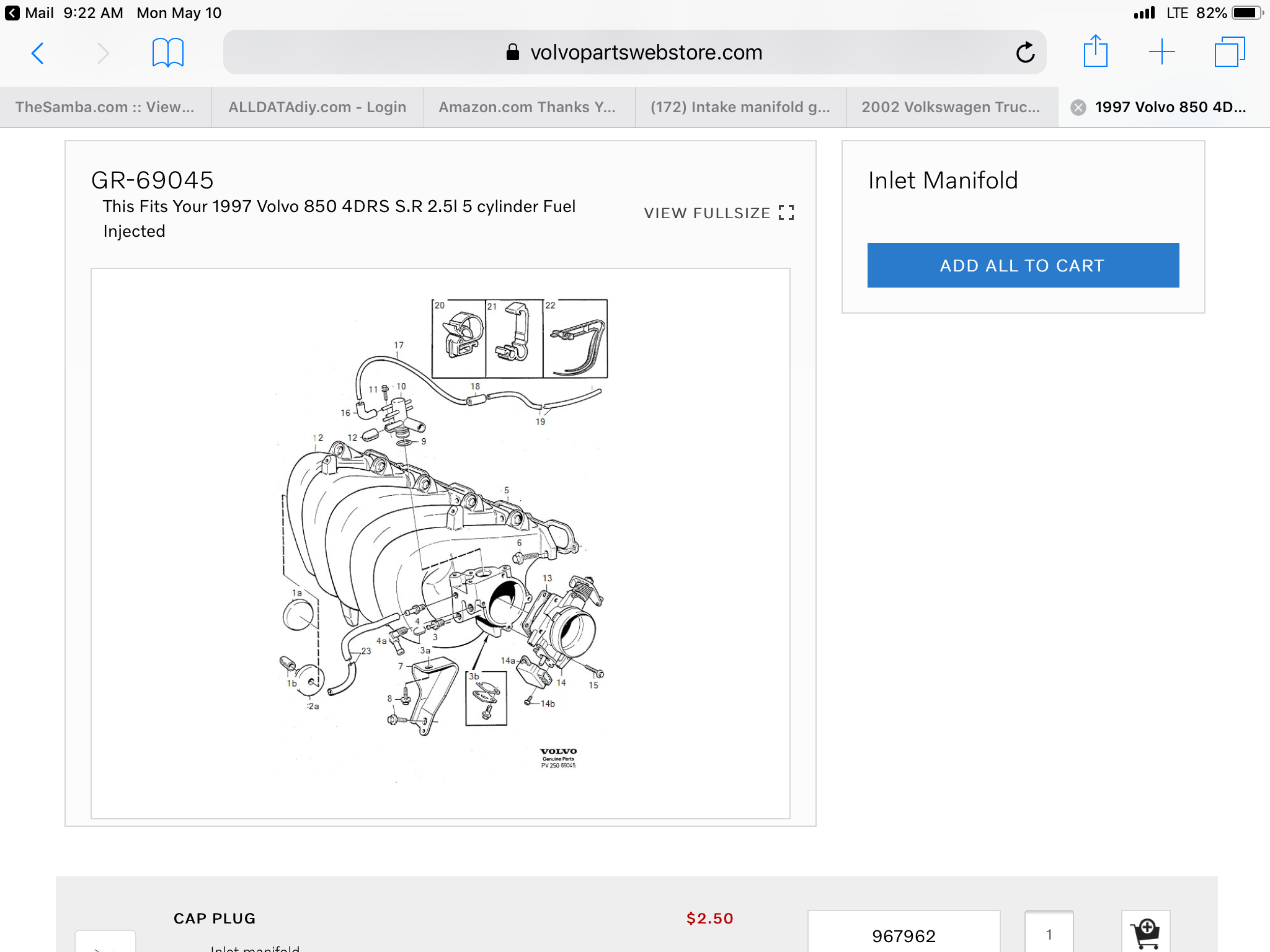

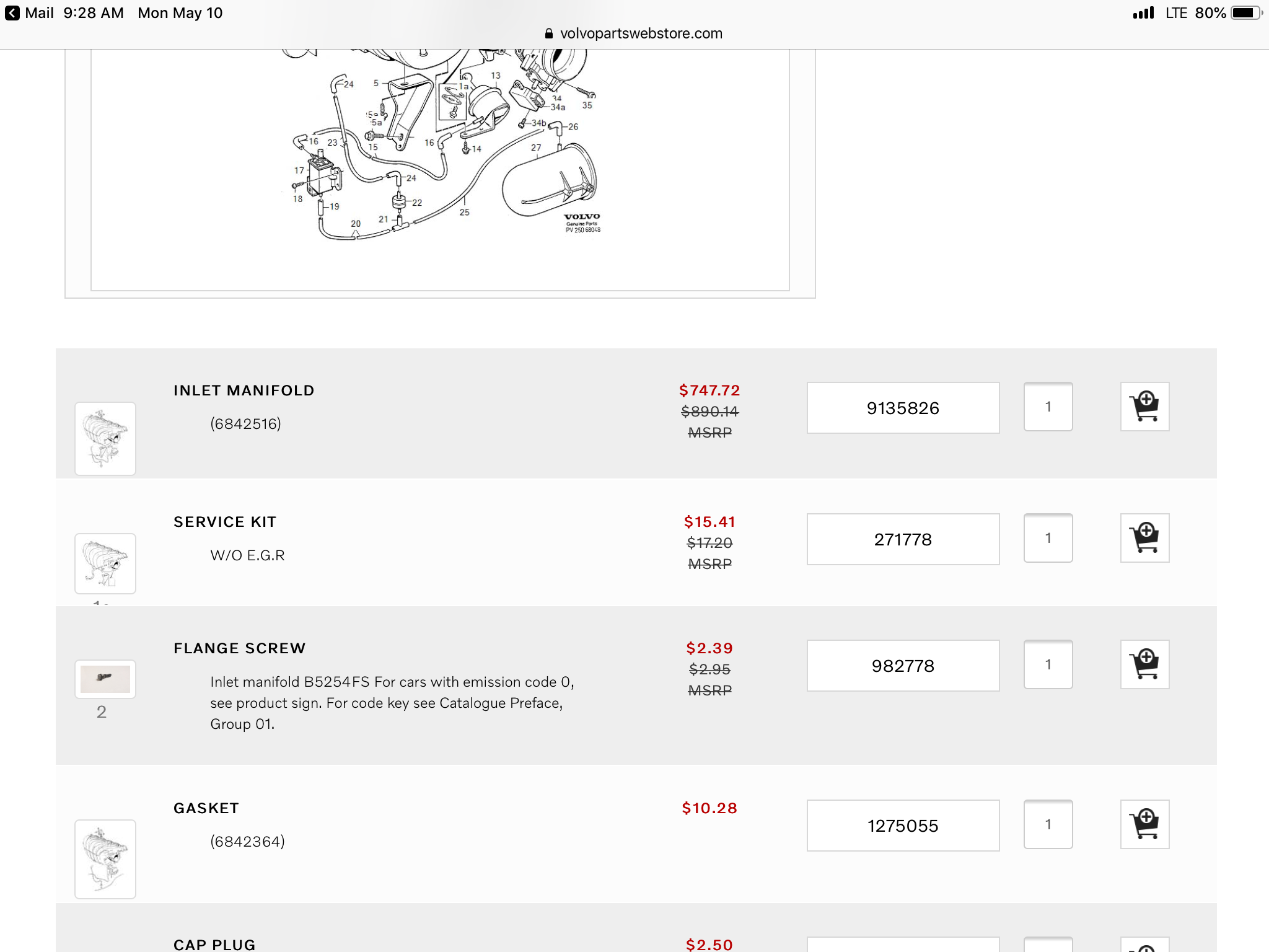

Post by RickHaleParker »
Active
Past
erikv11
Posts: 11910
Joined: 25 Jul 2009, 14:03
Location: Iowa
Has thanked: 311 times
Been thanked: 817 times
Post by erikv11 »
The illustrations are wrong, none of them show the notched gasket/IM. The part number guidance seems to be right. Keep in mind Volvo's databases are known to be peppered with errors.
This one is simple to solve. Look at the car.
You can send me an IM part number and if it's easy to check I'd be happy to.

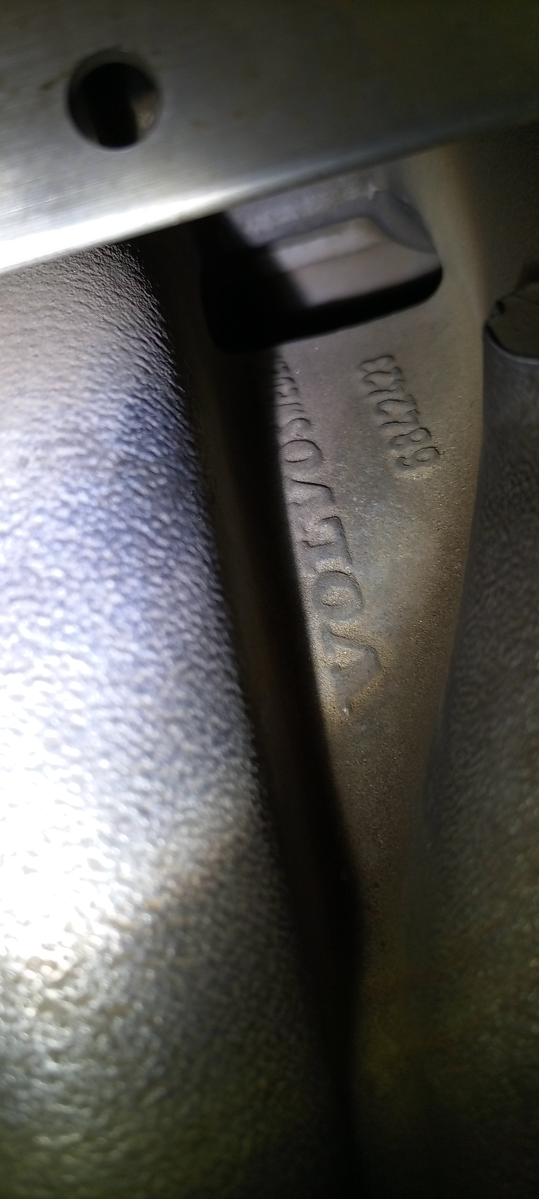

misha
Posts: 5437
Joined: 07 Dec 2008, 16:09
Year and Model: 2010 Volvo S80 D5
Location: Serbia
Has thanked: 155 times
Been thanked: 432 times
Post by misha »
I can't find those notches....at least i don't know where to look for them.
I tried 1,2 & 5 and couldn't see them.
This is my manifold with part# 6842423 on it:

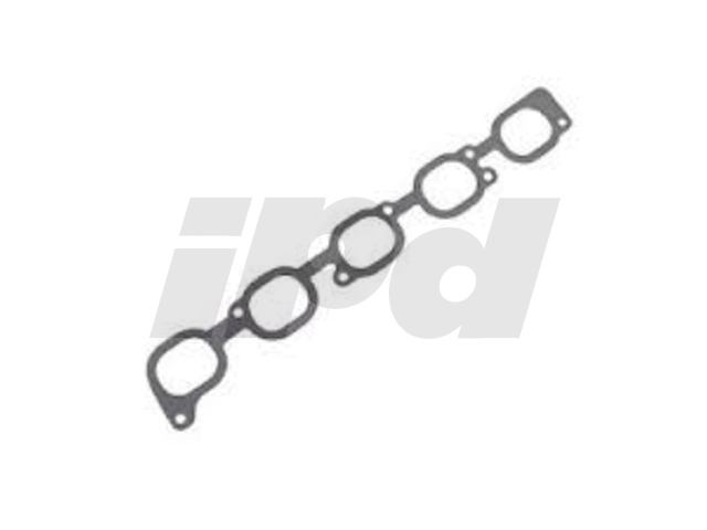

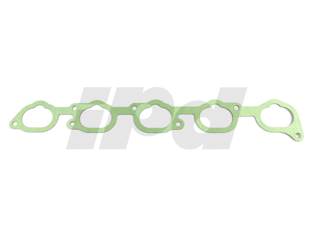

Note the shape of the ports.
9146266.
1275055
