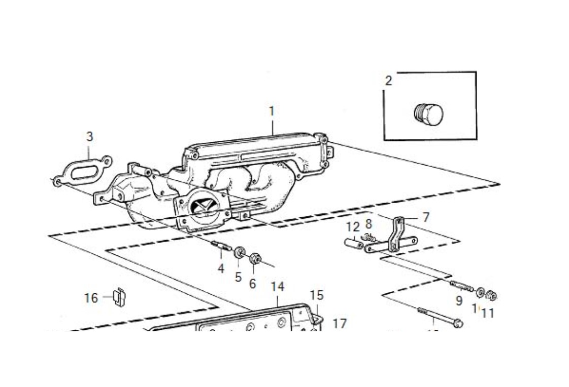

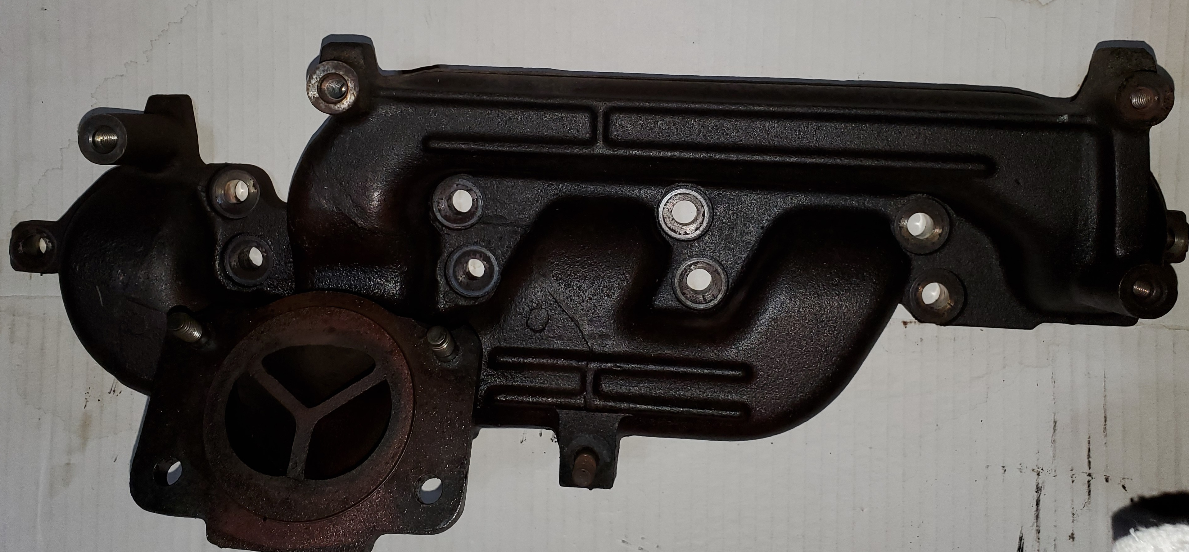

While working in the turbo area, I decided to install an R-style exhaust manifold on the car (less prone to cracks I have heard). After removing the old exhaust manifold, though, I noticed that the lower support hardware (shown in parts diagram #7) securing exhaust manifold to block does not line-up with a stud location in the R manifold. Other connection point(s) at the top also don't match. I'm wondering if I can easily make this work, or would a Japanifold be a better fit. The old manifold indeed has some cracks. Thanks.

Would it fit if you moved (7) over to the right bolt hole?

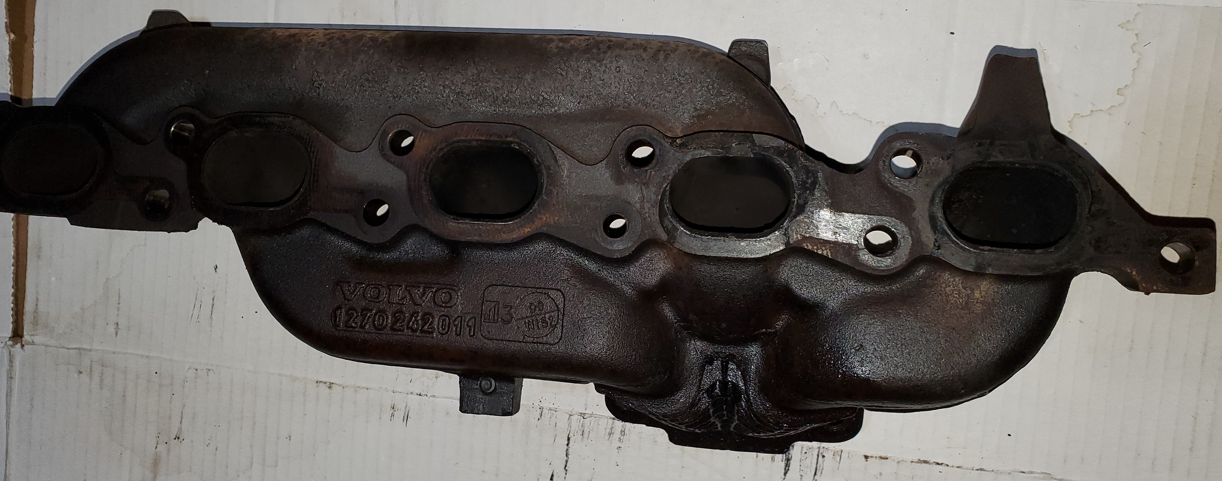

If you have an extra minute, would you mind sending a picture of the manifold you took off, front and back please? I've had credible people tell me that the 2000 XC already comes with the Japanifold. Sorry for the slight-off topic, but I've been trying to figure this out for a while now.

Exhaust manifold that I took off the car over the weekend, 2000 V70xc

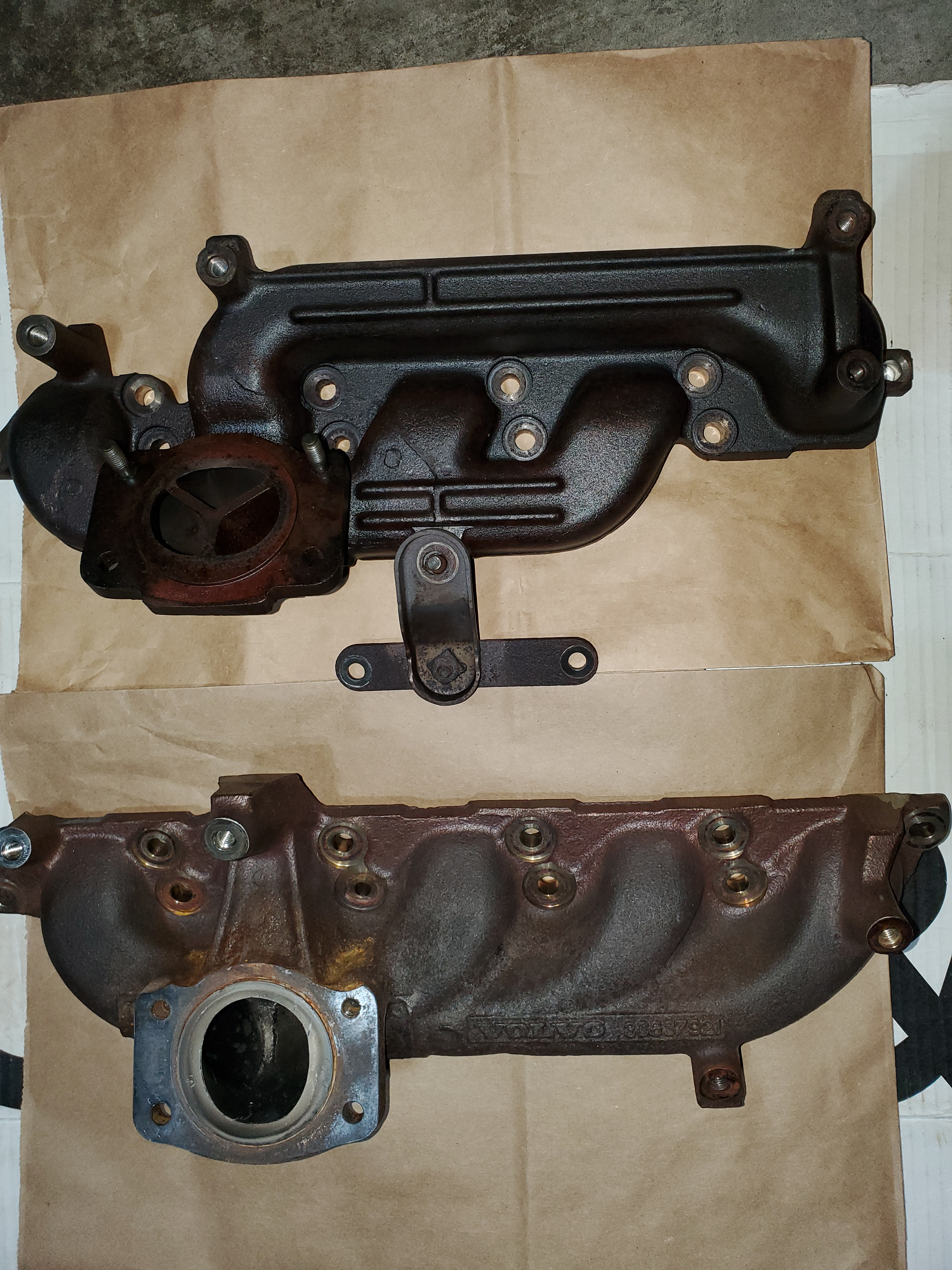

Showing bracket location, original and R manifold.

Some folks will tell you swapping from a "Japanifold" to an R manifold isn't really worth it. Claims are the J-fold flows better up top.

Are those two compatible with the same head? They look like a completely different manifold, all together.

Yeah, they both fit the same head.
Replaced a standard manifold with an R version on my '96 recently.
