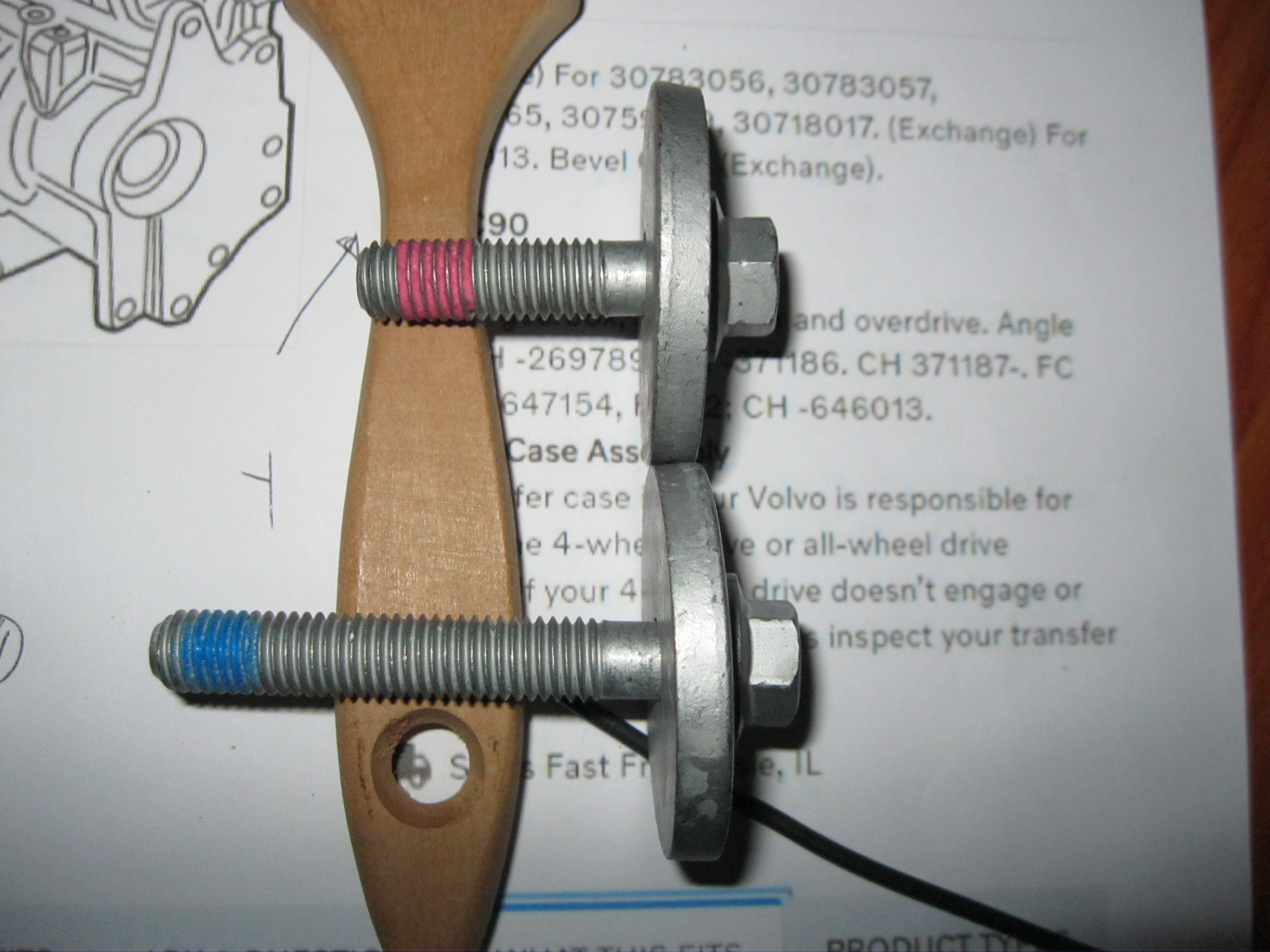

Posted this on Swedespeed, easy enough to copy over to here. Axle bolts come in two lengths- 40mm (30746705) and 65mm 30670602). IPD has a decent write-up on their site to help determine which bolt you "probably" have.
If you order the bolts today, below is what Volvo ships (rubber cone no longer included on the short bolt, replace from old):
These are supposedly single use bolts, torque to yield (controlled deformation). Cheap enough that I replace with new whenever I take them off, just for peace of mind. I have not had an axle ping issue with any one of my vehicles over 16 years, whether this is the reason or not remains to be seen.
