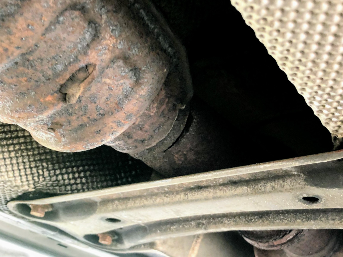

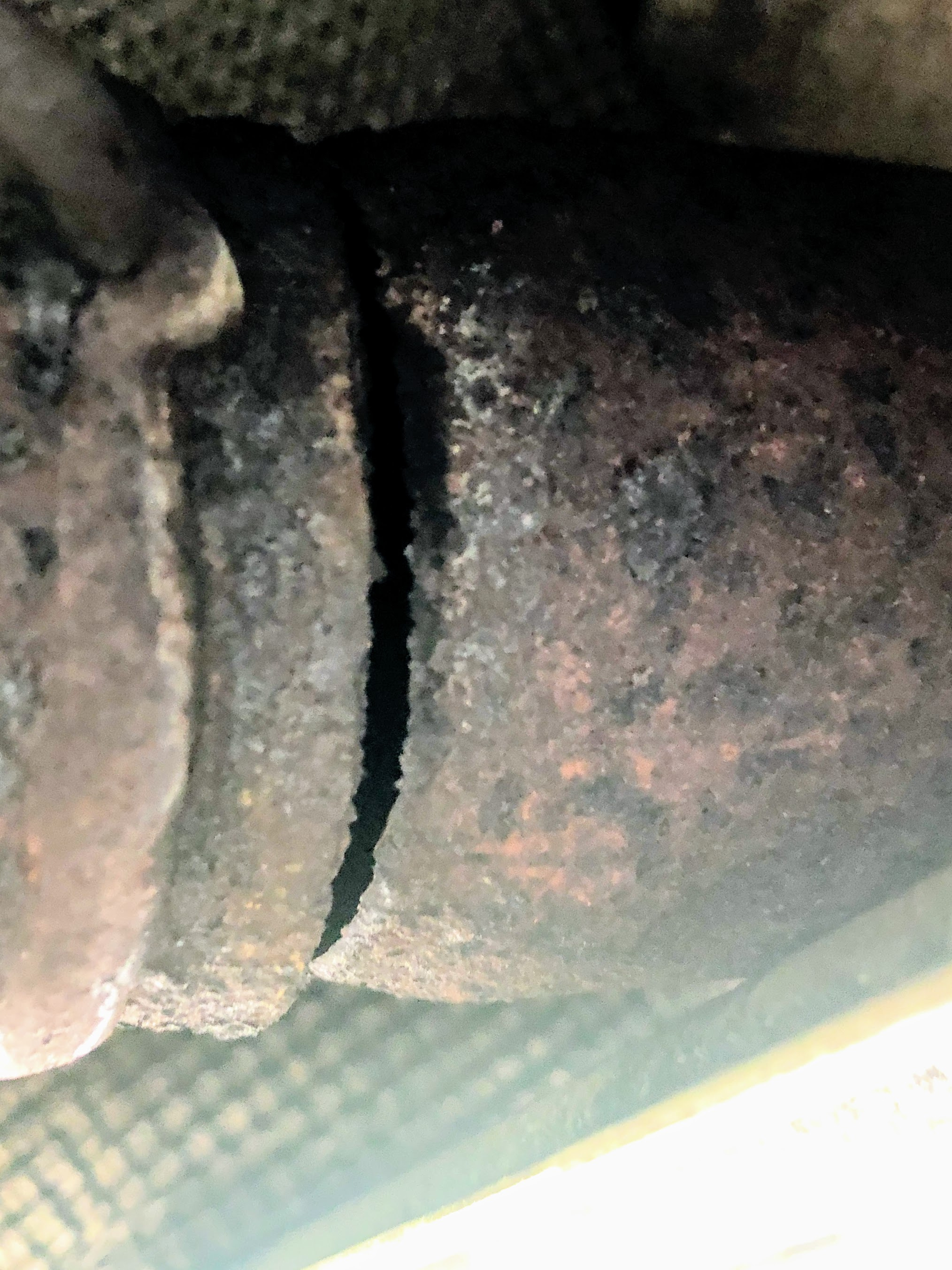

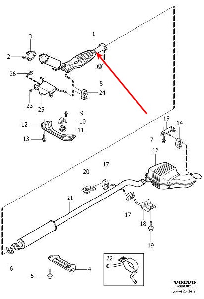

I was able to get under the car and take a proper look today. Turns out the problem is further back than it seemed. The pipe at the back of the catalytic converter is cracked. The location of the crack is indicated by the arrow in the attached diagram:
Here are a couple photos:
Considering the age of the car, and the expense of a new catalytic converter, and the fact that I don't have any welding skills, I'm wondering if I could get by with a product like "Holt's Gun Gum"?
This seems to be a UK-based product, but I'm assuming something similar is sold in the US?

The same thing happened to my 99 XC70 when I went through a big puddle. Had pretty good success with a Torca clamp and high temp silicone.

Interesting. How/where do you apply the silicone?motormikeyman wrote: 04 Jun 2021, 13:50 The same thing happened to my 99 XC70 when I went through a big puddle. Had pretty good success with a Torca clamp and high temp silicone.
https://enginepartssuperstore.com/Categ ... Stainless/
I found a exhaust/undercar shop that gets good ratings from the locals and was thinking of taking it there just to get an estimate on repairing the crack, given that I don't want to replace the cat. If it's reasonable I may go that route, if it's too much then I'll DIY. Just trying to gather info on my options.

That's too close to the cat and the metal is pretty rusty, otherwise you could try clamping a soup can over the breach. In this case, I don't think so. Also, that sure looks like a hole punched in the cat itself.
My advice is to go to the nearest junkyard and look for an intact downpipe assembly.
Technically, you're supposed to have used cats tested for catalytic functionality, but nobody's going to enforce that.

So if I understand correctly, you don't think there's any way it can be repaired, and my best bet would be to replace it with a junkyard pull? I don't see any holes in the cat itself, not sure if you're seeing something in the photo other than the break just after the cat, but I didn't hear or feel any exhaust coming from anywhere else.kcodyjr wrote: 04 Jun 2021, 20:25 That's too close to the cat and the metal is pretty rusty, otherwise you could try clamping a soup can over the breach. In this case, I don't think so. Also, that sure looks like a hole punched in the cat itself.
I'm trying to figure out which models would be compatible with my car. Based on FCP's site, it looks like the model used in my car was only used in year 2001 turbo non-AWD V70/S60s: https://www.fcpeuro.com/products/volvo- ... 39#fitment -- so my options for donor vehicles would be pretty limited.

I see the crack behind the cat but there appears to be a dent with cracks an inch or two in front of that in the cat itself. Is the cat damaged?I don't see any holes in the cat itself
Given the size of the crack, I wonder if the lower back pressure would reduce any fume escape from tight cracks in the cat, but the cat looks bad to me.
I'd get an opinion from a muffler shop, even tho they may be motivated to recommend replacement. I have had good luck with S60 muffler repairs from a NE chain that does Custom Exhausts.

Are you talking about this spot here? I noticed that. It looks like material that was part of a repair of some sort, but I haven't had anything done here since I've had the car (since 2015).
I'm taking it to a reputable muffler place tomorrow for an opinion on repair.
