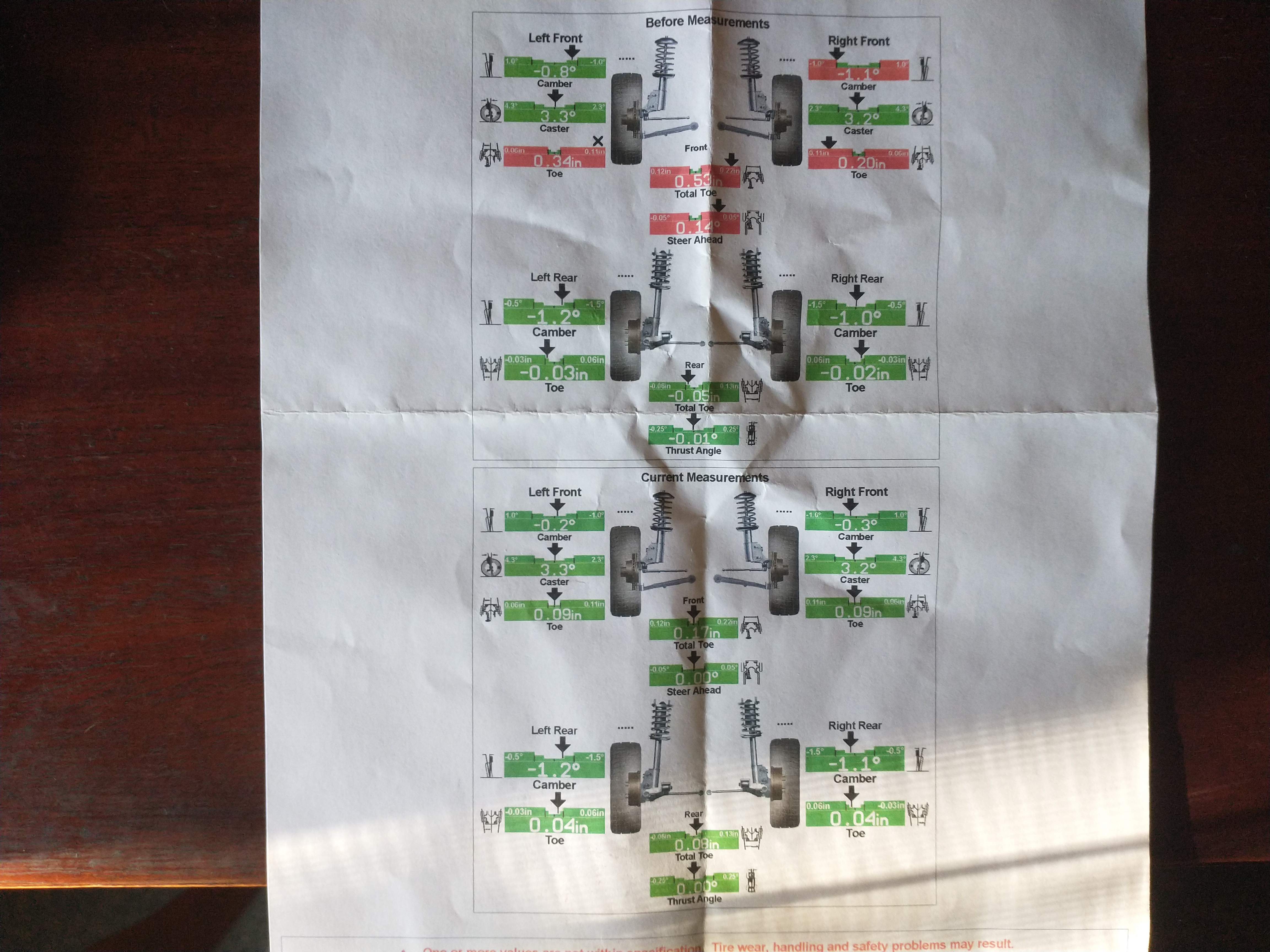

I had mine aligned about a month ago and the rear had to be moved a little bit to get it right. As misha said the tech had the car on the rack with laser pickups mounted on all 4 wheels. Then he loosened the bolts on the trailing arms, or what ever they are called, and used a pry tool to shift things over a smudge toward the drivers side. Car tracks perfectly.

Sveedy wrote: 02 Aug 2021, 08:13 I had mine aligned about a month ago and the rear had to be moved a little bit to get it right. As misha said the tech had the car on the rack with laser pickups mounted on all 4 wheels. Then he loosened the bolts on the trailing arms, or what ever they are called, and used a pry tool to shift things over a smudge toward the drivers side. Car tracks perfectly.
According to this data...i don't see you had a problem at rear.

He said that it could be better than it was, so he adjusted it some. He was very " anal " about the whole thing. Let me watch the whole time, explaining what he was doing. He had numbers that were exact that he was trying to hit, as opposed to just getting things in the green zone.
