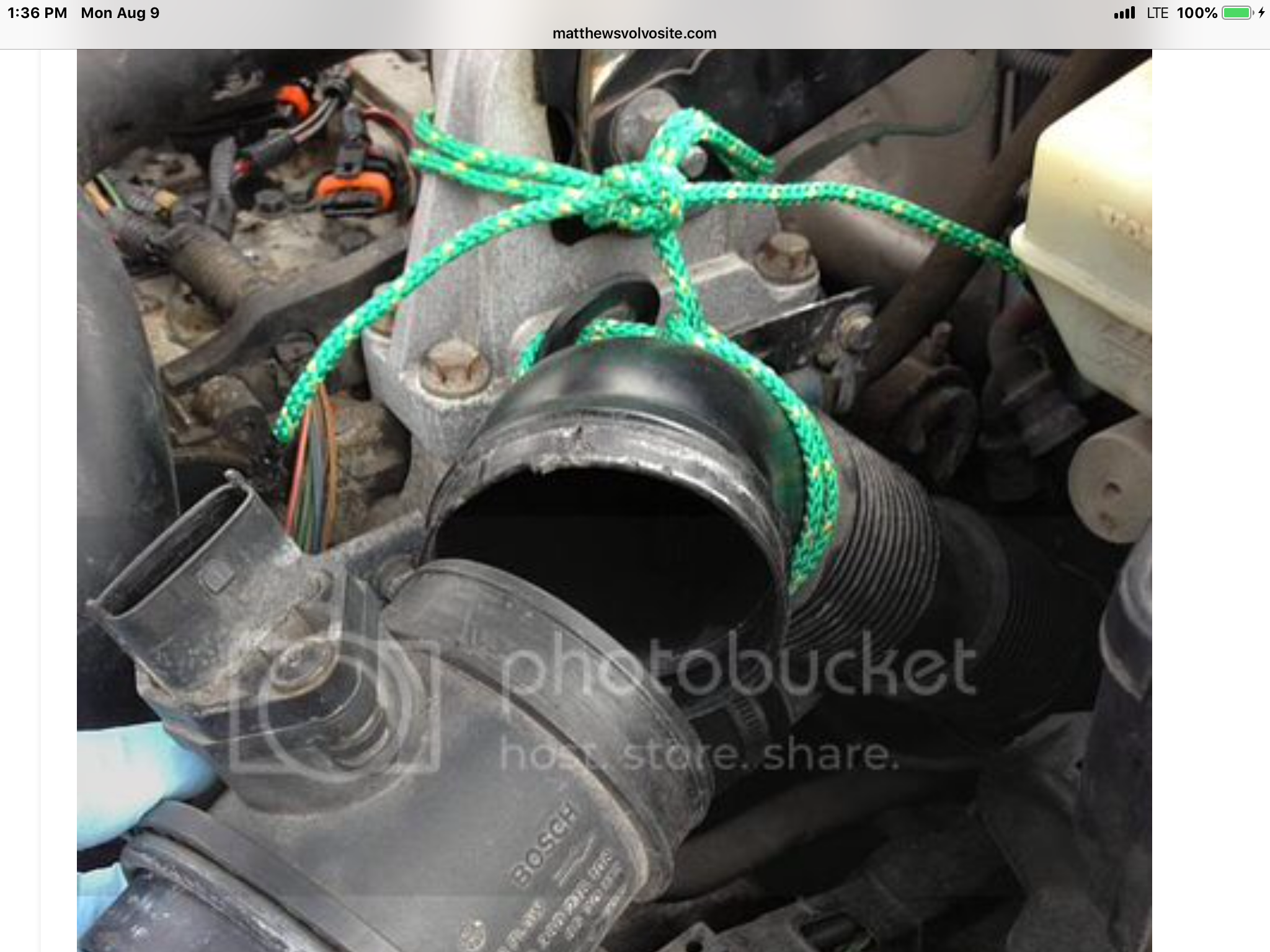

Use stiff cord to tie the snorkel to the motor mount, then use the air box to pry the MAF snout out

The snorkel piece will pull off of the turbo - you just have to loosen the hose clamp till it spins, and then pull hard, wiggling it as yo do.
The MAF likewise will pull free. Just takes a lot of pulling to get it free. I know its weird how it will spin freely but won't come apart, but it will. Tying it off to the top torque mount as abscate suggests will make it easier, so you'll have both hands to pull.

Found that picture in a 2013 thread!

The first time I had this issue, I used a large flat blade screwdriver wedged in the gap, and some redirected anger. It Was going to yield. Once I pried it apart enough that one spot was over the edge of the retaining ring, the rest of it crept over in a circular fashion. When it finally gives, be careful you don't crash into something sharp. You could get a contusion.

Wow, that photo submitted by abscate sums up pretty well the measures you need to take to separate the MAF from the snorkel. I'll remember this when, and if, I have to replace the MAF. Yes, foggydogg, I can imagine the consequences should one not take precautions doing when doing this.
