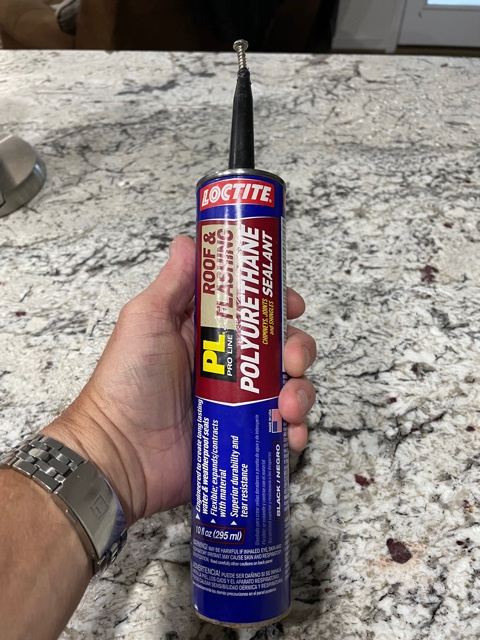

I’m sure the previous owner removed the fuse to disable it if it’s broken, mine was. I ran a bead of this black polyurethane sealant around my sunroof in between the gasket and the body of the car. Cleaned it up and it looked great. More importantly it didn’t leak while I was coming up with a game plan to fix. The sealant just peels right off later so it was easy to reverse. There is another product that I’ve used called 3M Windo-weld. It’s more expensive though.

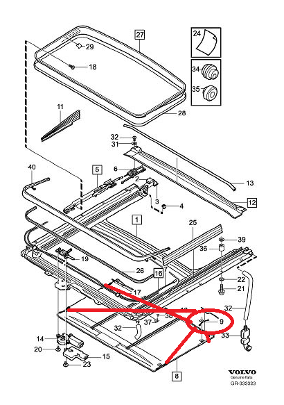

MDK here.. ok boys and girls. Sunroof by day.. moonroof by night. sunroofs don't leak. or I should say they don't seal . there are 4 drain tubes at the 4 corners of the panel
the glass sits in what is called a tub.. these tubes get clogged over time and need to be blown out with air orr whatever you can come up with. as far as not opening.. I would check a relay or perhaps the switch itself.. in all my experience I've never had to replace a motor... I did replace the sunroof on my 1998 XC70 because the glass literally flew out of the track going down the highway.. I had it in venting mode... tipped up.
