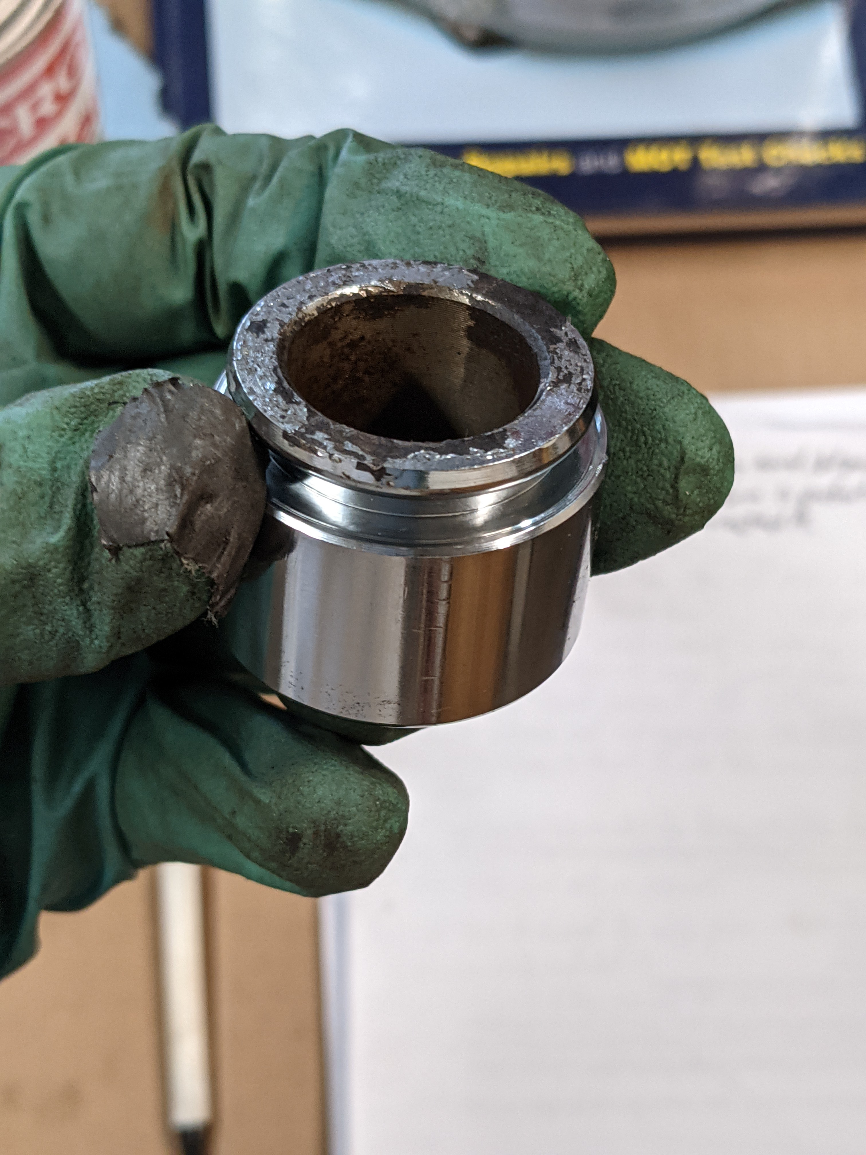

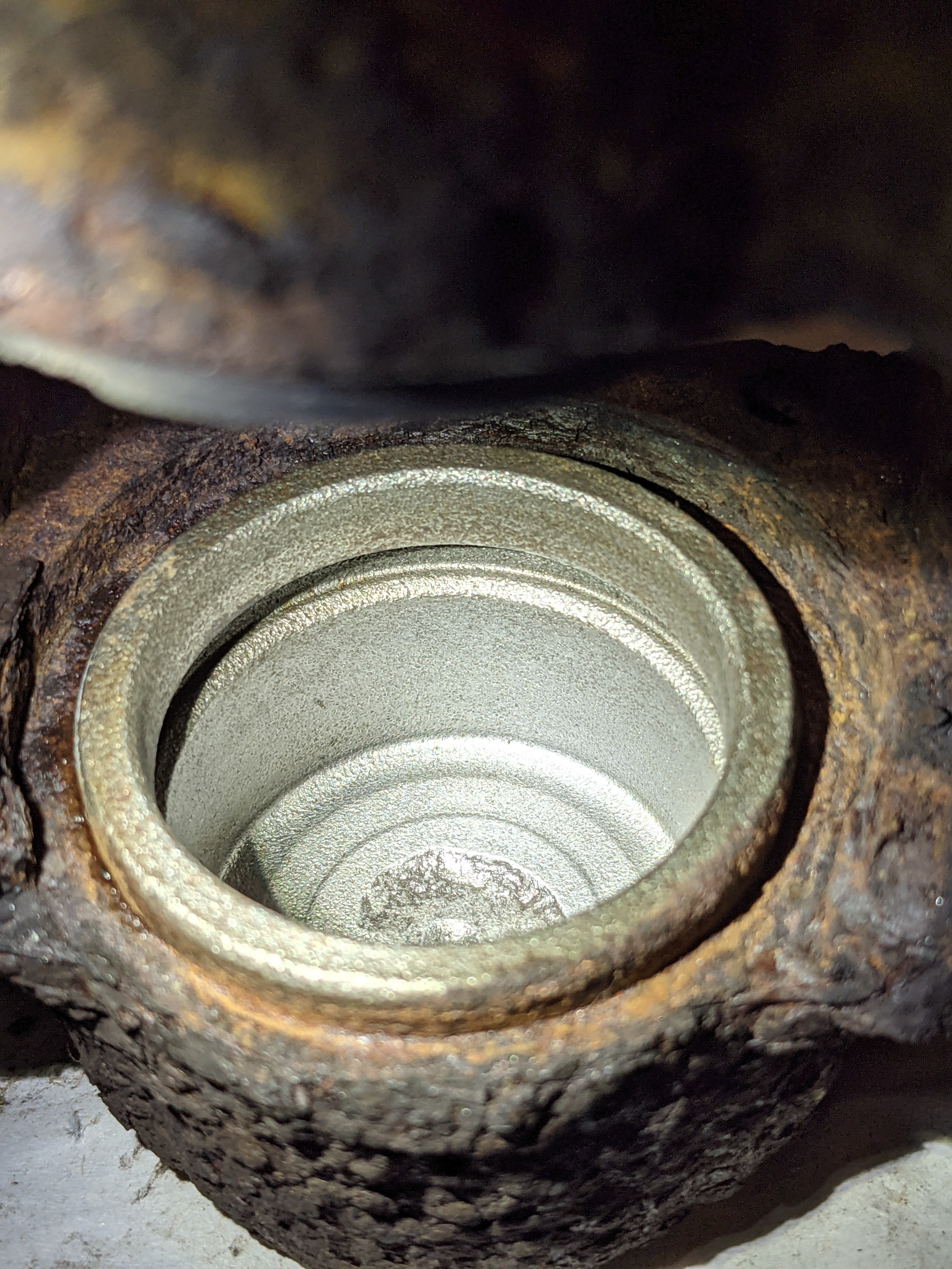

For reference, do the inside of these rusty calipers look good? The piston had a few slight nicks and the photo seems to show pitting, but I didn't see it in person.
It's odd that the piston faces are flat and don't have the 40% cut out section like the new ones. Are these original calipers, or maybe cheap rebuilds?
