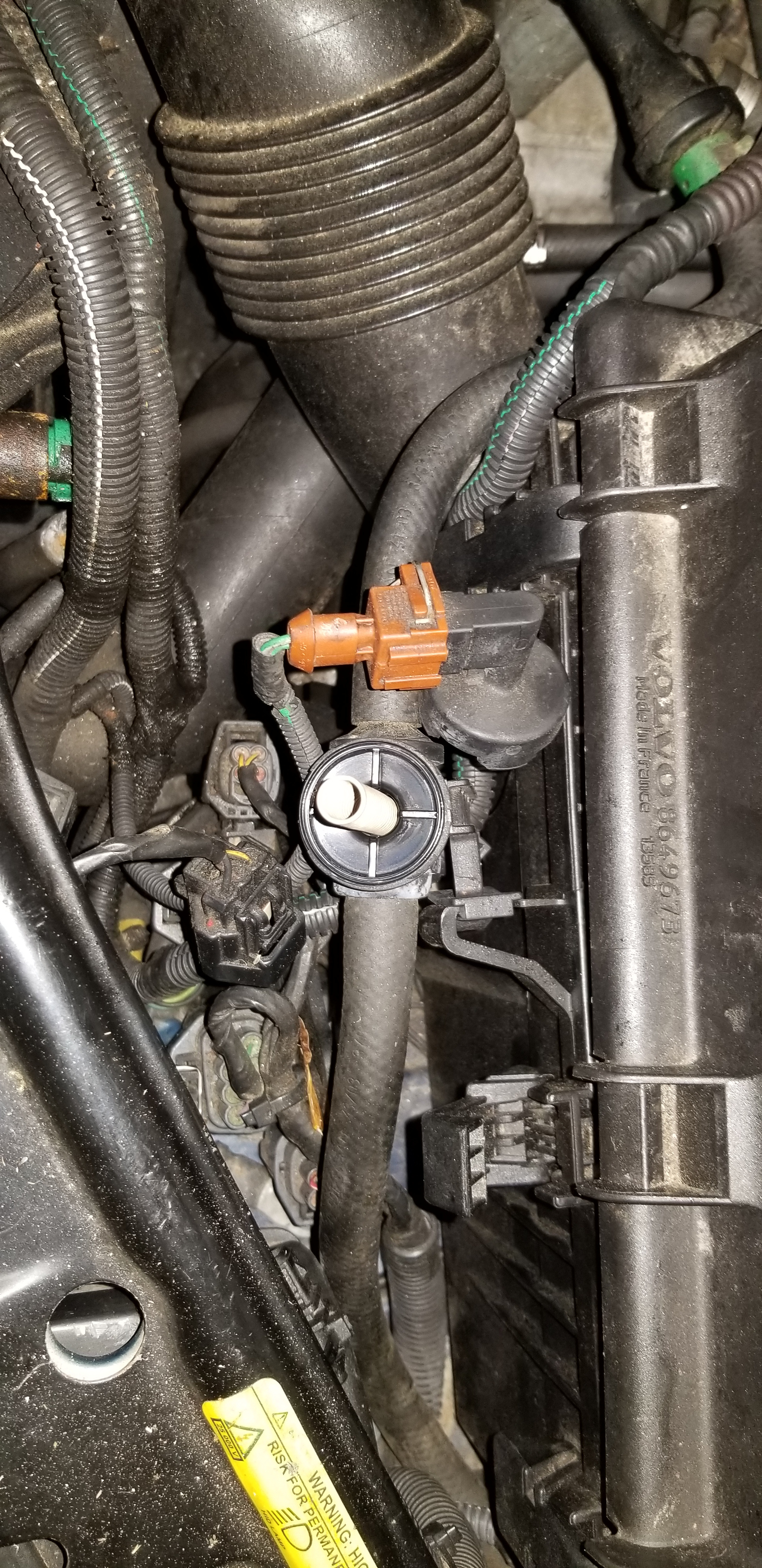

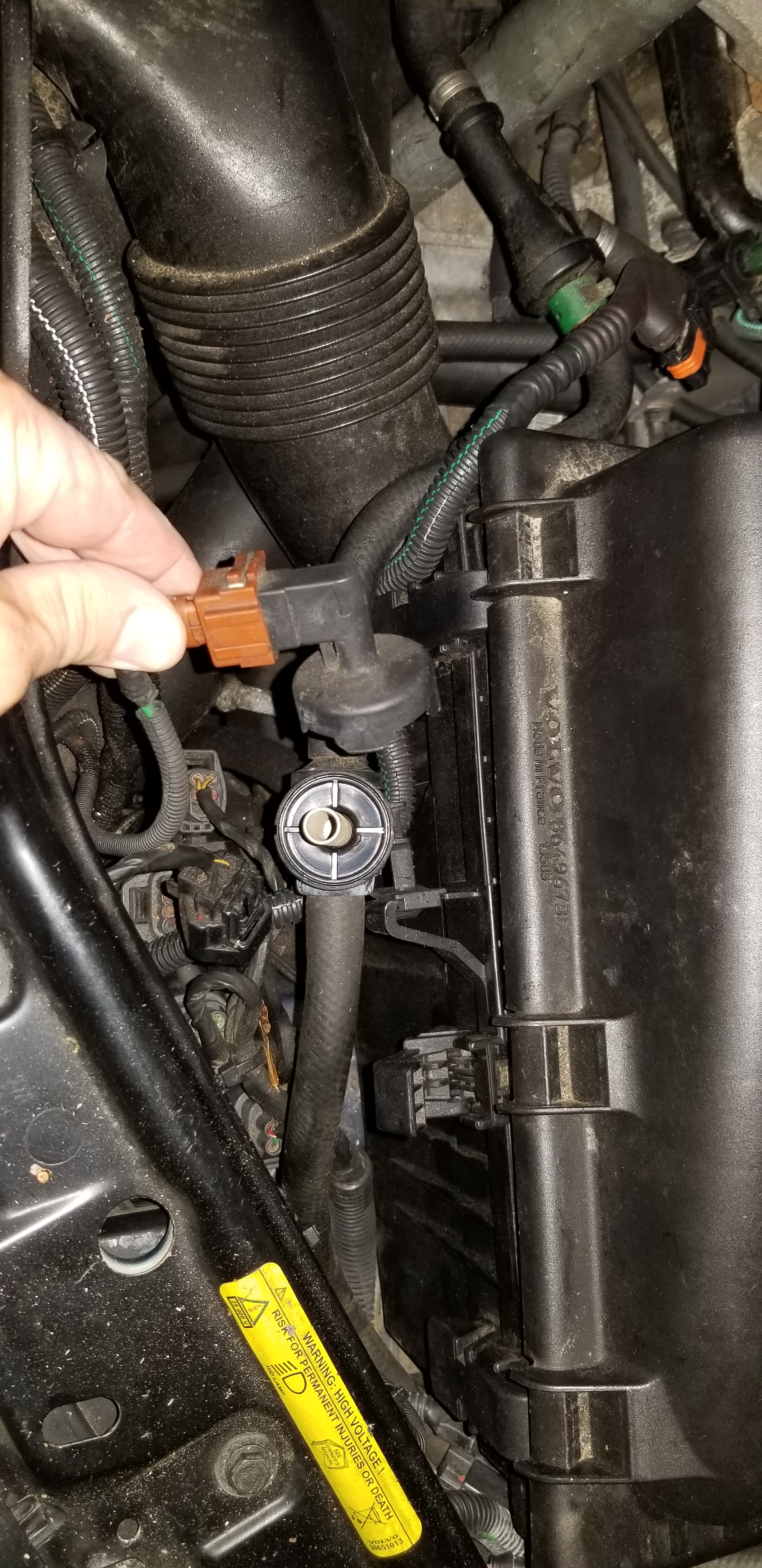

In front of the airbox on my 04 Volvo xc70. It is like a valve for some kind of air recirc pump. Not exactly sure, but it broke apart as you can see in the pic

- Volvo PN 31400692, about $60-$70.
Use only Volvo part. Avoid the aftermarket junks.

How many miles on your 2004 XC70?
Most consider:
1. Replacing this part for sure.
2. Lubricate the vacuum pump itself. I wrote it up somewhere in forum.

Brake vacuum sensor. You can glue it back together with a zip tie around it, too. The new part is improved and doesn’t break ( brake?) like the OE.

JB plastic weld works great

Gorilla glue and zip ties did the trick
Thanks for all the help.

Make sure your vacuum pump isn’t on full time after that repair. That will burn it out and it isn’t cheap.
