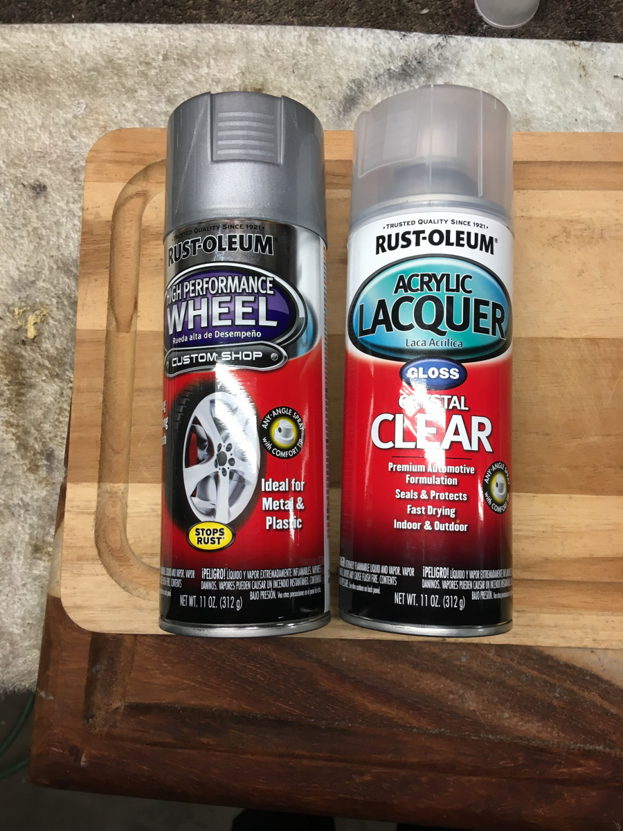

I would use the paint pictured below (in fact, I am/have!).
Put it on over Rustoleum self-etching primer and the color will be better and with fewer coats. Then clear coat with the pictured cc.

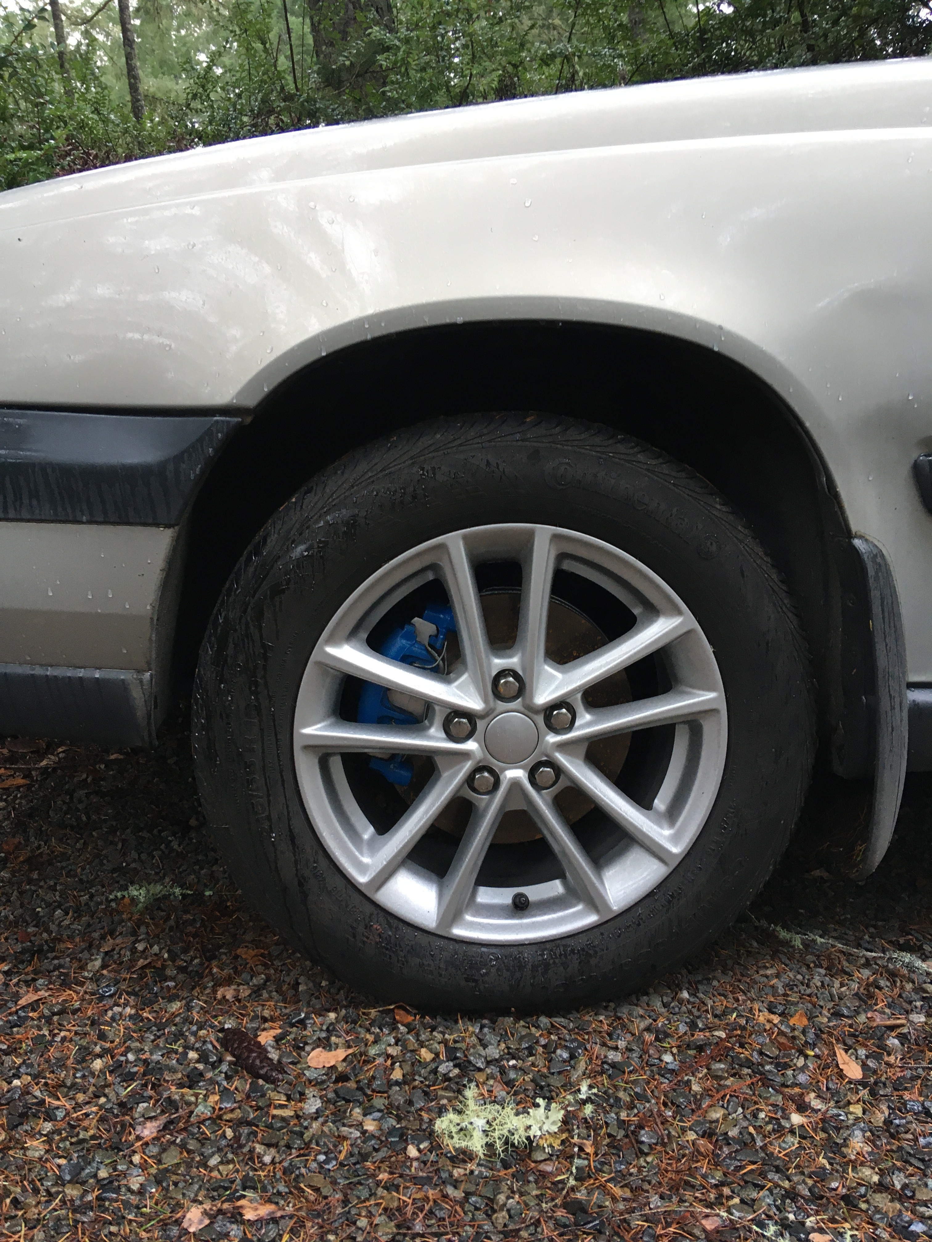

The color is close enough the bright silver you cannot tell front-to-back. The 2nd picture is a wheel where I had to refinish the center cap. Wheel is factory color (it is Ford bright silver, but the same as Volvo). The cap is the paint above and you can't tell any difference. In fact I have a set of four Perfos I am about to refinish with that as they are going to take snows for the car pictured below. These paints are widely available and not premium prices.

Use some self-etching primer under these and you'll be happy I think: The wheel is factory paint, the center cap is the primer/rustoleum silver wheel/rustoleum clear coat:
