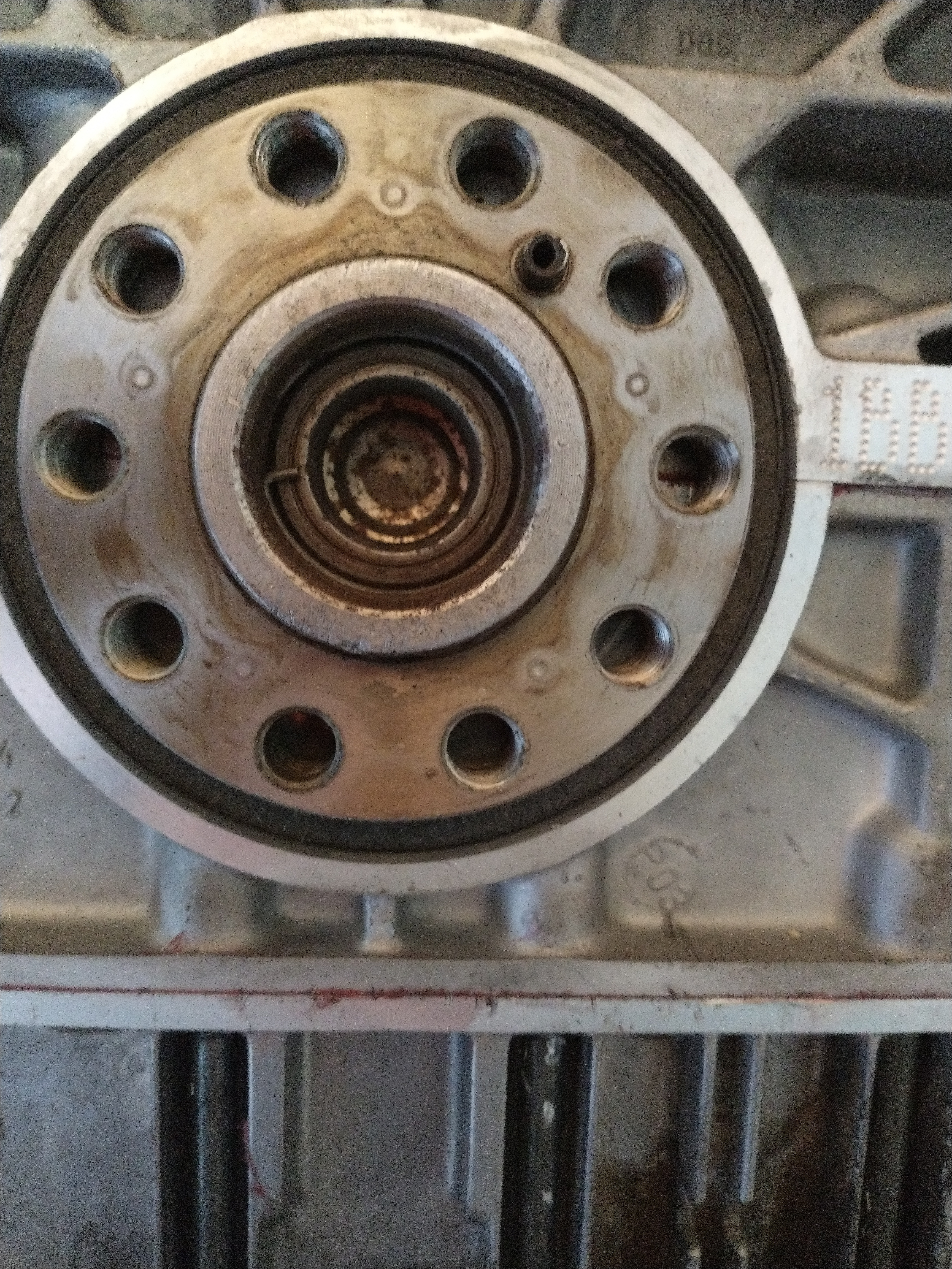

In this picture you can see through a bolt hole, the seam / sealant between the upper and intermediate sections of the block.
So that area should not have any oil in it. And there's the hollow split positioning post between those bolts which would allow oil to freely pass through ( passed a wire through it to check depth ), so then why seal the bolts on either side of it ?
I'm leaning toward loctight, not sealer. I'm guessing that the factory stuff does both, but they were using it for its locking aspect in this case, not sealing.

I've done this a couple times and used loctite on these bolts, basically because I have always used this thread as a guide viewtopic.php?f=1&t=28973. Those ones haven't fallen apart in about 10 years.

It could well be that the Volvo bolts have a version of locktite that activates when torqued. The stuff does have some sealing properties, but not the primary function.
Since the originals were torque-to-yield, I would be tempted to just use some reasonable torque on the old bolts.
