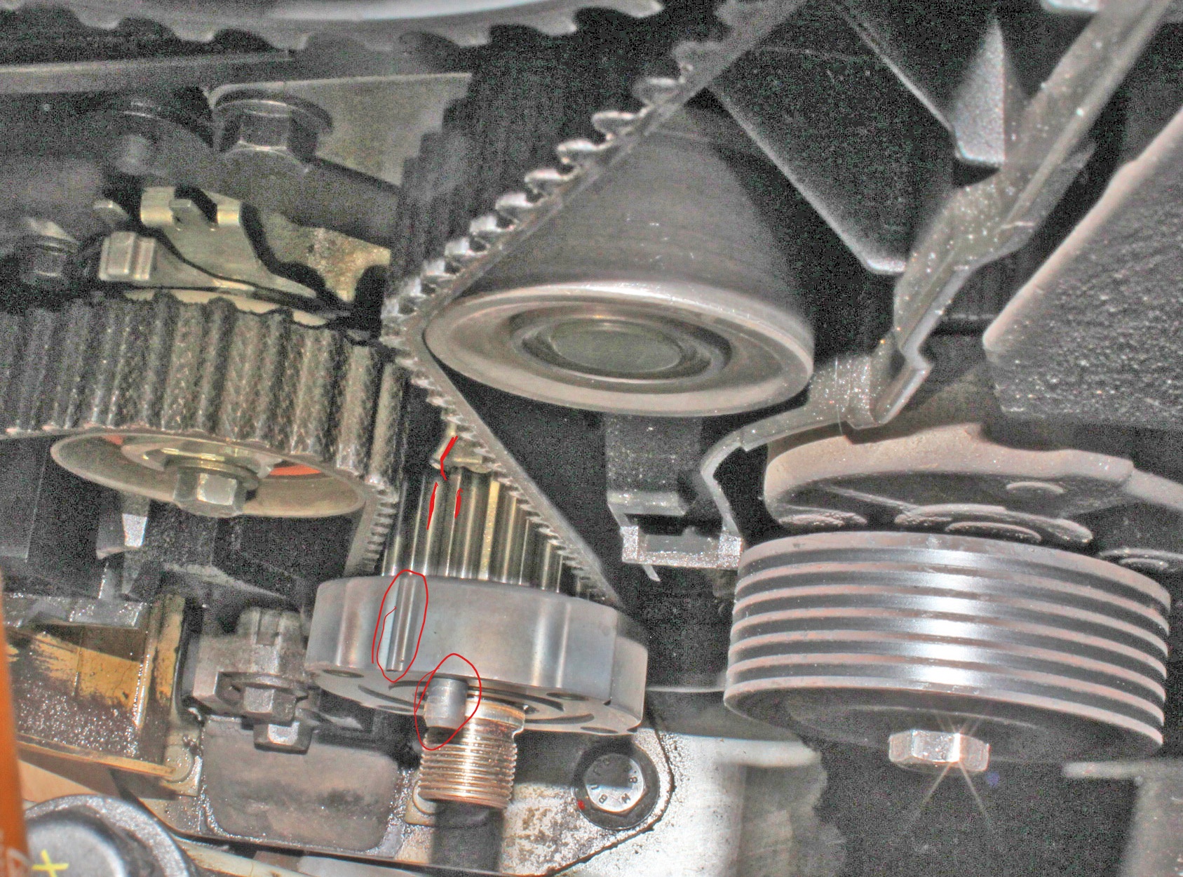

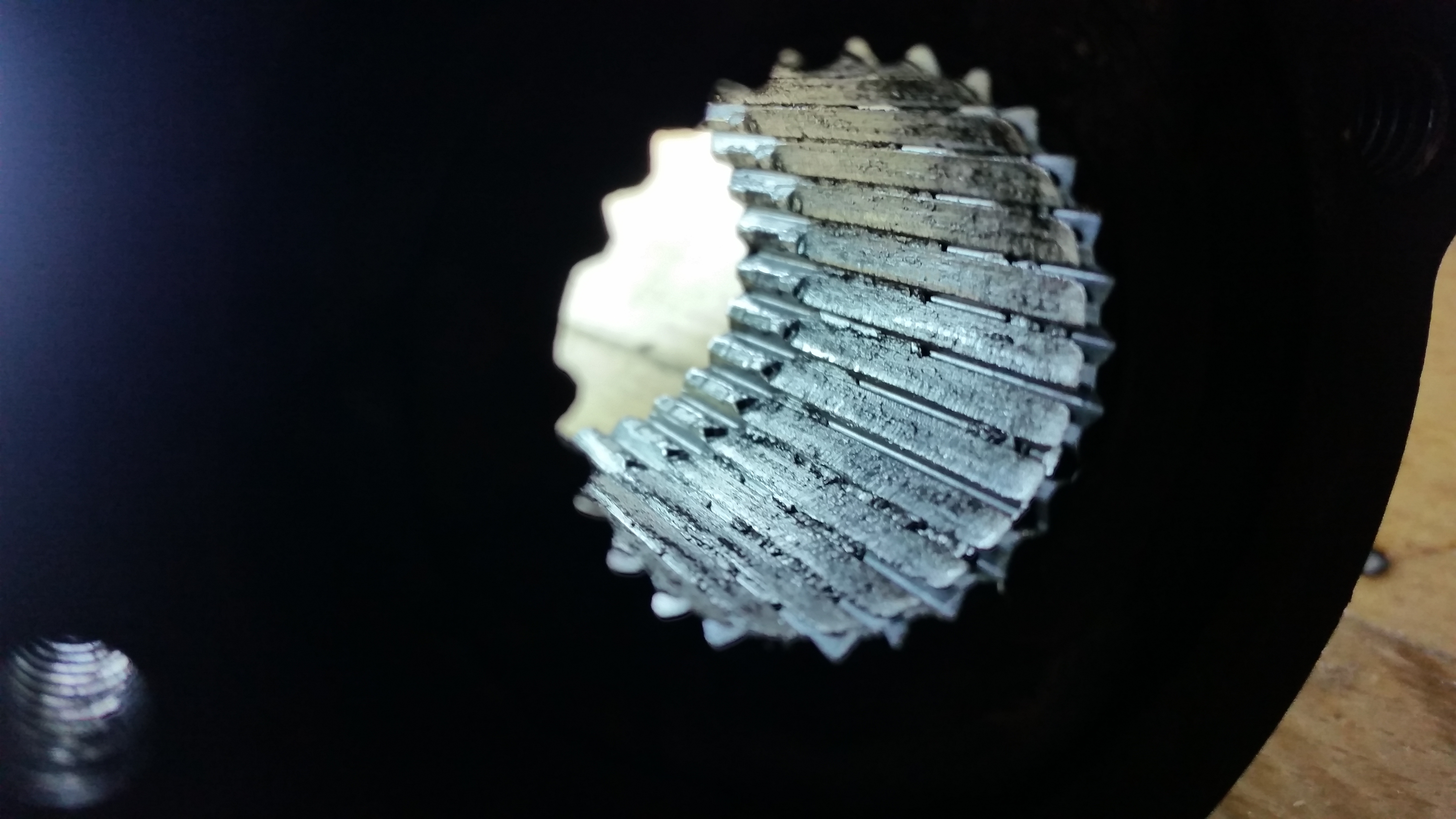

Whenever I read about these difficult timing problems I think of a person I worked with on a bent valve problem. It turned out to be the bottom timing belt pulley and stripped out splines. I don't know how often this occurs, but I've recently read about people seeing the crank pulley nut come loose or missing completely, which can't be good for the health of the pulley splines. The bent valve problem was due to completely stripped out pulley splines and I'm wondering if the difficult to time problems may be due to worn, but not completely stripped out, splines causing some movement in the pulley and a change in alignment on the crank. This is probably a long shot cause for this type of timing problem but did want to mention it as a possible problem to check out.scuby wrote: 06 Feb 2022, 02:39 I've read what seems like all the posts.
