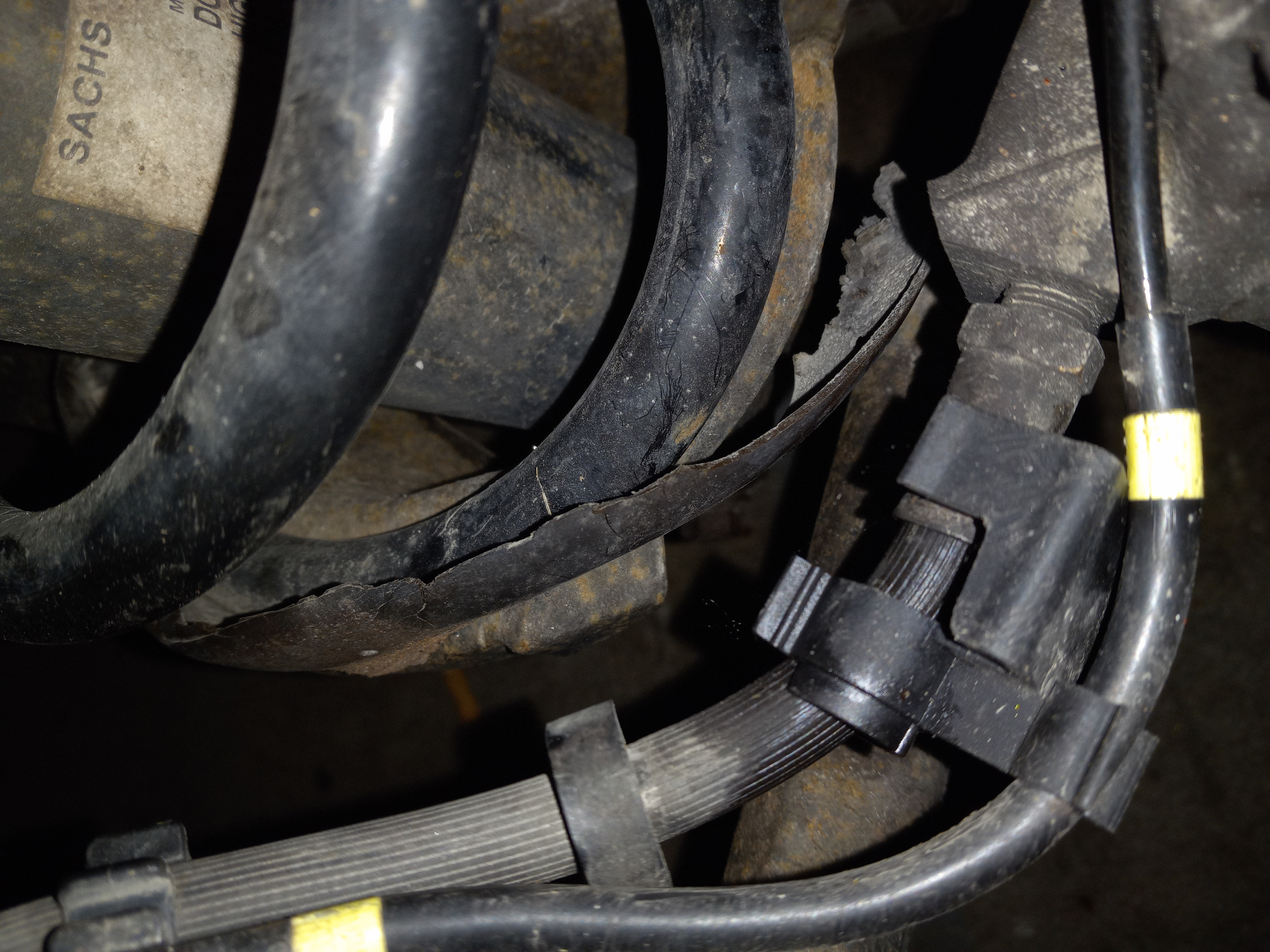

I've recently did the brakes and rotors, noise came before that. Didn't get any better or worse after. I've checked for rubbing, but I don't really know what I'm looking for. This is the first car I've had, that I've done the work myself, I'm still pretty new to it! Could this be causing it?

Not sure what you are pointing out, but the piece that is hanging from the spring is just a rubber coil isolator that looks dry rotted, cracking, and falling off. It doesn't matter if it falls off.

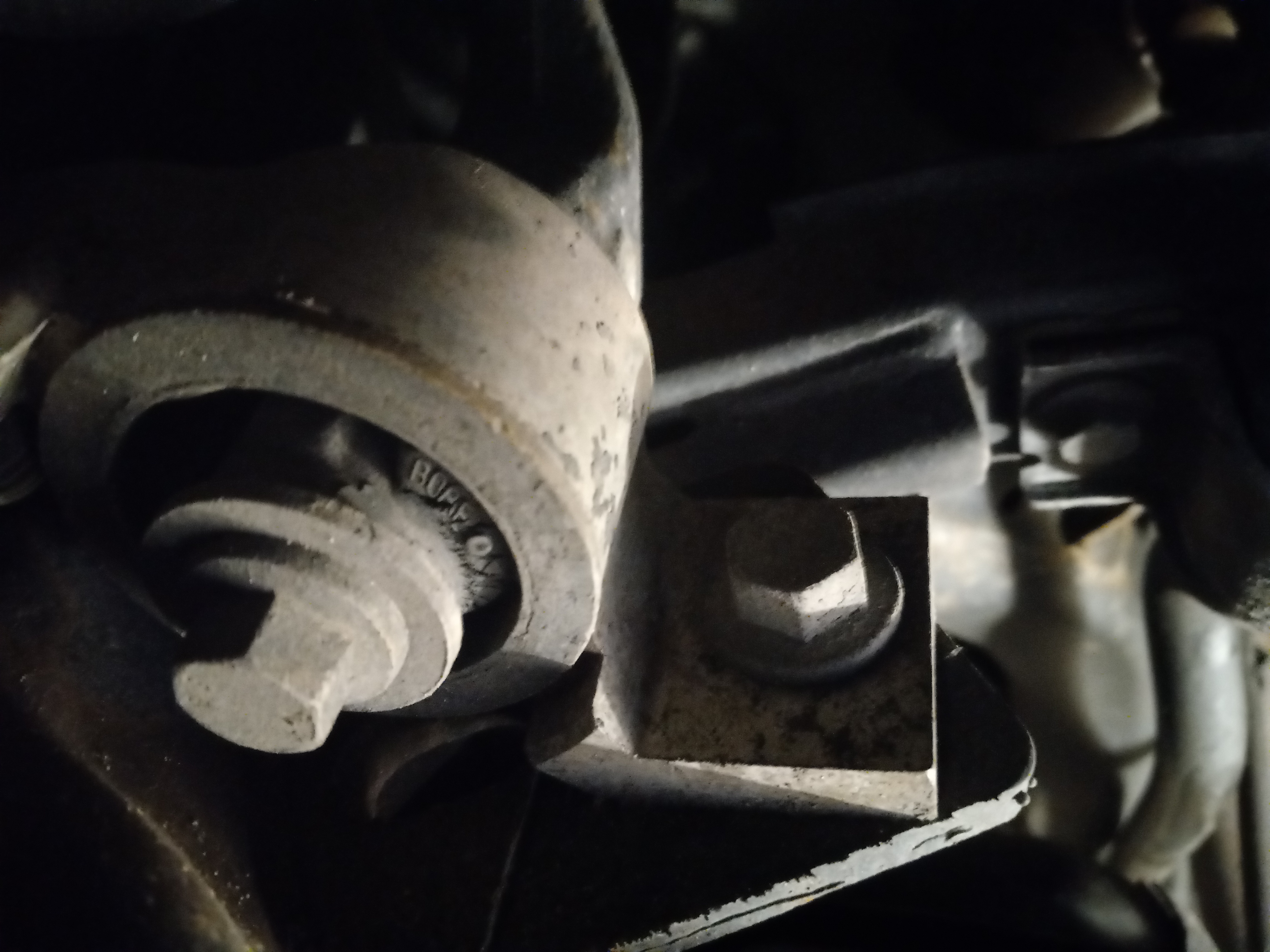

First thing you should check is if the noise is correlated to something rotating or not. Raise that corner and spin the wheel each way to see if the noise is replicable. If it is rotational, try to locate the noise without the wheel. Check the CV/axles or if the noise is coming from the parking brakes. You saw the parking brakes when you removed the rear rotors.
If it isn't related to something rotating, then check your exhaust hangers/exhaust by grabbing them and moving them if they make the clanking noise. Then check the trailing arm bushing at the subframe. The trailing arm is the only rear control arm that goes from the rear hub forward to the subframe. The other control arms go to the center of the rear subframe. You can see a thread about the rear trailing arm bushing, also called rear stay control arm bushing, here: https://www.swedespeed.com/threads/rear ... st-6298041
