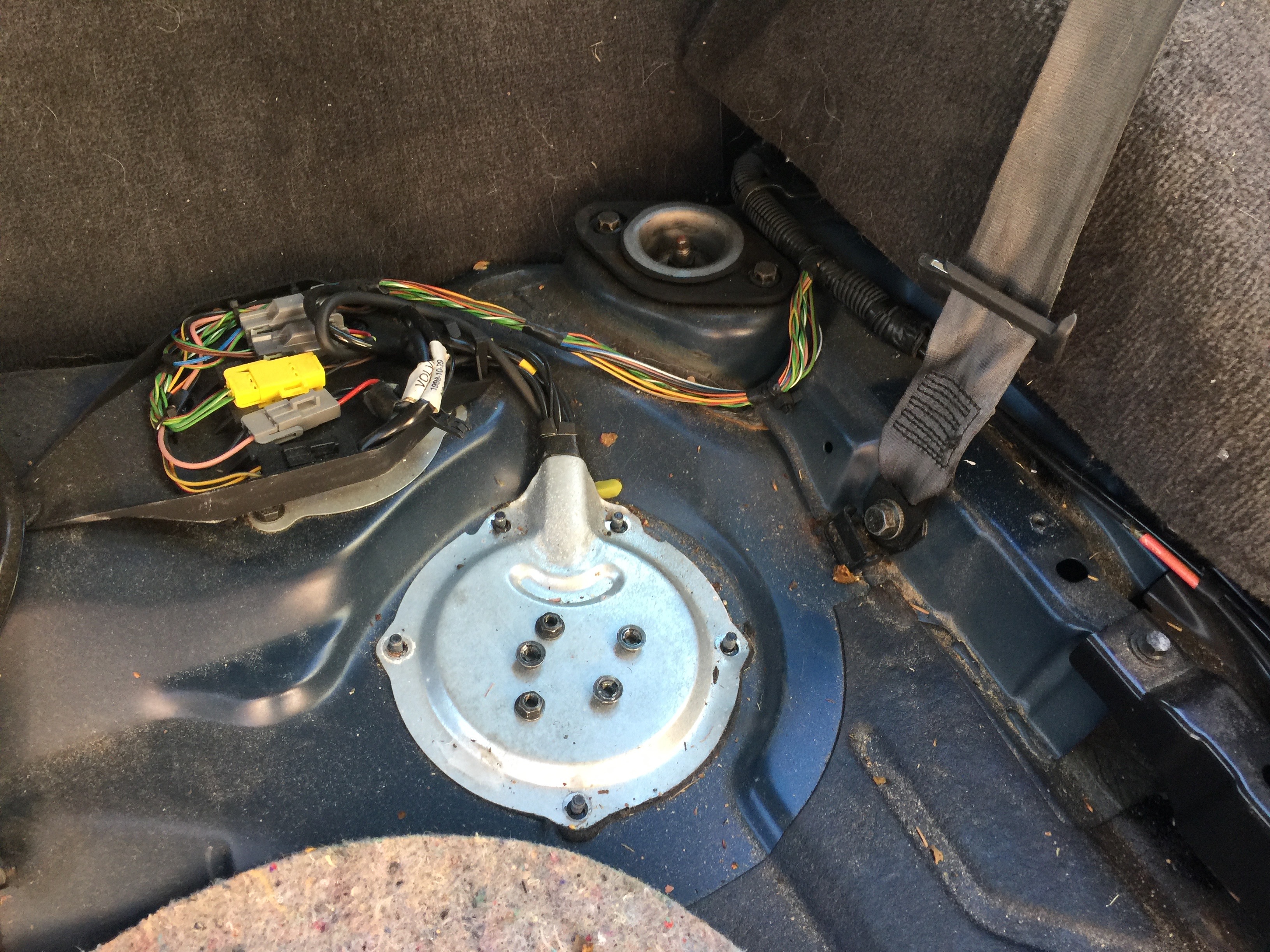

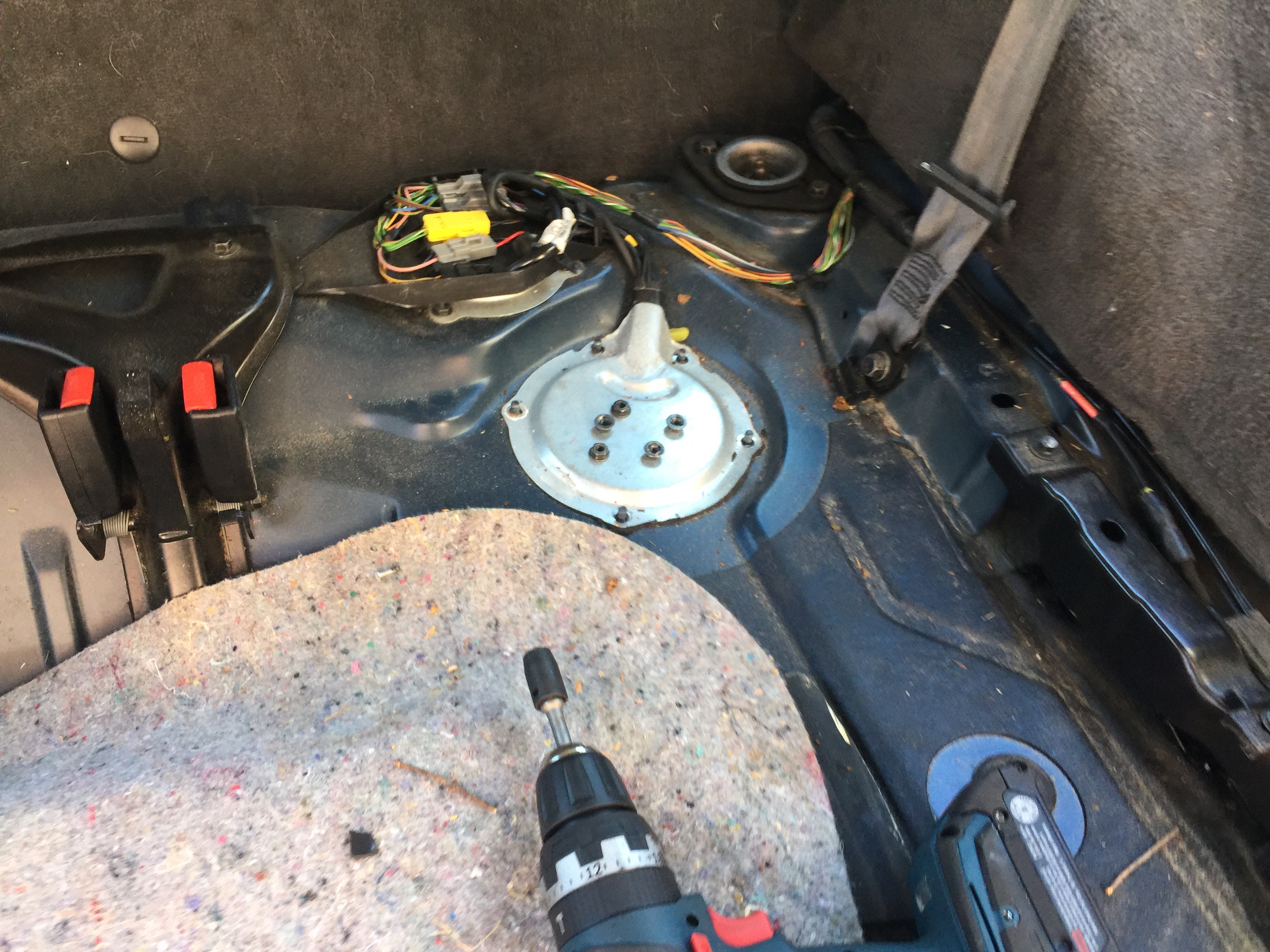

M6 Bolts to remove cover plate
Cover plate removed, yellow harness is ABS

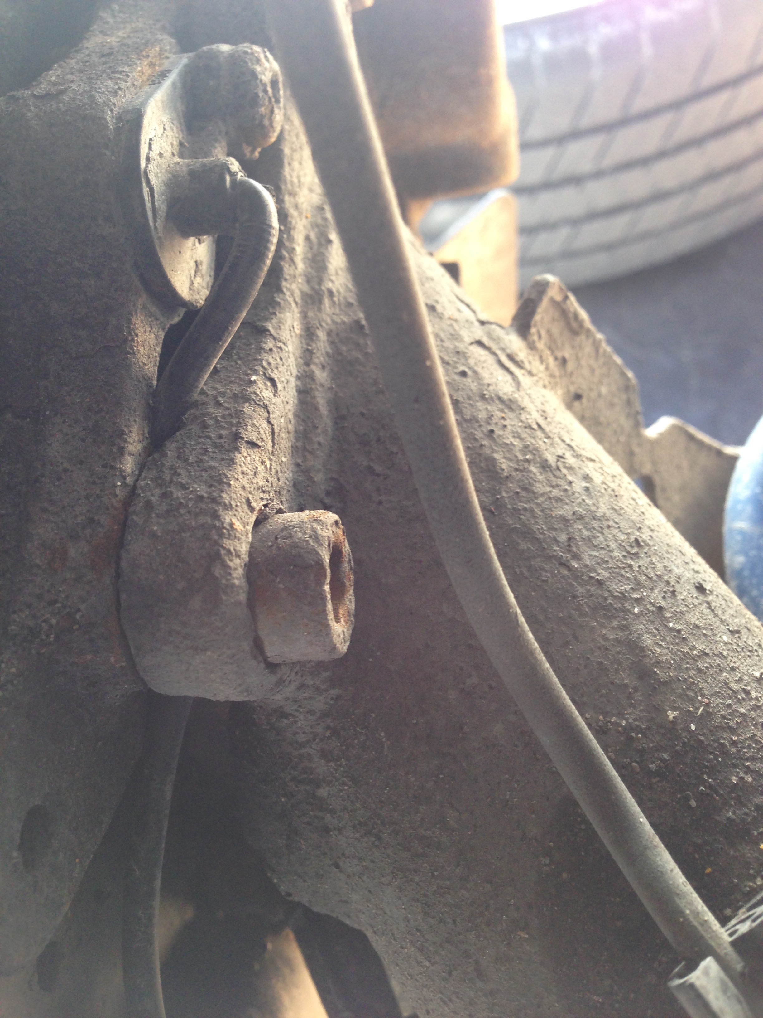

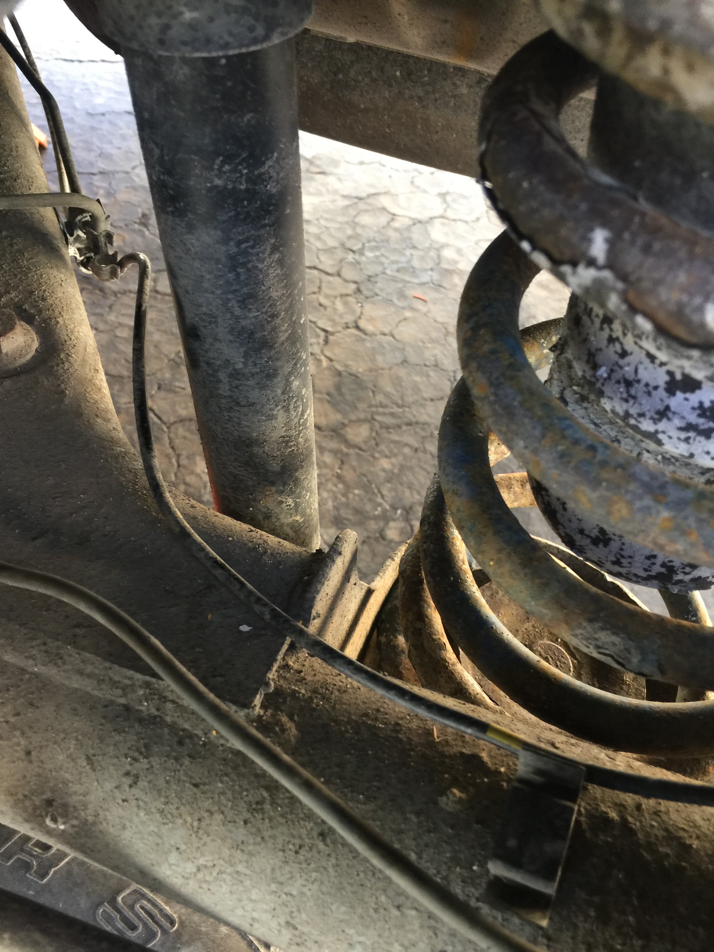

Routing left wire
Routing left wire
Wire over axle torsion beam
Routing left wire
Routing left wire

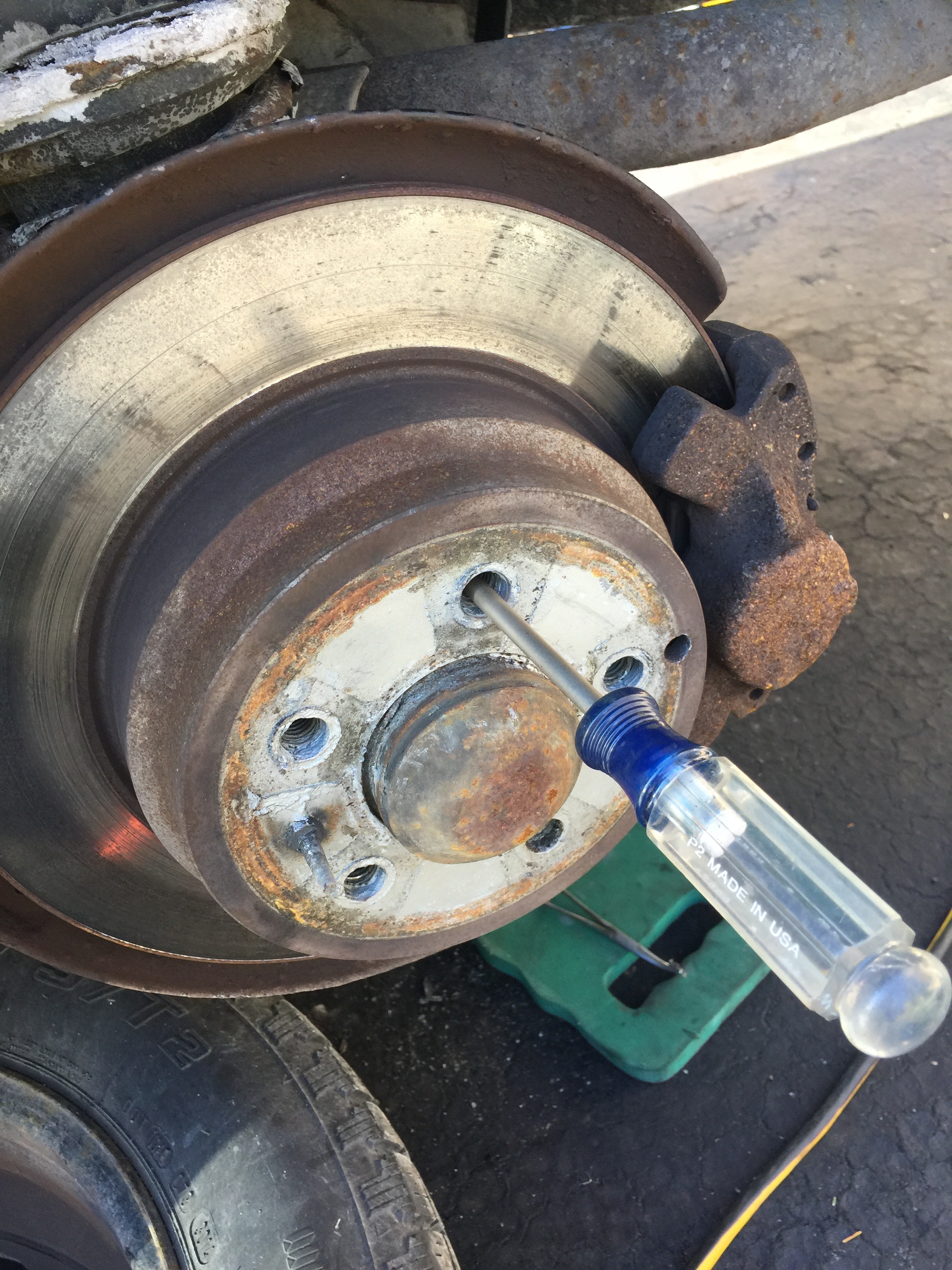

I gorilla'd one of the sensors and had to punch it out of the hole with a screwdriver

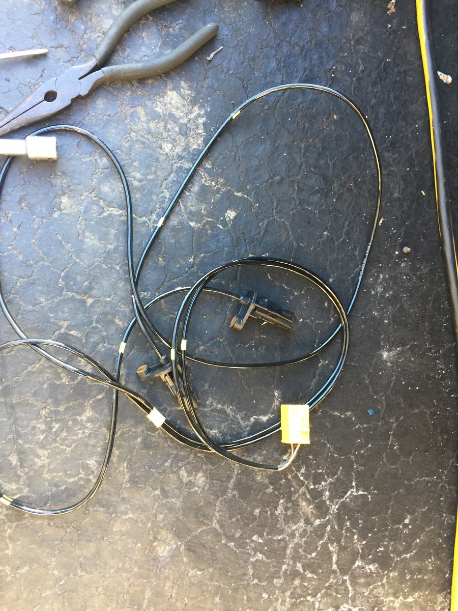

Nice new Volvo Part
Nice new Volvo Part

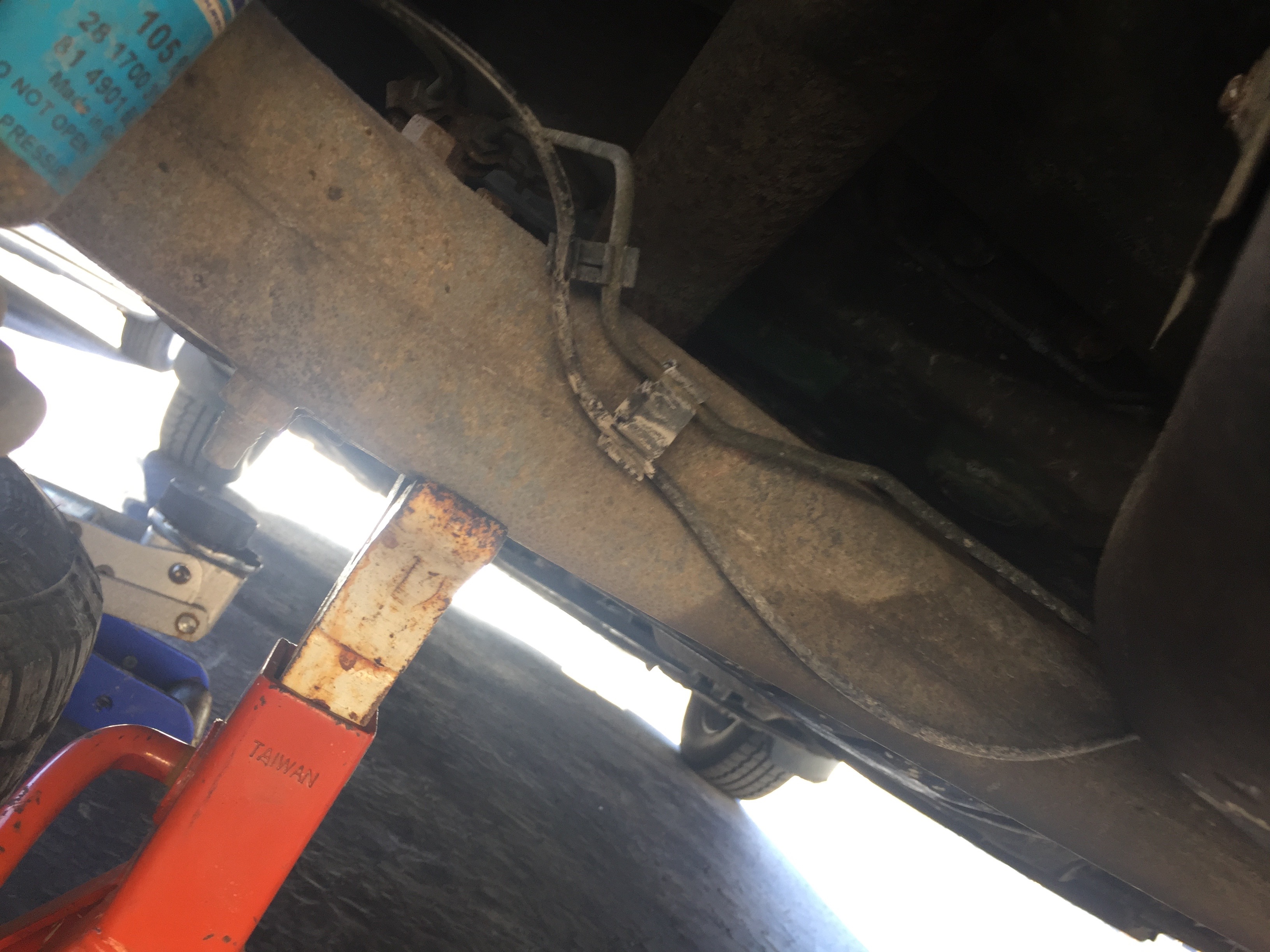

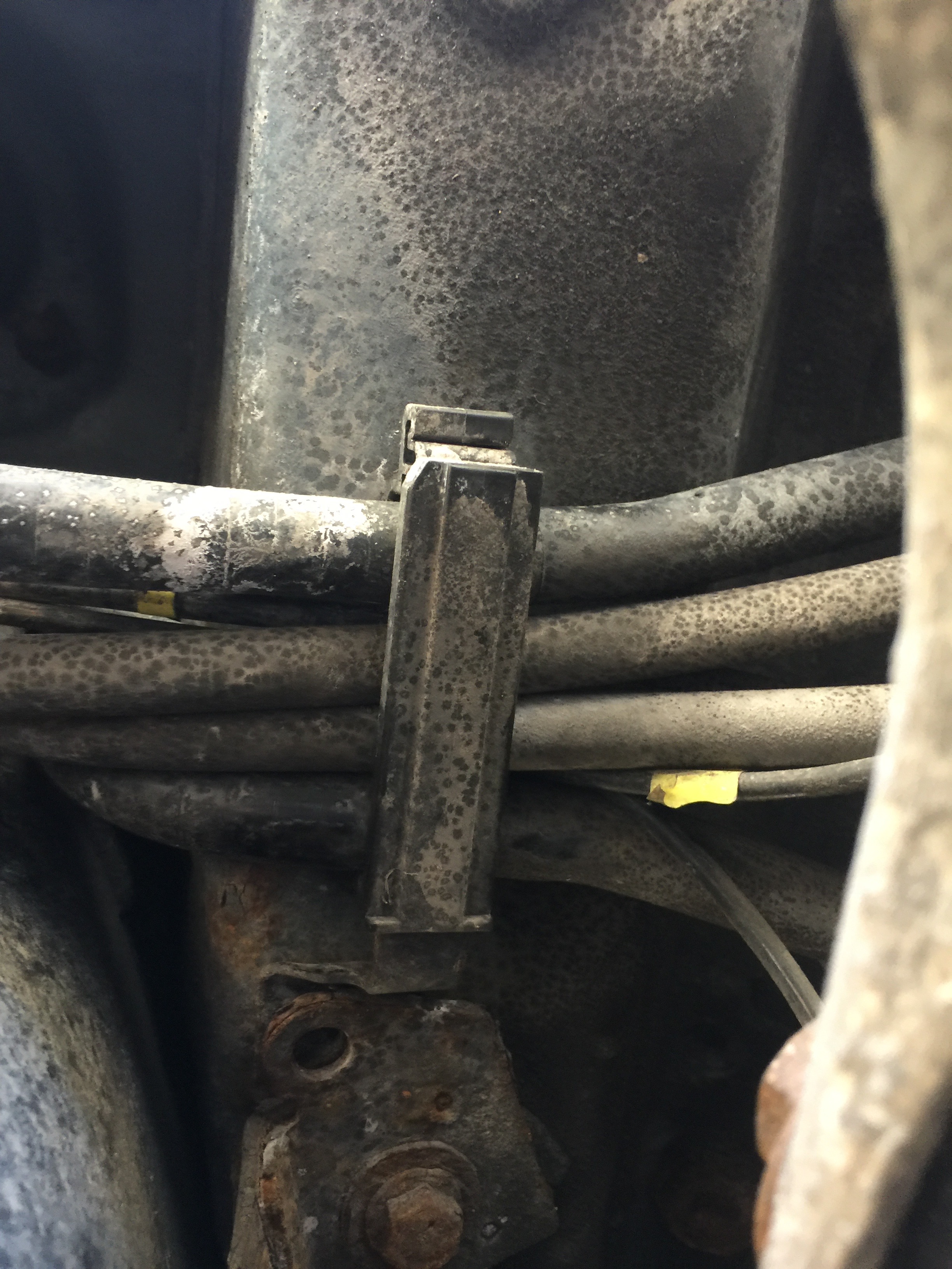

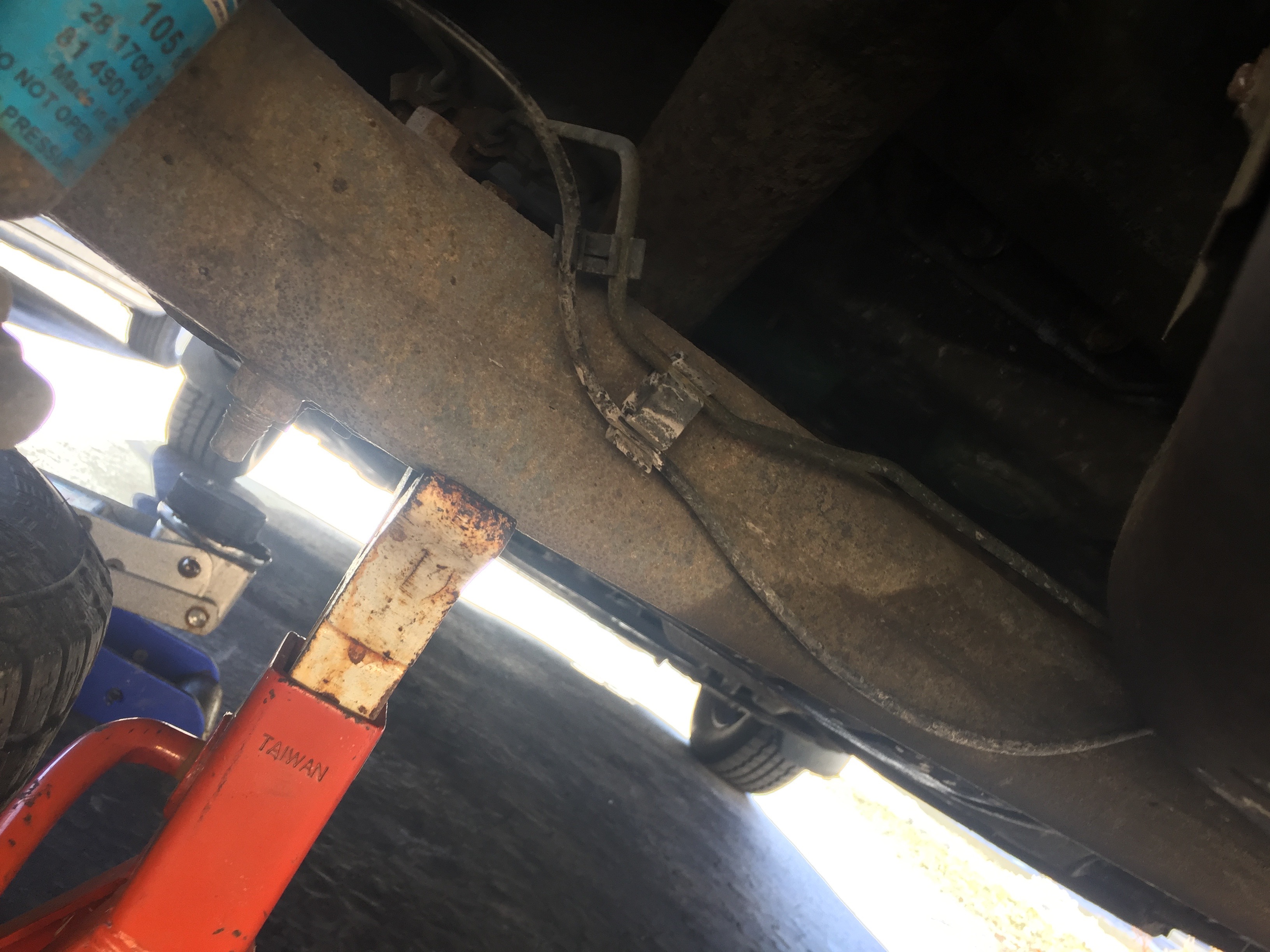

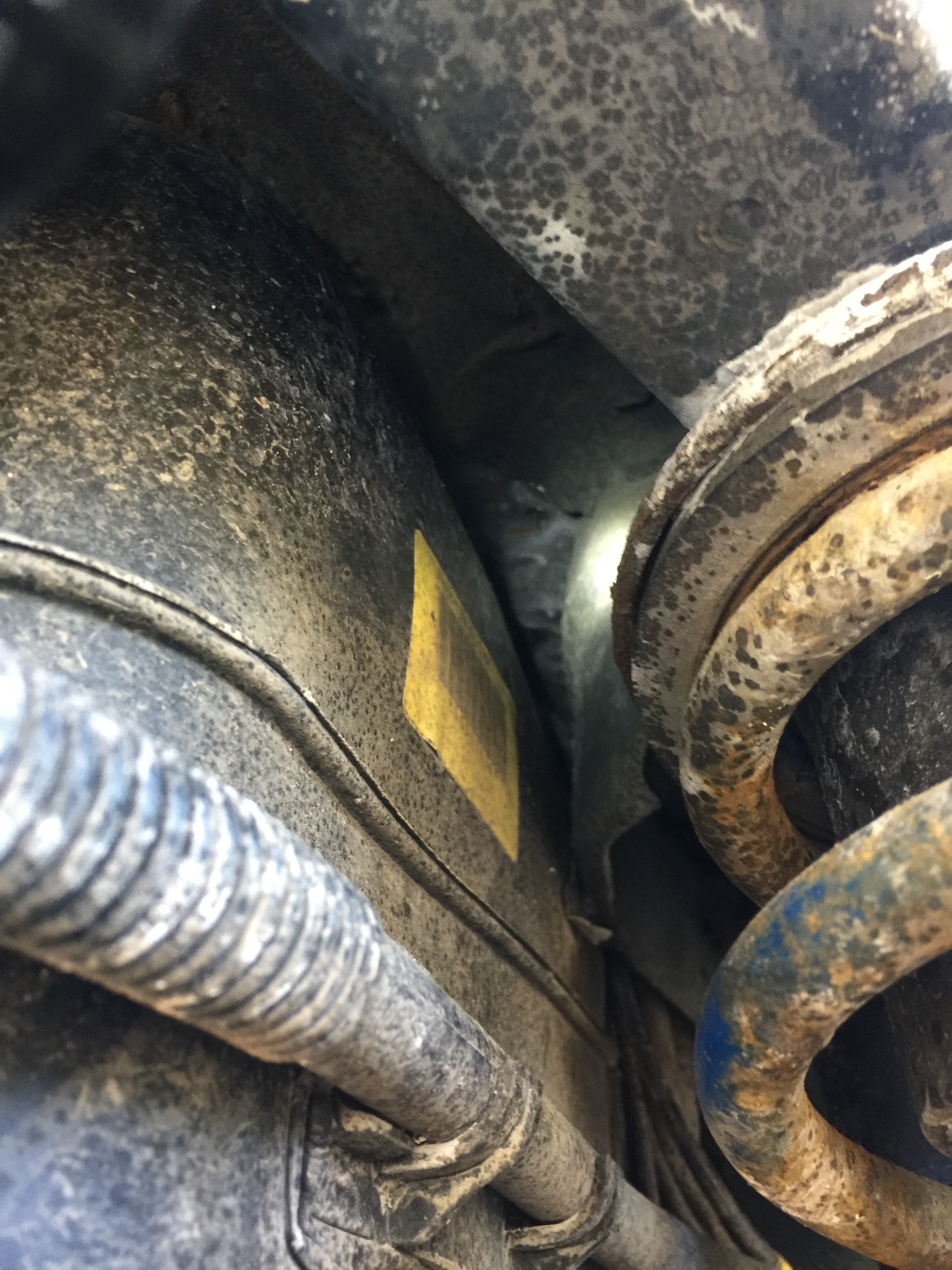

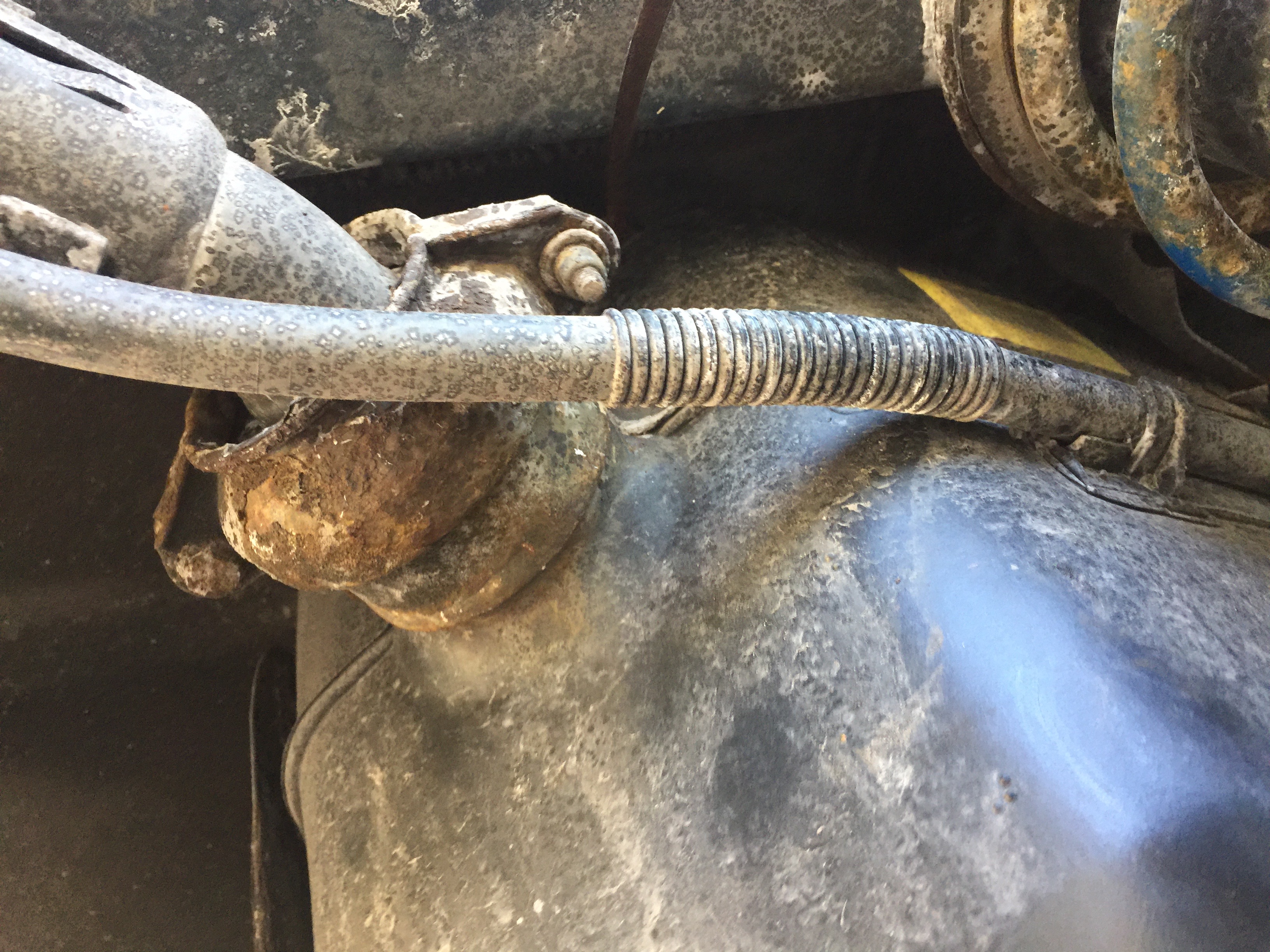

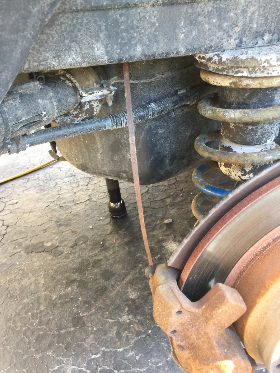

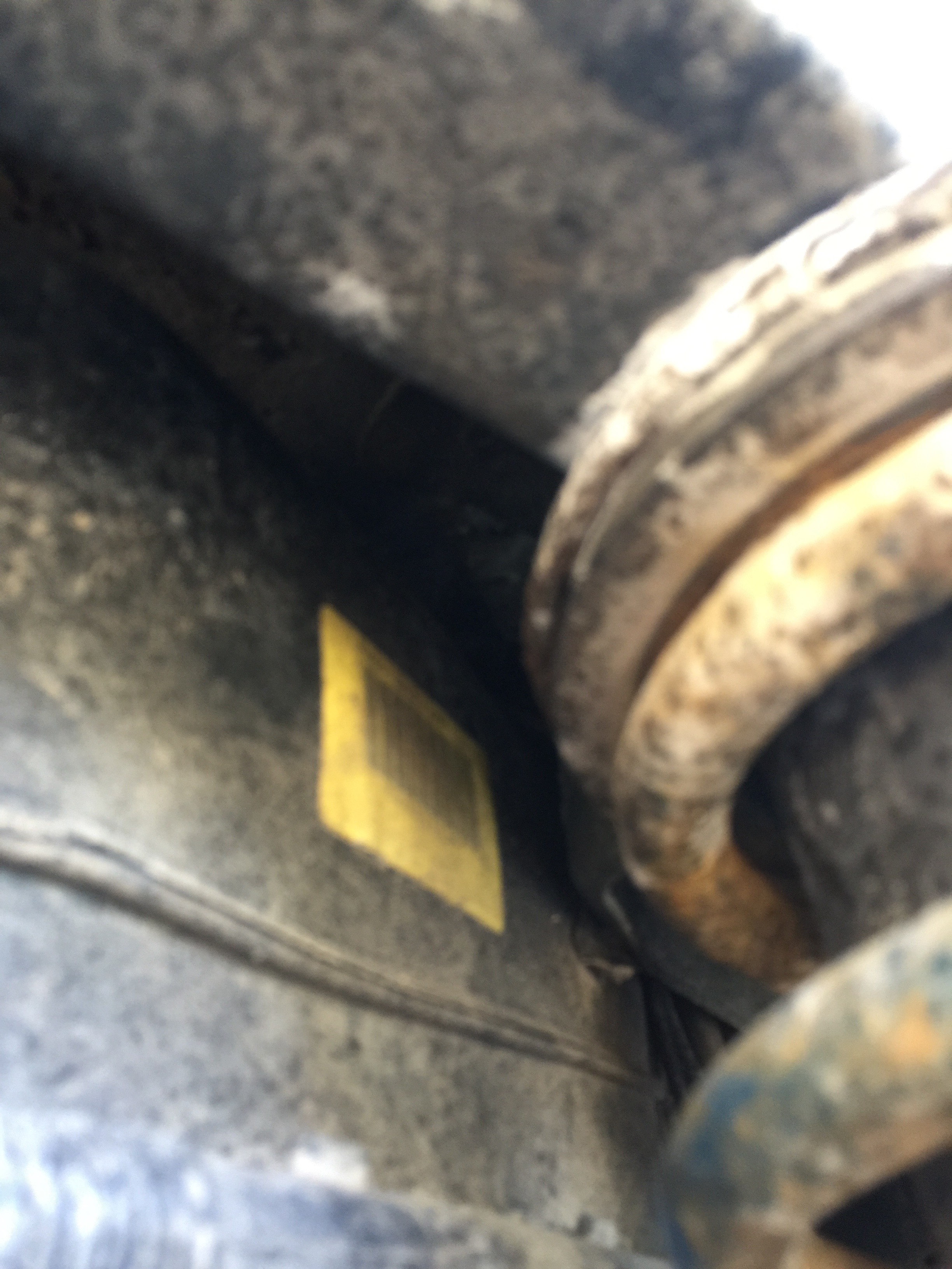

Clamp for fuel lines and wires, pass side rear

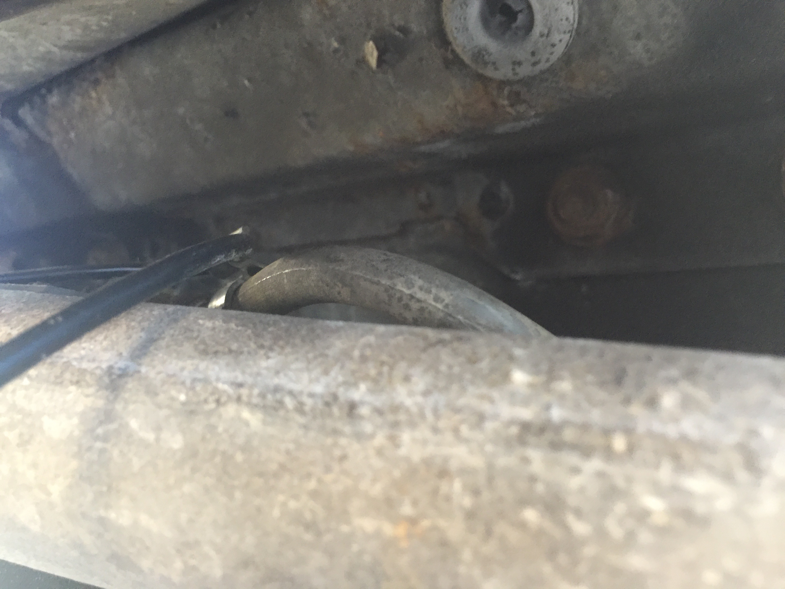

Its tight on original path but if you come aft about 15 cm you can get a fish tape up

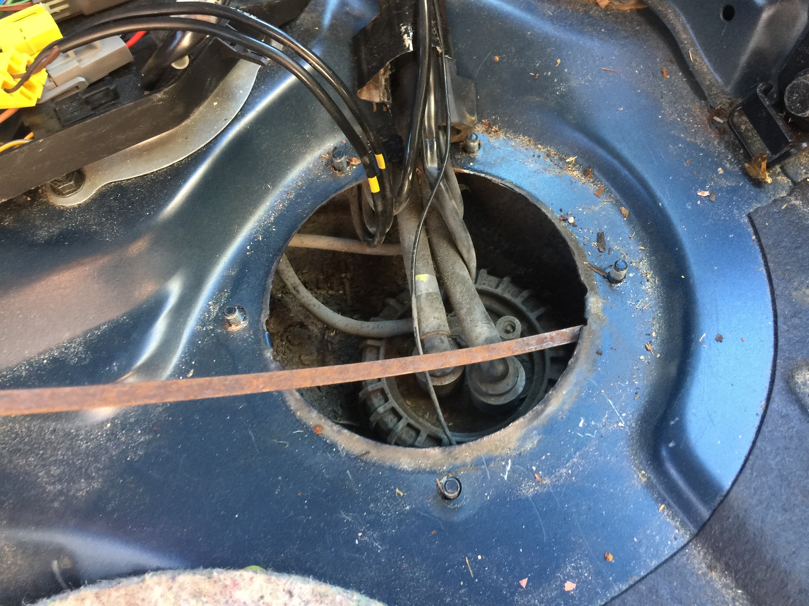

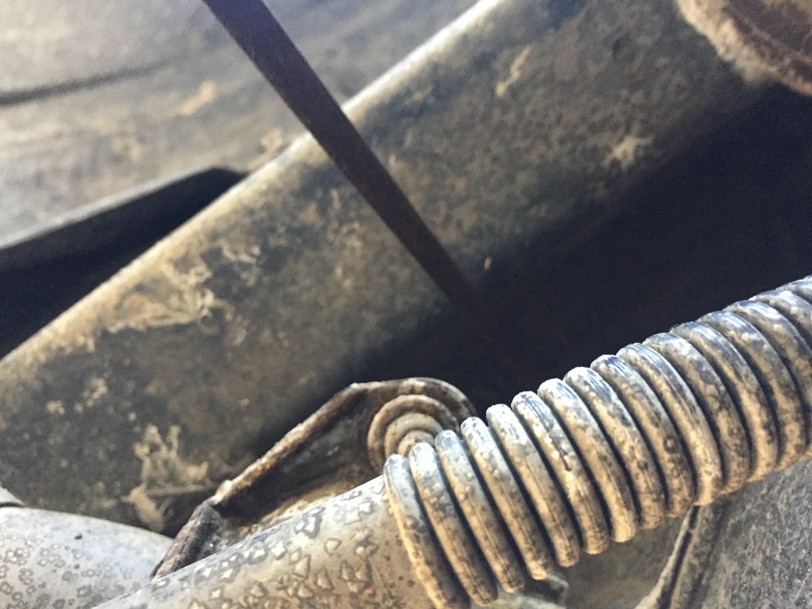

Better picture of through area

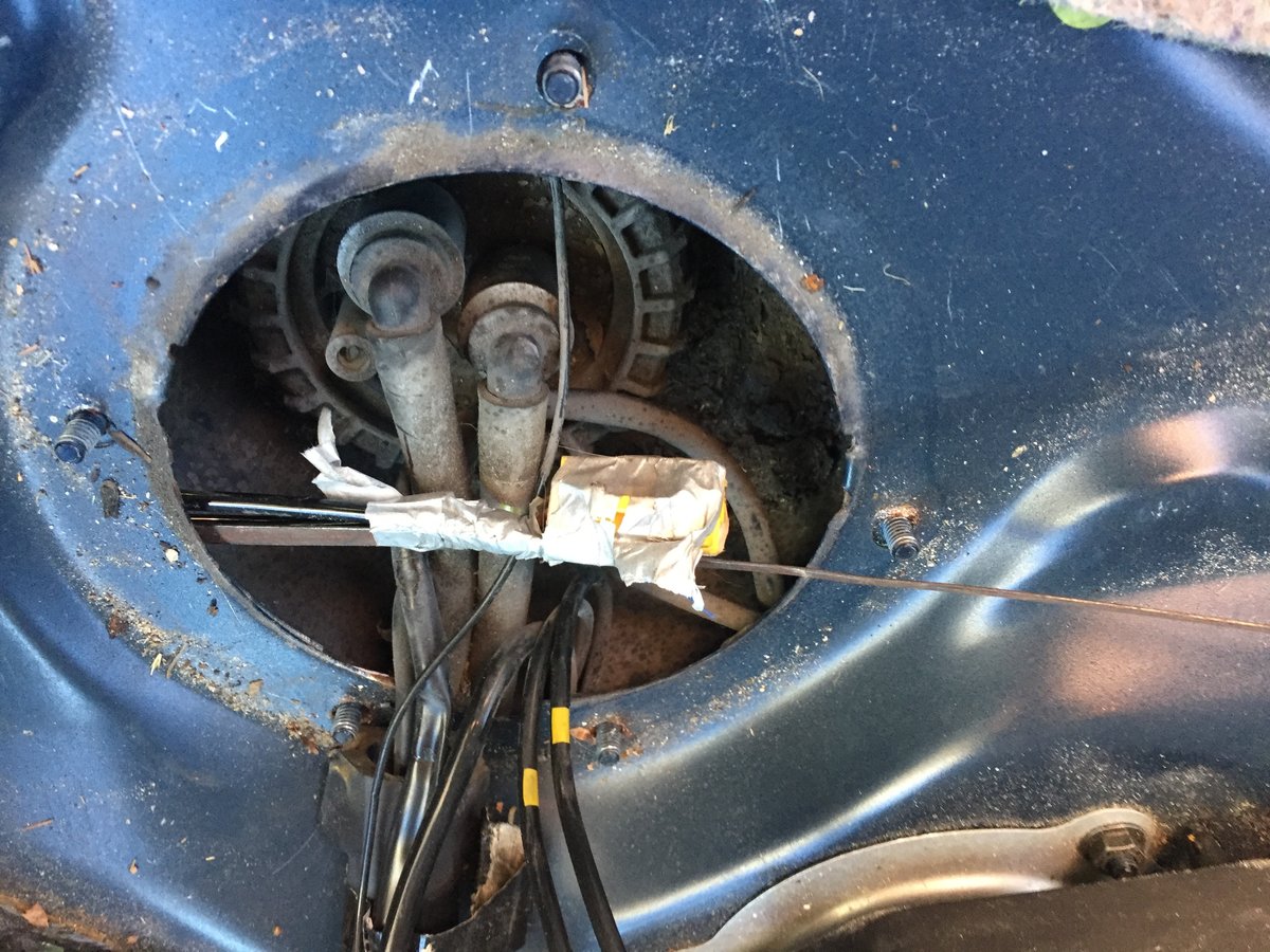

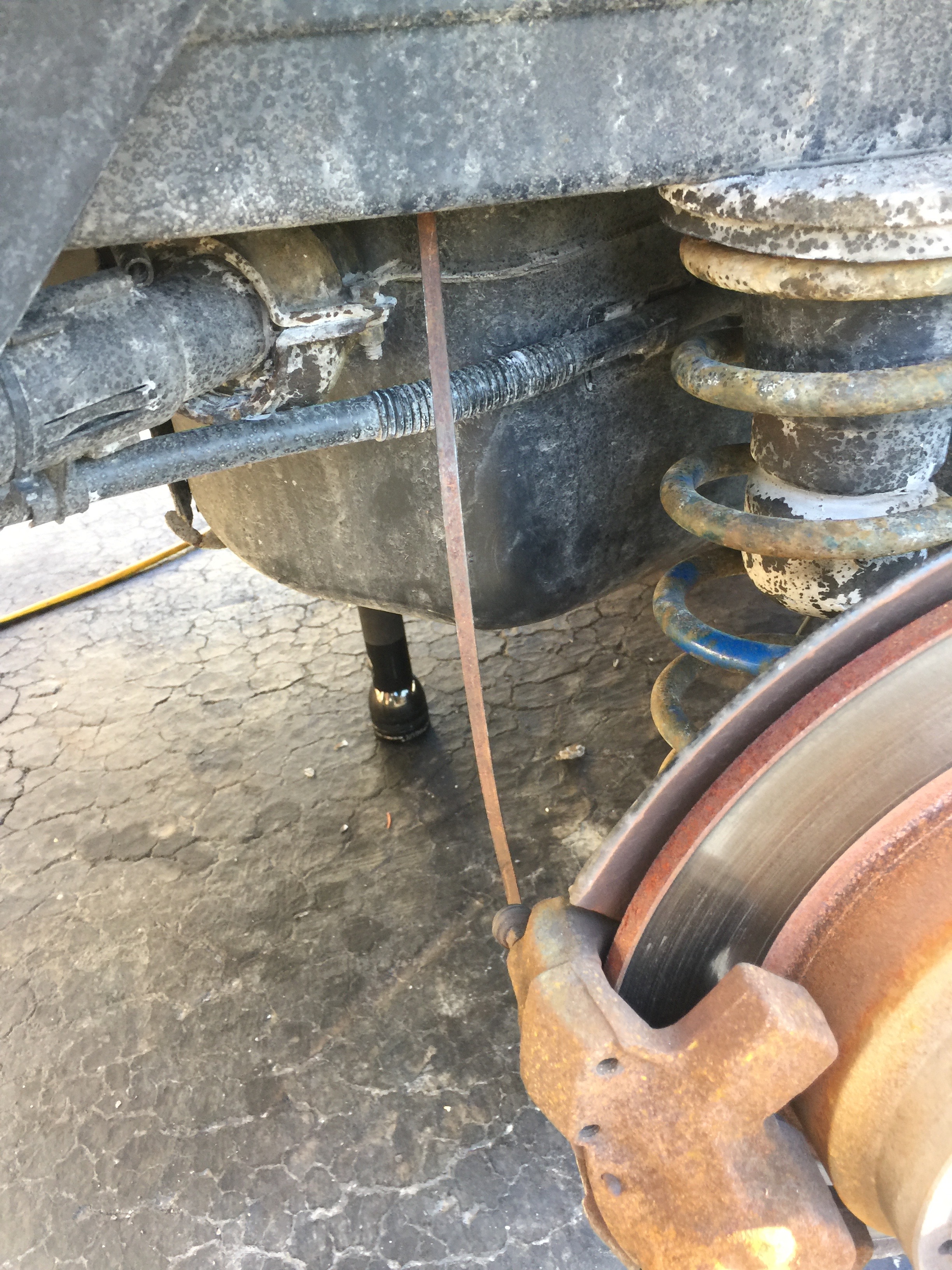

Fish tape down....
Fish tape down....
...and through
...and through

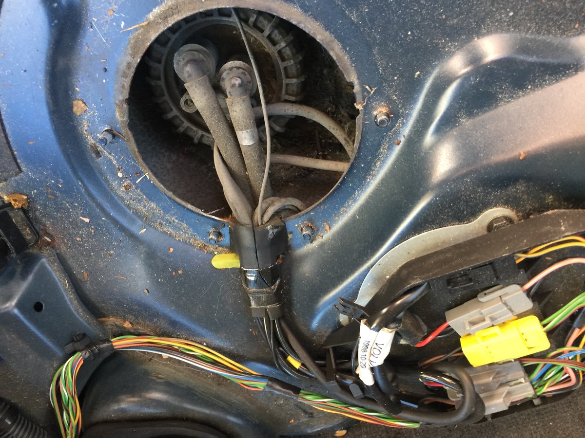

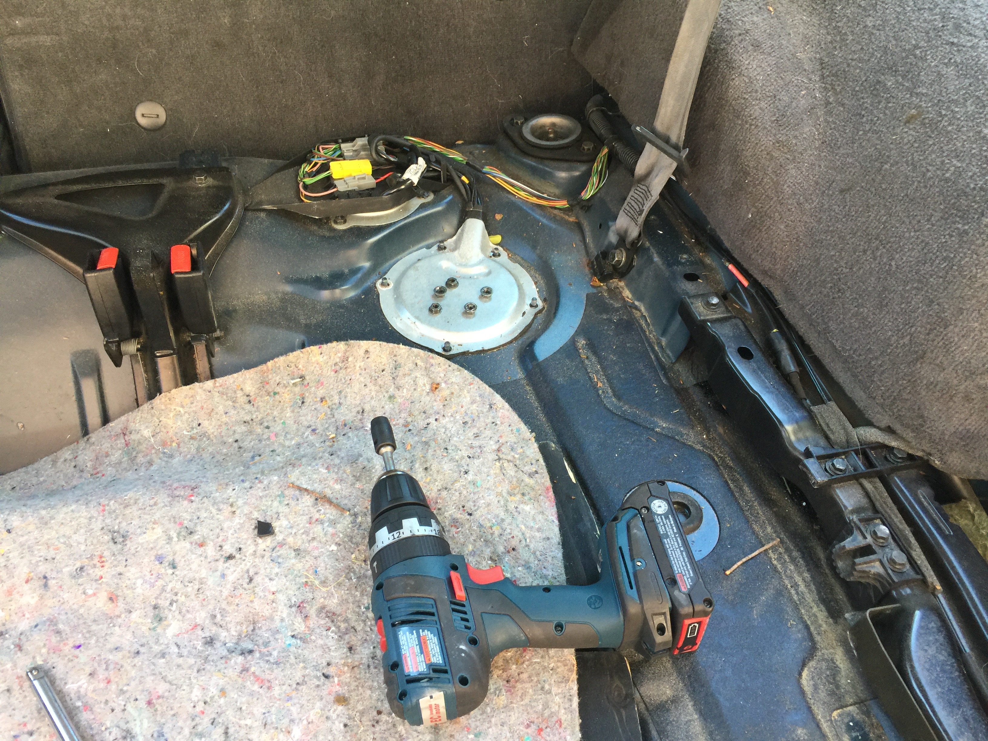

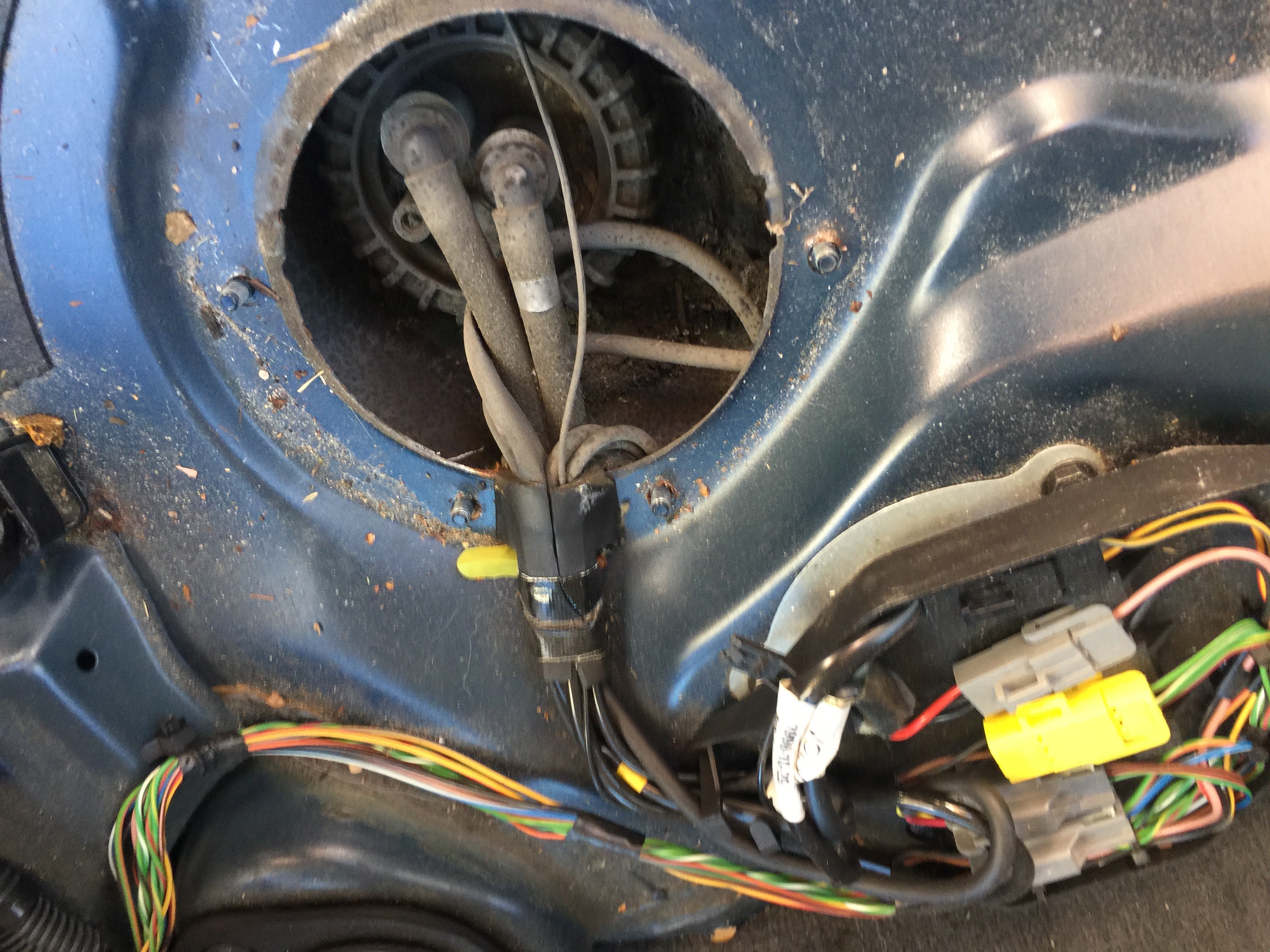

Connector successfully brought to access panel!!

Total time for job 75 minutes. I got hung on the left ABS sensor stuck in the hole, snapped it with pliers - so I had to punch it out through the brake drum with a long screwdriver.

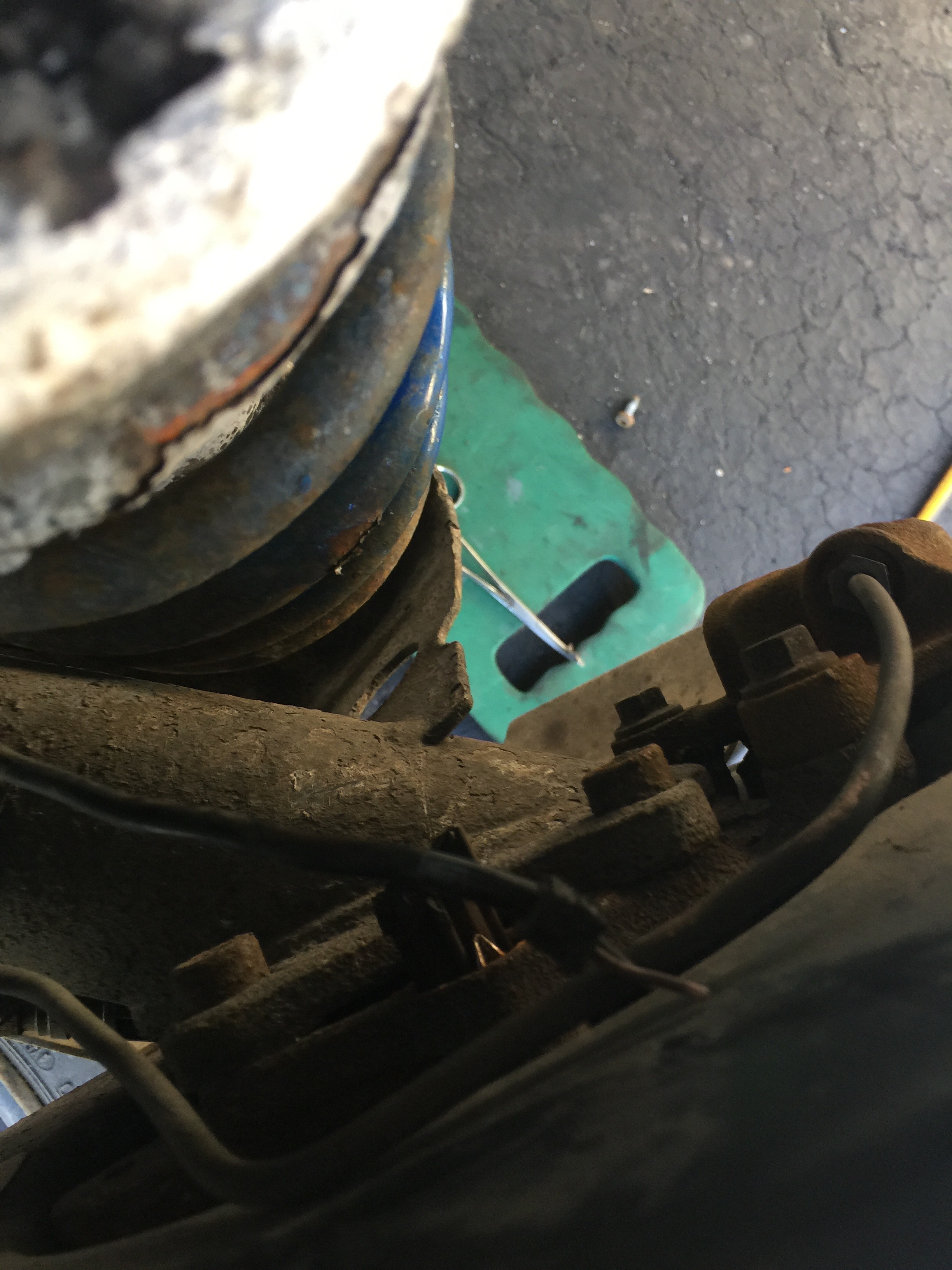

Root cause of problem. Long time ago, I had an indie do something on one wheel, and this is how they put it back together.
I had to solder this thing about 5 times, each time it broke again, just as I went to redo it, the wires would reconnect and my ABS would no longer fault.
Glad I finally fixed it right.
