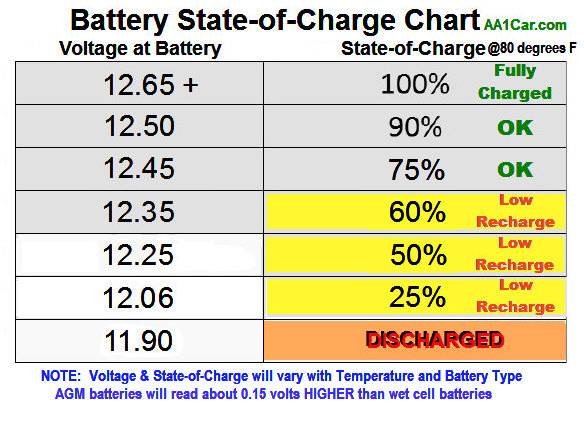

That doesn't matter....the battery shows voltage of 11.9v.That is flat battery.
Full battery must read 12.7-12.8v.
12.2v is 50% charge.
