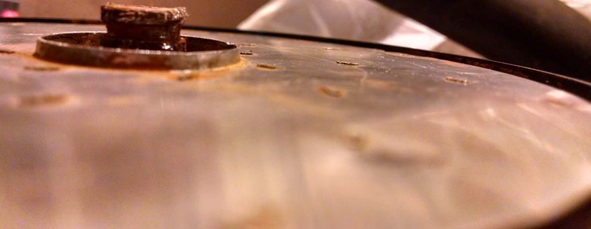

After more than 2 days of PB-Blaster and using a bearing puller all I was able to do is damage the collar of the impeller. See photo. Is there any chance a machine shop (or someone else who actually knows what they are doing, which excludes me) can pull this or is it likely a lost cause?

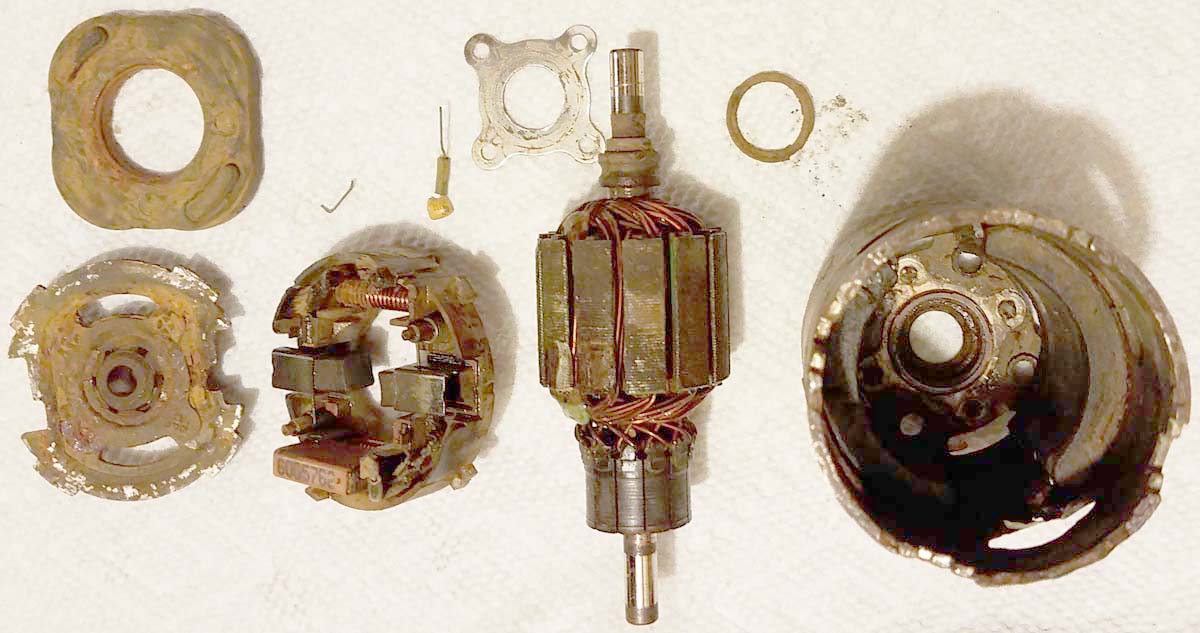

Learned how to use a bearing puller and have everything in pieces - pump and motor. My main concern is whether the motor is salvageable. As 800artfreed posted previously, the bearing fell apart when the armature was removed with ball bearings flying into the magnets and both races are frozen in place. The small circle is what's left of the bearing that isn't frozen in the motor housing. I also have an electrical component that I broke or was already broken from the brush holder during removal (see image).
The rear bearing is probably OK as is but replacing the ball bearing might be tough. I'm also concerned that I actually need that broken component for the motor to run at all. I guess I can test this without replacing the bearings.
Has anyone identified a replacement motor?
800artfreed: If you're listening - was your mod successful to accommodate the longer Graupner Speed 900 BB Torque motor?
Thanks.
Thanks.
