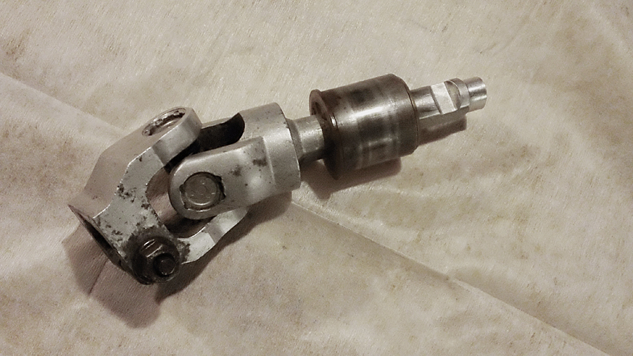

Starting to put it back together.
Serviced the rubber boot, bearing, collar at steering column, and the u-joint, all move with little to no resistance.
The creak noise as you turn steering could also come from the collar/flange, a three piece plastic assembly, size as the boot. You would hear it when handled. It is placed between the boot and the floor. It comes out with a spray of soap water, and gentle counter-clockwise turn.*
These come apart, lubricate lightly, snap three pieces together. Careful pushing the clips on the flange.
Spray the rubber boot with soap water and slide the collar back into place while rotating clockwise.
After little sanding, WD40, and cleaning spline it look ready for work. * a credit to JRL for insight into this service
