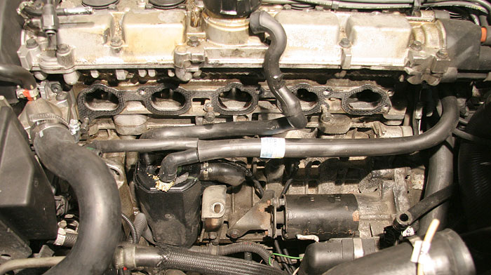

P.S.It looks just like this one and this is a turbo engine:

Wow, that is an interesting picture. I have never seen one where the line from the oil trap goes to the right of the oil filler cap. On all of mine (N/A or Turbo) it has gone more or less straight up and landed on the left side of the oil filler cap as you are looking at it from under the hood.

That hose is unattached.And yes,it goes at left side of the filler cap. :shock:
