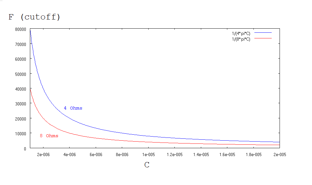

Here's a little plot of the cutoff frequencies vs capacitance for both the 4 Ohm and 8 Ohm speakers. You can see they are not the same.
Note that when using C=4uf, for the 4 Ohm speaker the cutoff is about 20000 Hertz while for the 8 Ohm it's around 10000 Hertz. Using 2uf for the 8 Ohm speaker brings it up to 20000 Hertz, but for the 4 Ohm speaker that would bring it up to 40000 Hertz.
Note these values are for a comparative analysis only. A speaker is actually more complex than a resistor.
