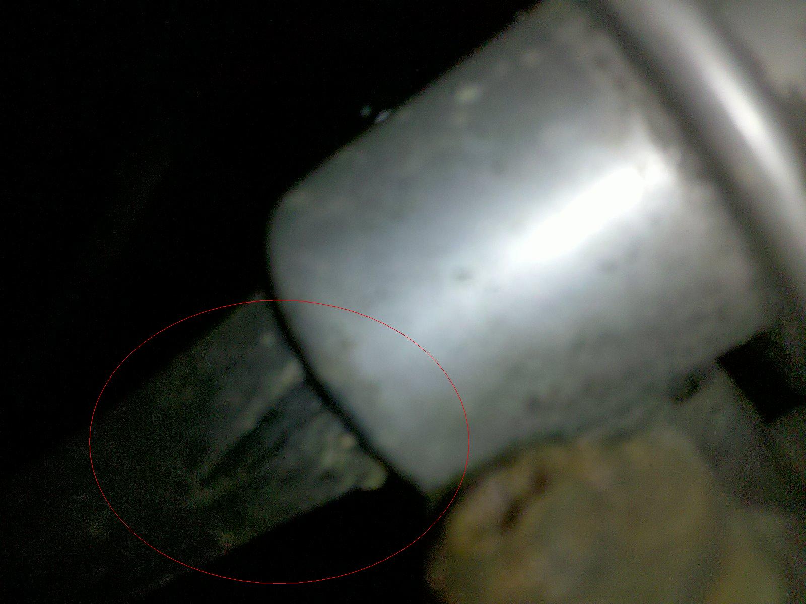

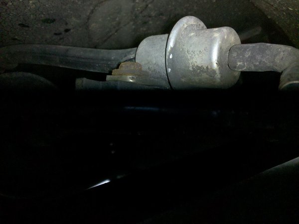

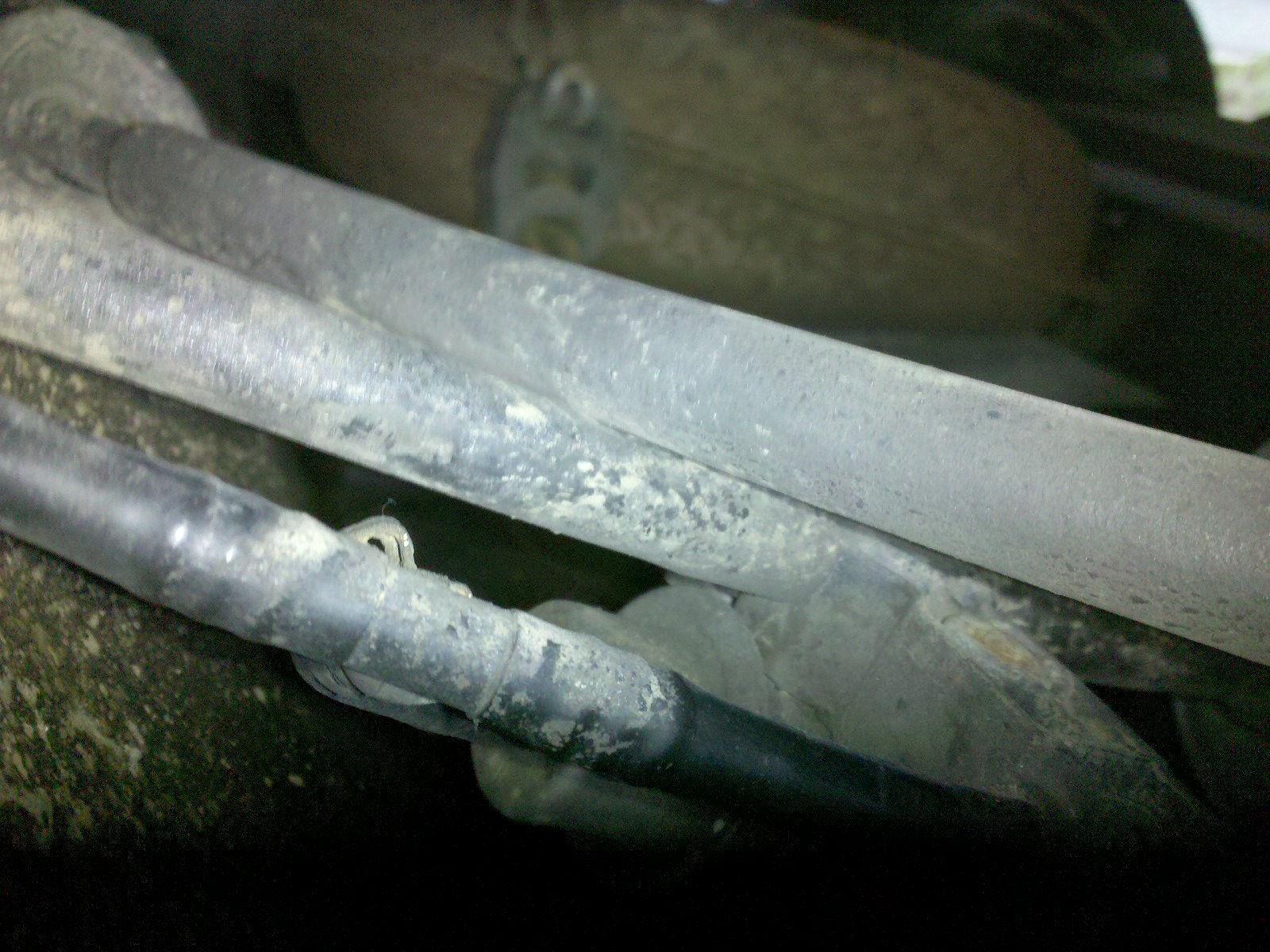

Sorry about the delays guys but work was a little crazy this week. So I did some looking around and I have submitted some pics for your opinions. I had just replaced the hose going from the TB and the purge valve and my prob did not change. I went looking for the "J" valve and from underneath it seemed to look like piping and was pretty solid. What I did find is what I believ is the rollover valve and the hose going to the tank side of it has a crack at the end ( circled in pic) could this be my culprit and if so could this be spliced or should the hose hose be replaced and lastly if it is the latter about how much hose do you think it would take ( I'm really not sure).

I think you found it.

I think I have as well. Is this just regular vacuum tubing or should I look for anything in particular?

I think that is just regular fuel line. I'd check the diameter, bring a piece to the parts store. Have them match it up, as fuel line. Better safe than sorry.
