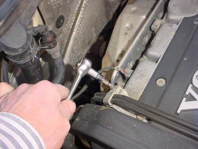

Trying to do PCV system and the fuel line to the rail is not connected by the two bolts system but a Torex 25 holding a piece of metal. I took that off now what pry it off or what I'm confused.
pic
1994 N/A 850 Fuel Rail Disconnect?
confused_al
- Posts: 1025
- Joined: 04 Aug 2008, 18:42
- Year and Model: 1996 TLA wagon
- Location: NJ
The fuel line is held by a C-clip, take out the screw which fasten the c-clip to the rail and then pull out the c-clip. After that you just pull the line out of the rail.
In case you didnt free the line yet, then you need to remove the fuel line clamp on the top of the engine (let me borrow Lee's pic here);
https://www.matthewsvolvosite.com/forums ... id=921&t=1
as well as remove the fuel line clamp behind the engine in order to free the line entirely.

Thank You Sir. I just had to spray with PB blast and wait then pry with a thicker tool. Had to pry out the fuel line pretty good was scared about breaking line, just had to get aggressive. Originally, I looked at my cousin's 850 and it had the nut and bolt type setup and then looked at mine and was like ...??!
