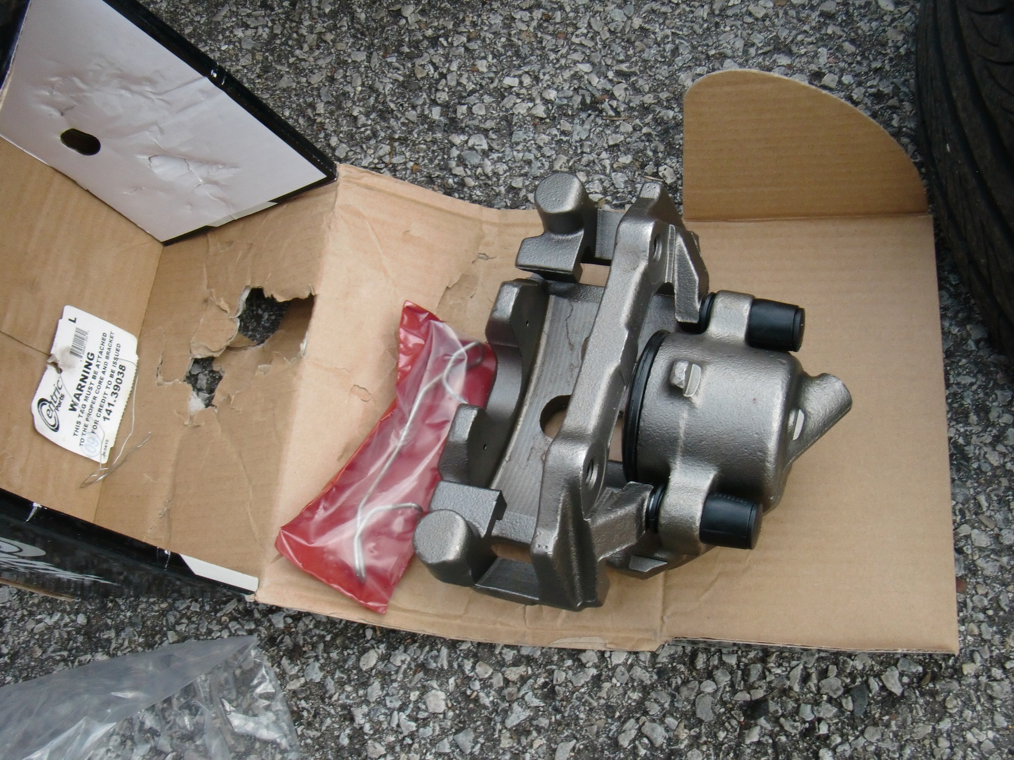

New/rebuilt caliper on its box

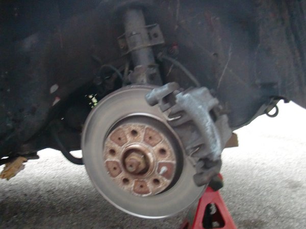

The old and busted stuff

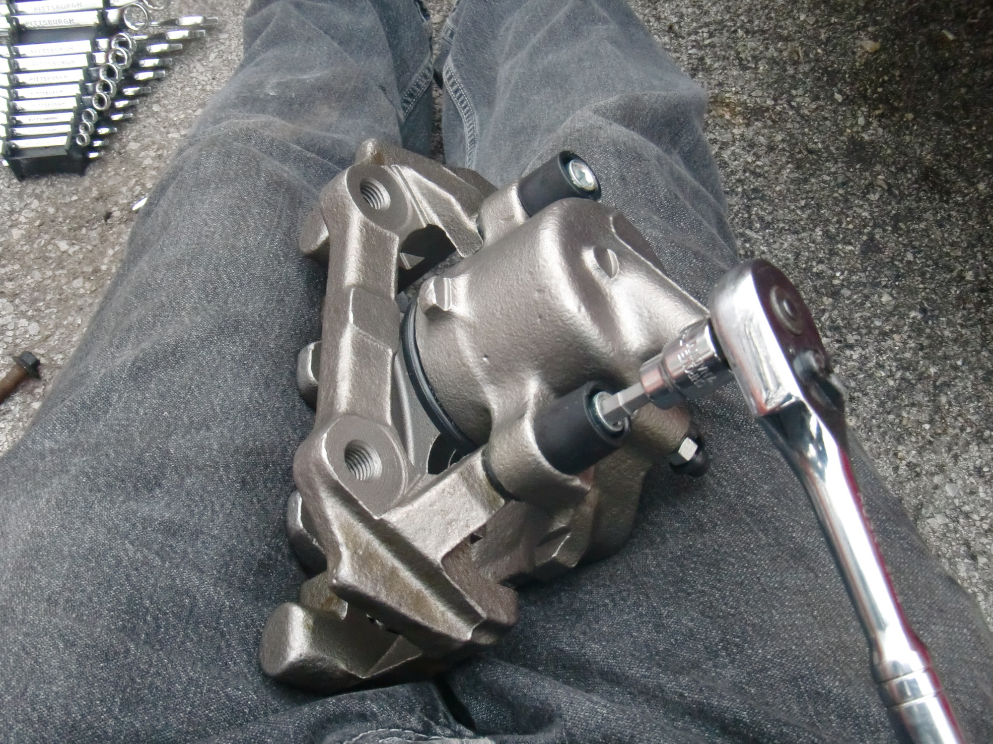

New caliper getting ready for it's new, larger bracket

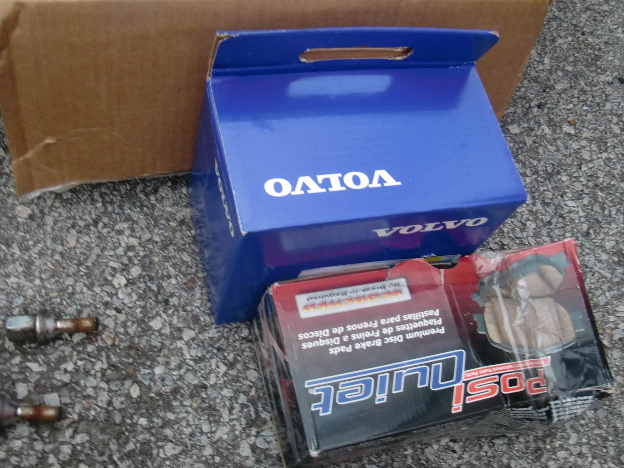

A blue Volvo box... I don't know why I didn't take a picture of the caliper bracket in it

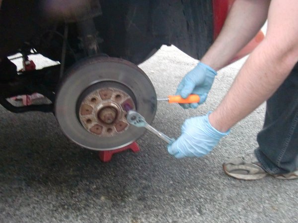

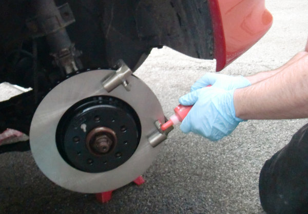

Here's how to hold the rotor while you break loose the locator pin
Lubing up the new bracket
Lube on the pad's springs and on the piston's top ring surface... this pad has been snapped into the piston and removed - I forget why.

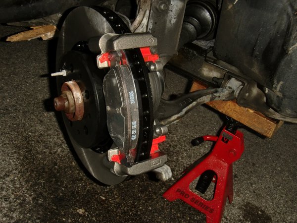

New outside pad laid into the lubed caliper bracket

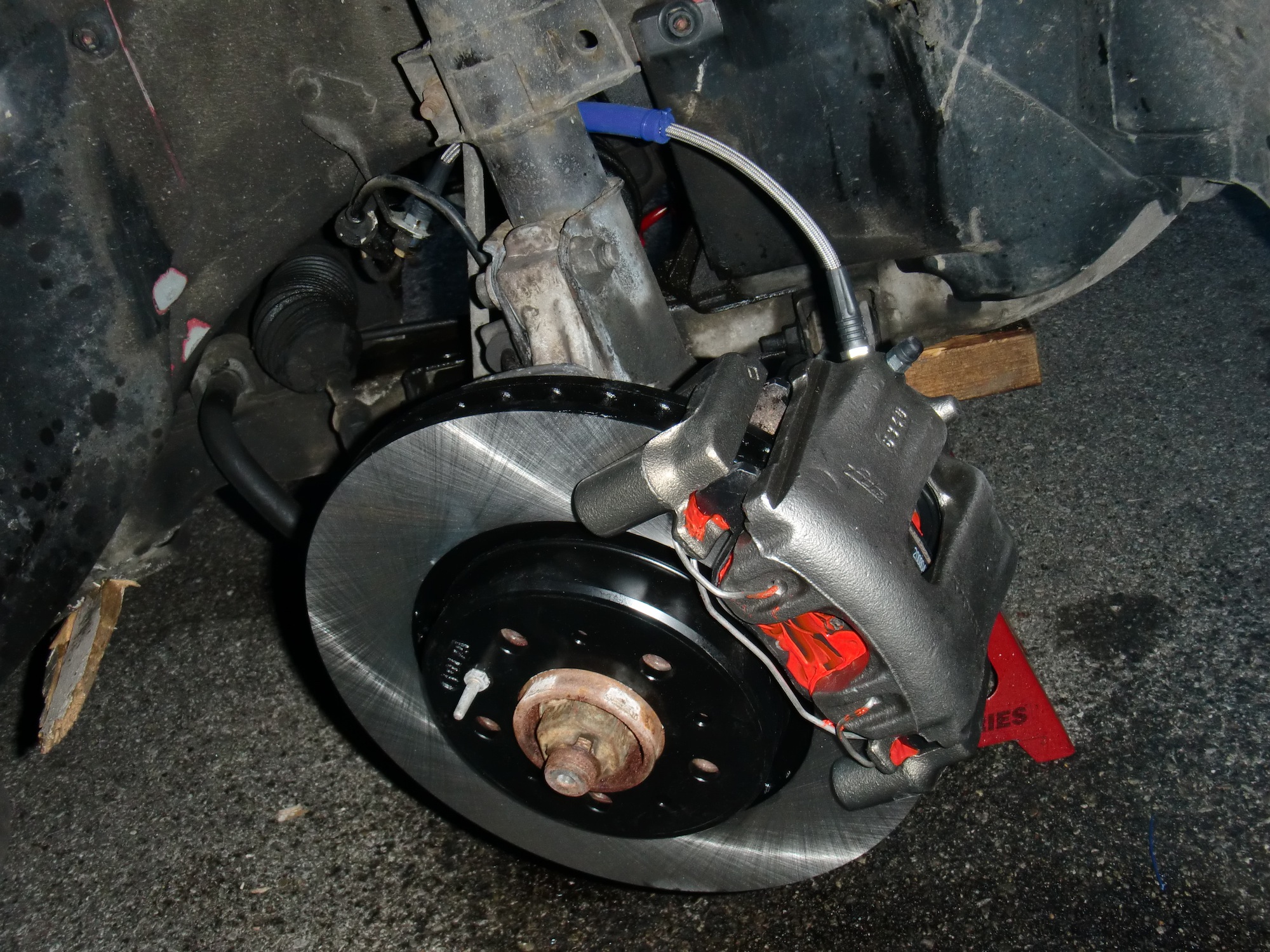

Everything fit really nicely - the spring was a pain, of course, but it all came together nicely
