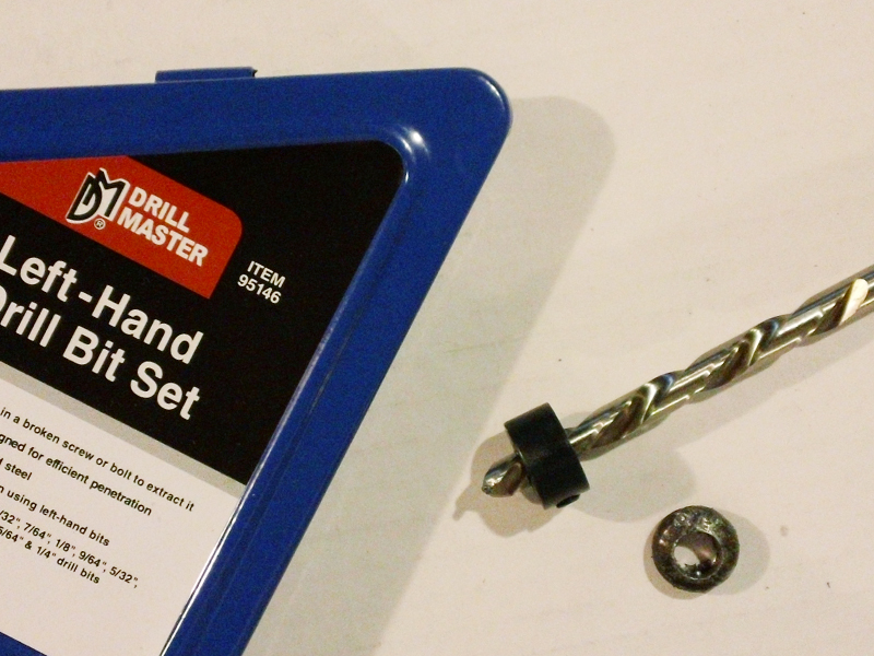

After much deliberation with MVS DIYers, see .../viewtopic.php?f=1&t=34806&start=28
I am choosing 1/4" left-handed drill bit to extract, drill out the stripped T40 from t-stat upper housing. The fuel line on disconnected at the rail, sealed and protected.

No, just drill the head of the bolt off. Once the head is free, take the housing off and remove the rest of the bolt with vice grips or something. Do not try to drill the entire bolt out.

I will slide and screw in the stopper, and won't drill pass the head depth.

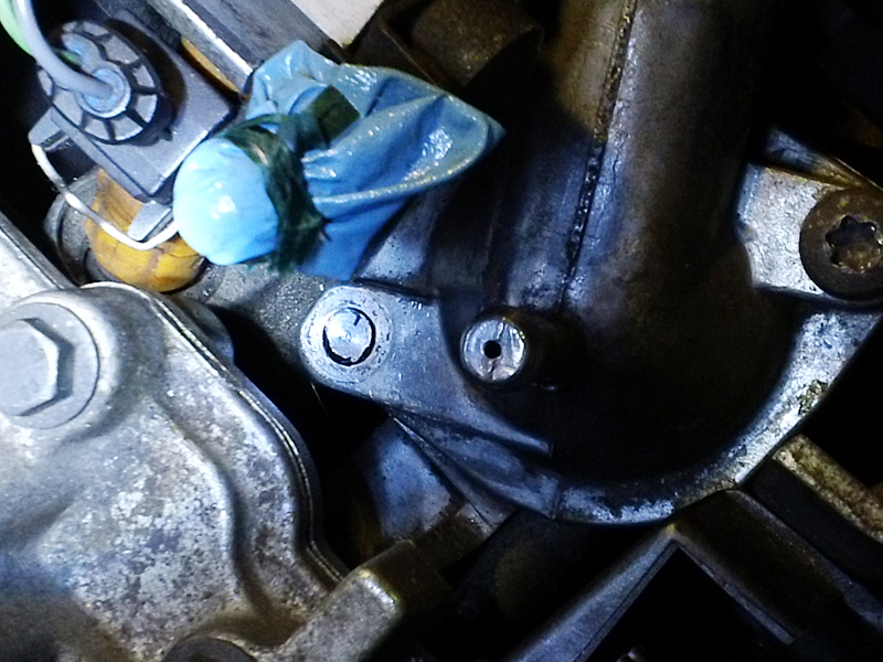

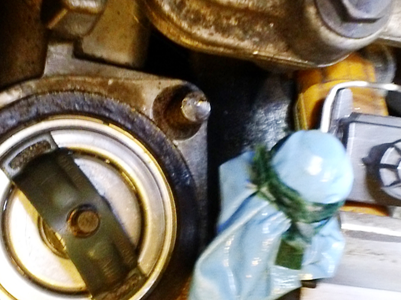

Using oil does make drilling not only smooth, it keeps the shavings together. I still have shank to pull out.
1/4" left-handed drill bit with stopper, and removed T40 screw head
head is drilled out...
shank still has to come out...

xHeart wrote:Using oil does make drilling not only smooth, it keeps the shavings together. I still have shank to pull out.
Are you using grip pliers to get the shank out?
