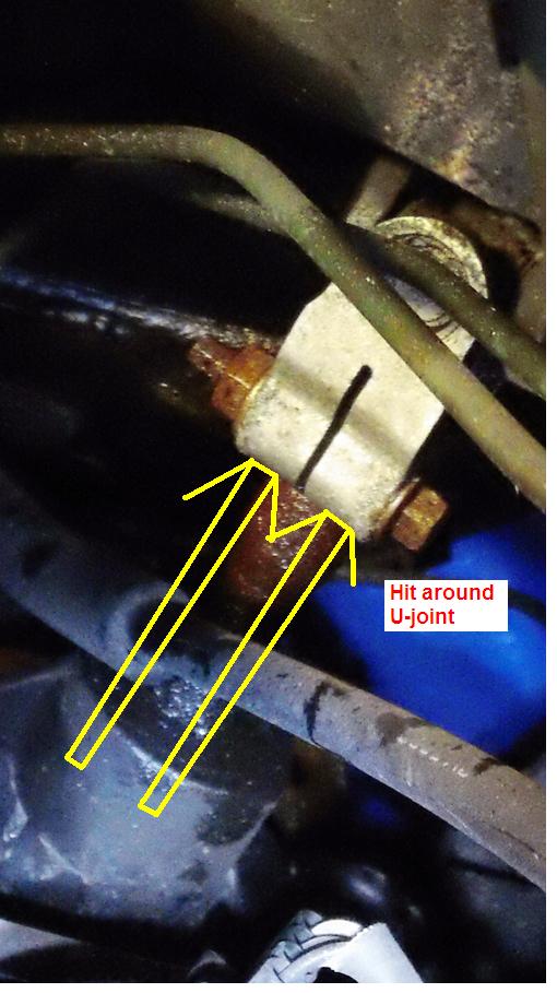

...separating the steering shaft from the u-joint. I have the pinch bolt off, but now in a...
steering shaft and u-joint

Once the pinch bolt is loosened.....
Use a long steel rebar or equivalent, gently hit the U-joint, don't damage it.
Just go around it.

Thank you for the pointer cn90.
The steering gear is now disconnected except from the u-joint.
A proper placement on u-joint would require the metal bar to enter at the small space between tranny and the rack, and from below the subframe.
Since lowering of the subframe, I am asking myself, if I should have raise the car little more. It is on 4 jack stand with the engine support bar at the top.
Any thoughts on rasing further while subframe hangs?
