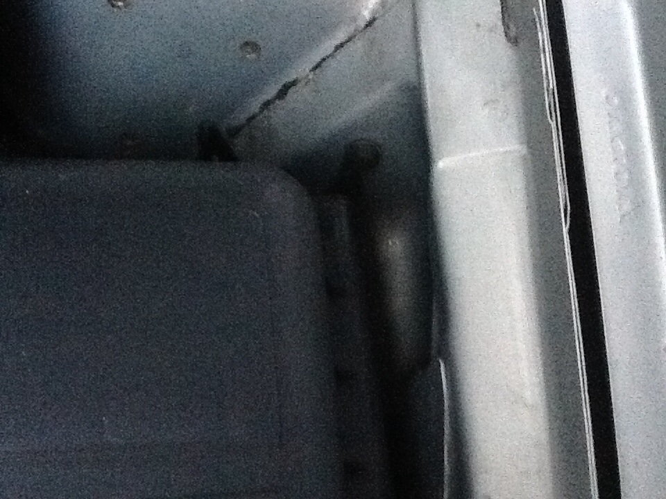

hi guys, I R&R the ground on the strut tower. as I removed the screw I saw the left headlight dim. tightened screw and headlight came to full brightness. there are three wires at the cornor light, green, black and white. which one of these three wires would make the cornr light not illuminate. the turn signal operates.

White is the side light
Green is the indicator
Black is the earth wire to both filaments within the single bulb
The earth point you cleaned up is also for the main headlight on that side of the car as well as a few other items, there is also an inline splice between the earth point and the corner light, if this is breaking down you will need to locate it in the main wiring runs to replace it - Mike

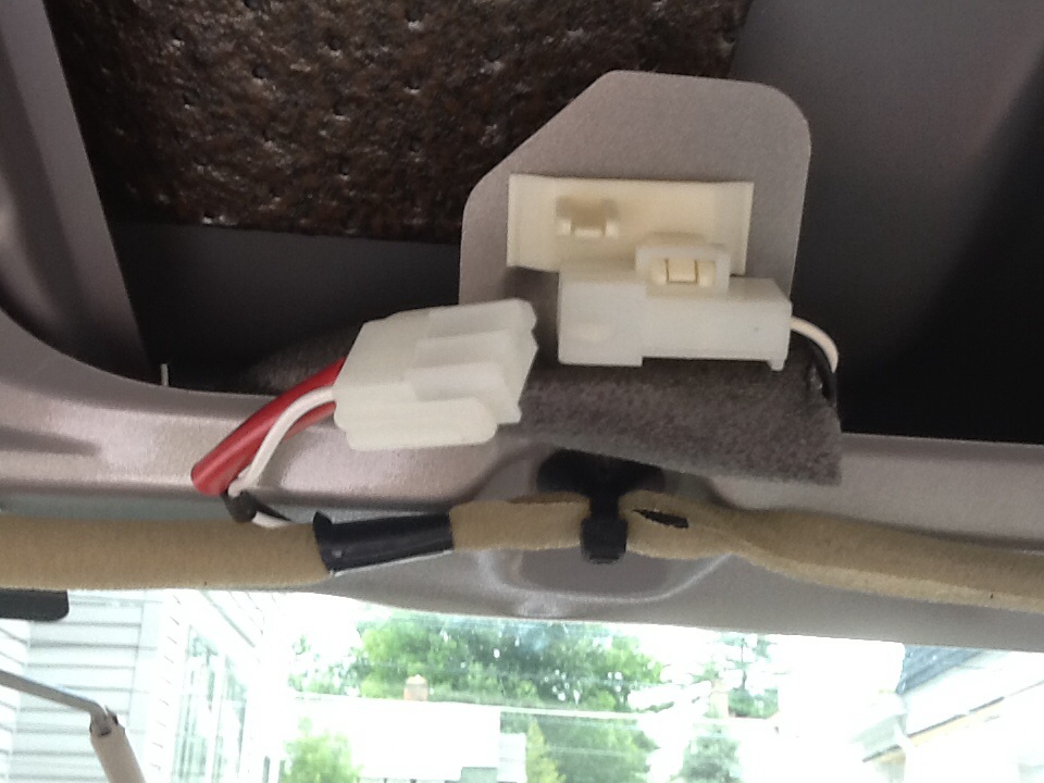

OK, I got the cornor light to operate by disconnecting the plug to the license plate lights and installing a 10 amp fuse. SO I think my short is either from the plug to the license plate light assbly or from the plug going back into the car.
if I put a jumper cable on the plug end leading back into the the car and the fuse blows would that tell me that my short is on the car side of the plug?
