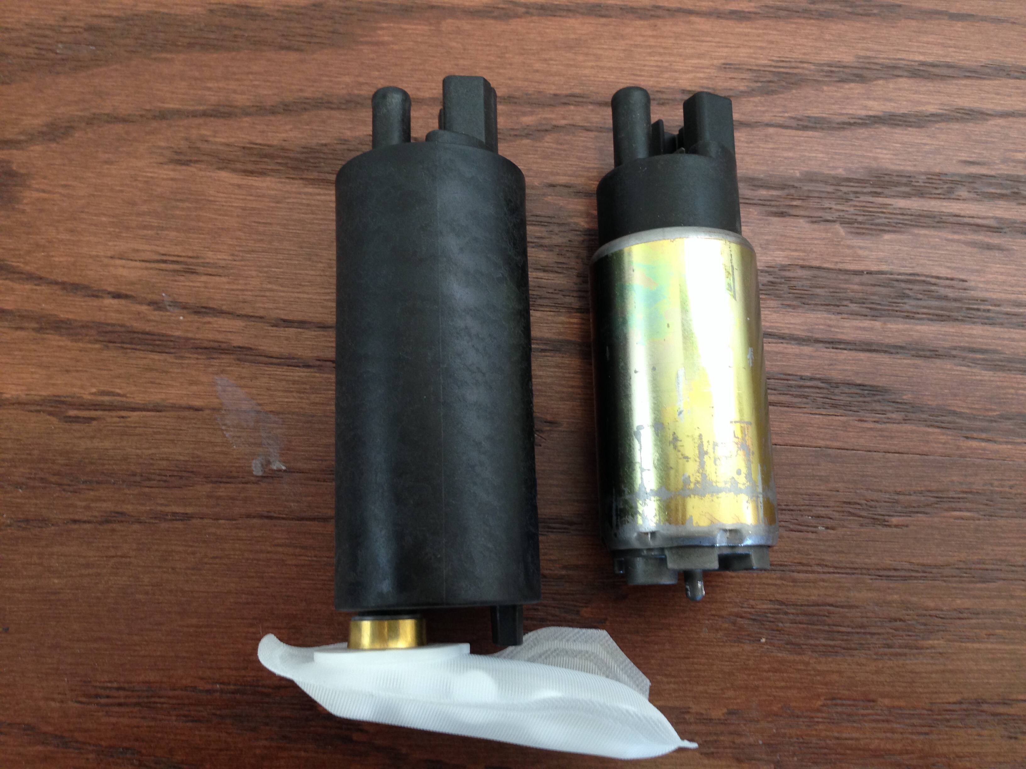

All of these parts look like the one I purchased and it has this hard plastic case around it. It wouldn't come out. It cost me 220.00. The pump insert I pulled out didn't have any casing around it. What to do you guys think? If I figure out to post a picture I will.

If you bought a preassembled pump in the white casing, then you are good to go. Just install it.

Does it look like this?

IMG_0100.JPGcn90 wrote:stephan,
To save time/clarify, post a few photos so we can help you.
It's the one inthe right I pulled out

Read the "reviews" in the links below and you will know what to do. Basically minor modifications and that is all:

I took off the black casing and it fit like a glove and it seems to work. Outside temp when I changed it was around 50. It was straight forward.cn90 wrote:Read the "reviews" in the links below and you will know what to do. Basically minor modifications and that is all:
