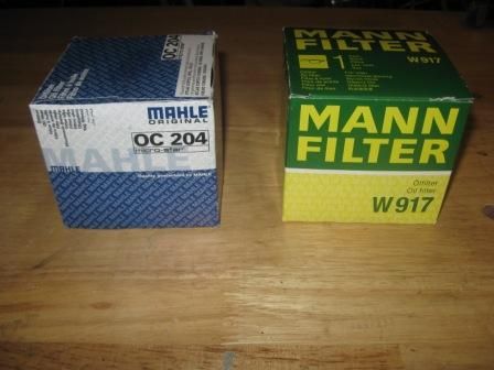

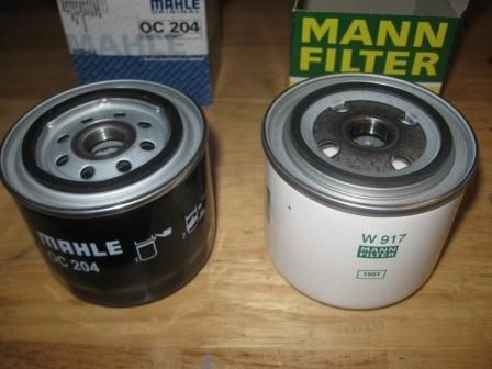

After seeing countless videos of people disassembling non-Volvo oil filters, and not finding any pictures of Volvo oil filters, I decided to cut open a pair. Why only two, and which two?
One had to be the standard Mann W917, mostly because discussions about them usually follow this format:
'Why do you use Mann filters?
Because Volvo craves them.
But why does Volvo crave them?
Because they are the best.
But why are they the best?
Because they are Mann filters!'
The second was a Mahle OC204. This is another euro market product (made in Austria) from a large OEM and aftermarket supplier with essentially the same price point as Mann. And quite frankly, based on the scary pictures I've seen, I don't buy orange filters, and would not encourage anyone else to either.

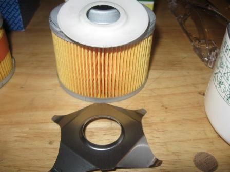

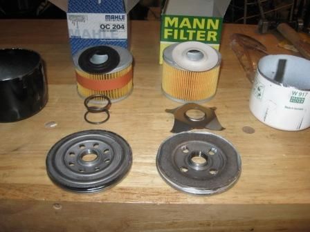

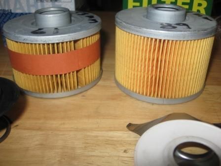

Although my title may claim otherwise, this is a very non-scientific study. But, there appears to be is subjective superiority to the Mann filter vs the Mahle as follows:
  • More pleats - 89 vs 61
    A taller element - 59mm vs 53mm

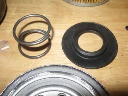

    Possibly a silicone anti-drainback valve vs neoprene. (Allegedly silicone remains more flexible under cold temperatures)
This is a pleasant surprise, as sometimes the mythology doesn't match reality.
For the price, I'd say Mann is the way to go. If anyone else wants to cut open some other brands, let me know what you find!
