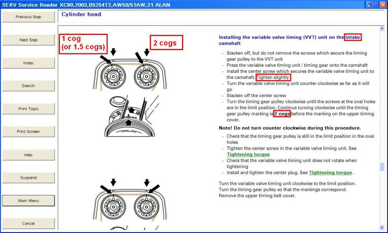

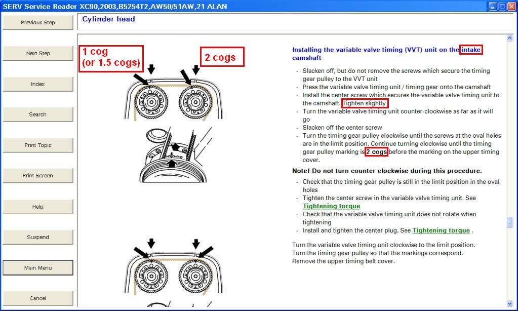

3. The VVT Hub.
You can search the internet, but the info from VIDA is very dumb: 1 cog to the left (exhaust hub), 2 cogs to the left (intake hub) but they never explain to you why.
Most forums say this say that and it can very very very confusing to the novice.
I will summarize the VVT Hub for you...
4. This is the theory behind the VVT engineering, see photos below.
* VIDA 1 cog, 2 cog business thingy...
* This is my summary, figures a and b shows the normal operation when engine is running: without and with solenoid activated to advance the cam.
* Tighten the T55 bolt only when you are happy with all the marks.
* During TB job, with the TB removed, it is a different ball game: during installation, you need to move the OUTER Hub CW a little bit (figures c and d) until it is stopped by the INNER Hub (which is locked in place by the snugged T55 bolt). Then install the TB.

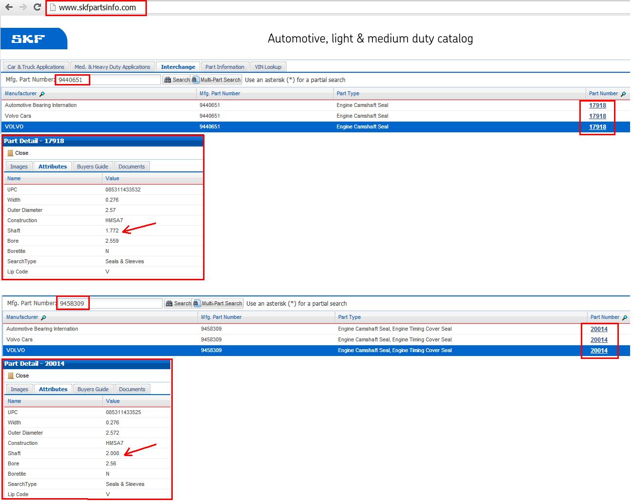

Re FCP Kit... 9440651 vs 9458309.
See the links below:
http://www.volvopartswebstore.com/showA ... ct=1197703
http://www.volvopartswebstore.com/showA ... bly=235818
https://www.matthewsvolvosite.com/forums ... =1&t=61563
I think your 2004 XC90 uses the same cam seals for the FRONT. You should go to your local Volvo dealer and verify.
According to SKF website, there is a difference in 9440651 vs 9458309, basically in the shaft dimension, not the bore side. I think 9440651 is used in cars with different intake and exhaust sprockets, while 9458309 is used in cars with the same VVT sprockets.
