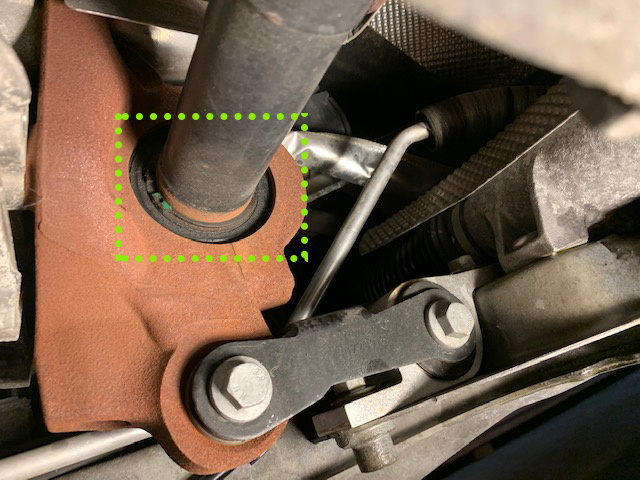

I now have Hutchinson version of the upper torque mount upper and lower torque rod; preparing to replace the two this weekend. While assessing the removal of the lower rod from the bracket, the rusty ring around the axle at the bearing mount looked suspicious. Any thoughts on the exposer and layer of rust?
Here is the pix:
Here is the pix:
