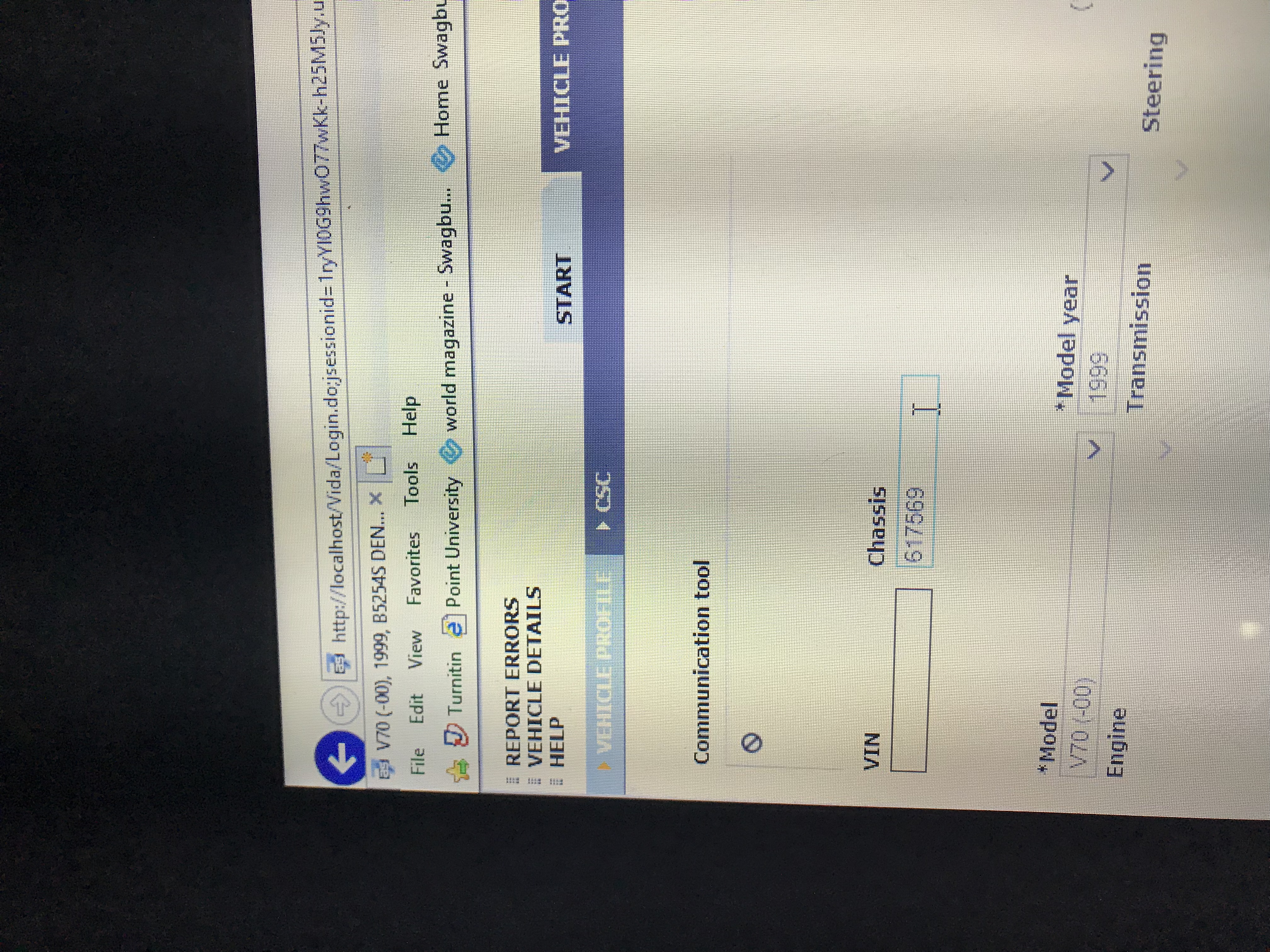

Okay so Rick helped me get VIDA going, I have made it to the point where I can log into Vida with “1”, enter my cars info, but DiCE is not connected.
I can go onto my computer, find DiCE and test it through the DiCE diagnostic tool.
The DiCE will test “okay” for every test I can run, sometimes it will say “self diagnostic tool not okay”
Then test “not okay”
But even when it does test “okay” I cannot get it connected to Vida.
What have I missed?? And why will it only pass the “interface test” sometimes. One minute it will one minute it won’t...then it will again.

AaronsVolvo
Re: Intalling Vida 2014D for the first time Windows 10 Home
Post by AaronsVolvo » Fri Mar 09, 2018 7:53 pm
Here’s two pictures I took of my screen...

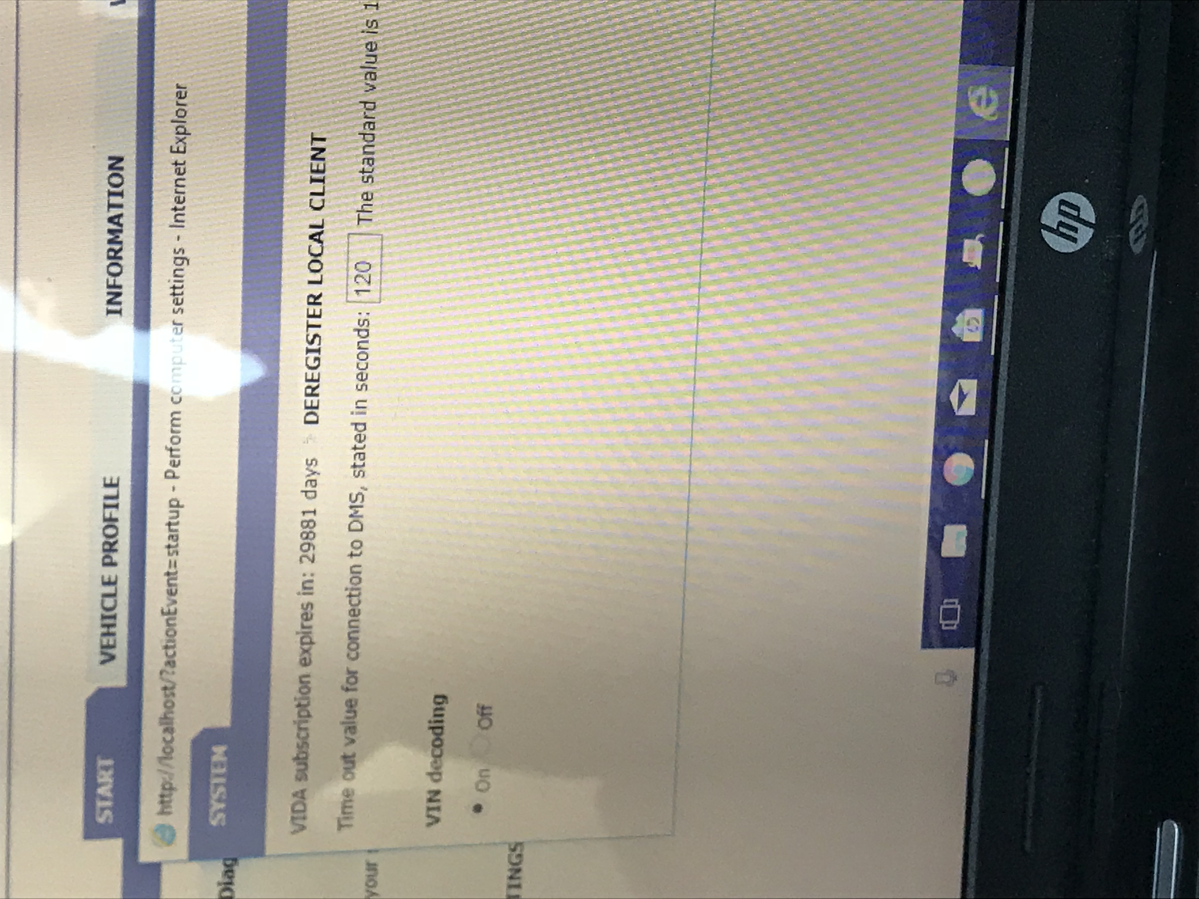

AaronsVolvo
Post by AaronsVolvo » Fri Mar 09, 2018 7:56 pm
Pic 2
Post by RickHaleParker » Fri Mar 09, 2018 11:38 pm
Try reinstalling the DiCE Software from the RePack.iso :\3PP\Products\DiCE\
Reboot after install.
If reinstalling does not work try this.
Partner group for North America is AME, 2 will log you straight into the AME Partner group.
AME = North America
EUR = Europe
INT = International Misc
NOR = Nordic Countries
Logins

AaronsVolvo
Post by AaronsVolvo » Sat Mar 10, 2018 8:34 am
Isn’t there supposed to be a tab here for me to add the Dice?

AaronsVolvo
Post by AaronsVolvo » Sat Mar 10, 2018 9:10 am
I tried reinstalling VIDA to see if something was wrong there.
I got a pop up, I may have gotten this before. Would this stop DiCE from connecting to Vida?
Post by RickHaleParker » Sat Mar 10, 2018 10:28 am
Your trying to install the Vida that came with the DiCE hardware or you ran script 5 on the 2014D_RePack which my install instructions say not to run.
We know the RePack works with Windows 10 Home. Mr Brian 200 and I both tested it on Windows 10 Home. The Vida that came with came with your DiCE hardware requires Windows 7 Professional, that is why I pointed you toward the Repack. The RePack has modifications that let one install Vida on Windows 7,8 & 10 any version except 7 starter.
Take the Vida disk that came with the DiCE hardware and put it up on a high shelf and forget about it. Do everything from the 2014D_RePack.iso
1. Install and work from the 2014D_RePack.iso per my instructions.
2. You misspelled "regedit" (registry edit). regedit is on your system. Watch what your do in the Registry Editor, If you do make any changes, take your time and make sure you do it right the first time.
