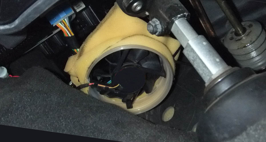

I've come across several reports by owners who state when their CEM or DIM freaks out/acts up they discover a pool of superheated air trapped up behind the dash where these modules are. When things cool off normal functionality often returns.
I'm not having problems with the CEM or DIM on mine (MYO6 S60), this would be considered a 'preemptive strike'.
I decided to lessen my chances of having problems down the road with a simple fan to keep this pool of super heated air from collecting back there in the first place. The CEM is considered a low power design probably less than 40w of total thermal load to dissipate. The DIM would be in the same neighborhood considering it's filled with incandescent bulbs. They don't need a dedicated fan pushing air directly into their housings like a high performance PC/laptop. They just need a modest flow of fresh air in their general area.
Hence a 120mm silent higher CFM computer fan which makes a breeze you can feel tied into the 12V power port circuit (on at KP I/II only). Held securely by cable ties to keep it from wandering into the steering mechanism. 0.4A isn't going to break the bank with regard to electrical overhead on the car. Though directed specifically at the CEM, the DIM and center stack components should also benefit as the air behind entire front console is no longer standing/stagnant.

I'm noticing when changing audio CDs they aren't super hot when they spit out of the AUM like they used to be either. Now they're just warm.
It wouldn't take much to design a custom plastic bracket bundled with a silent fan and offer it in the aftermarket to make it easy for people. It could hold onto the rear of the lower trim panel in the space where I put this one with some sort of hook or catch that goes around the backside of the CEM to keep it from sliding over into the steering mechanism. With a little research I bet there's an open fuse positon right there on the CEM that ties into this circuit and can be tapped. I used an in-line glass fuse holder on this @ 1A.

Did you make the shroud? I've only seen "squared off" black fans in my travels.

Pushes air up into the dash. Heated air rises so in theory it should be more effective to force cool air in from the bottom rather than try to reverse the natural flow of convection. And the coolest pool of air to draw from would be down at the floor, hence air flow through the fan is 'up'.
