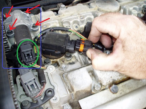

I think your solenoid is the same as mine. If so, these directions should work for you.
Go to this post and read about half way through to see how to get to the solenoid (you don't need to change the spark plugs, but if you want to do that anyway, this is a good time). If you don't have a turbo, you won't have to remove all the tubes on the top of the engine. Once you get the covers off the top of the engine you can access the solenoid. https://www.matthewsvolvosite.com/forums ... 11&t=17431
See the following pic. The solenoid is in the blue rectangle. Disconnect the electrical connector (green ellipse). Remove the four bolts (red arrows), and lift the solenoid off the engine. You might get some oil spillage, so keep a rag handy. Take off the gasket. Reverse to install new parts.

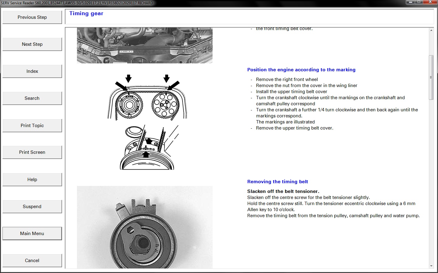

There's a lot of issues with the TB that if you observe can make it simple and easy, but if you're not aware of them it can throw a code on your car because the timing will be a little off. The code thrown should be able to be read from a regular code reader - go to AutoZone when you get the CEL and have them check it.
Basically the camshafts have to be rotated to TDC but often the TDC marking wears out or won't be correct over extended periods of time (have seen it happen). They need to rotate the crank & cam to line up correctly which is NOT shown in Mitchells (which is most likely what your indy shop is using) but is shown in VADIS (see attachment). give them this sheet and ask them if they did this I have a good feeling they did not.

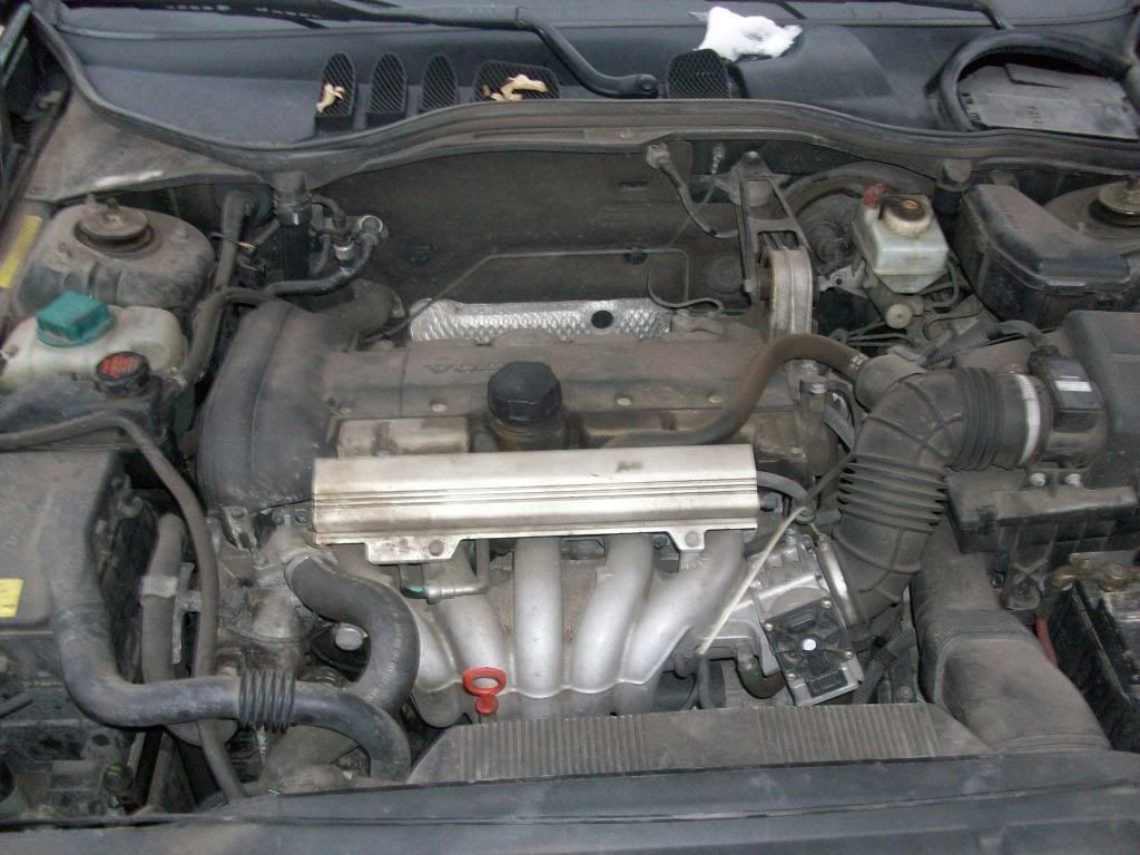

As far as the oil sludge you need to be more specific of the location. if you can take a picture of it and show it. Could be as simple as a bad oil cap oring which is very common, especially if you have a turbocharged S60. Could be something like needed to replace the cam seals, doubtful it is the CVVT gasket though.

you're saying they looked at the directions I posted and said that's what they did? If so then they did not set the cams correctly. I'm 100% positive the TB change was not done correctly.
