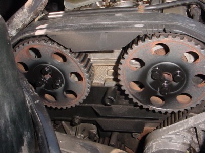

Usually the cam seals blow out due to a clogged PCV system.
And bah. The front one's not too bad, but a pain if you've never done it before. The front cam gear (and timing belt) have got to come off, and then you will be able to access and replace the cam seal and crank seal.
If you haven't changed your timing belt, or are coming up on that time, now would be the time to do it and all the associated parts. The VVT on your S60 (my 98 doesn't have it) makes that process a little bit harder to reset on your car, but it's not too involved. Search 'timing belt replacement' for a how-to on this process. I can't find a write-up with pictures to walk you through the process, but this thread as well as the timing belt tutorial on the site here should help you somewhat at least:
