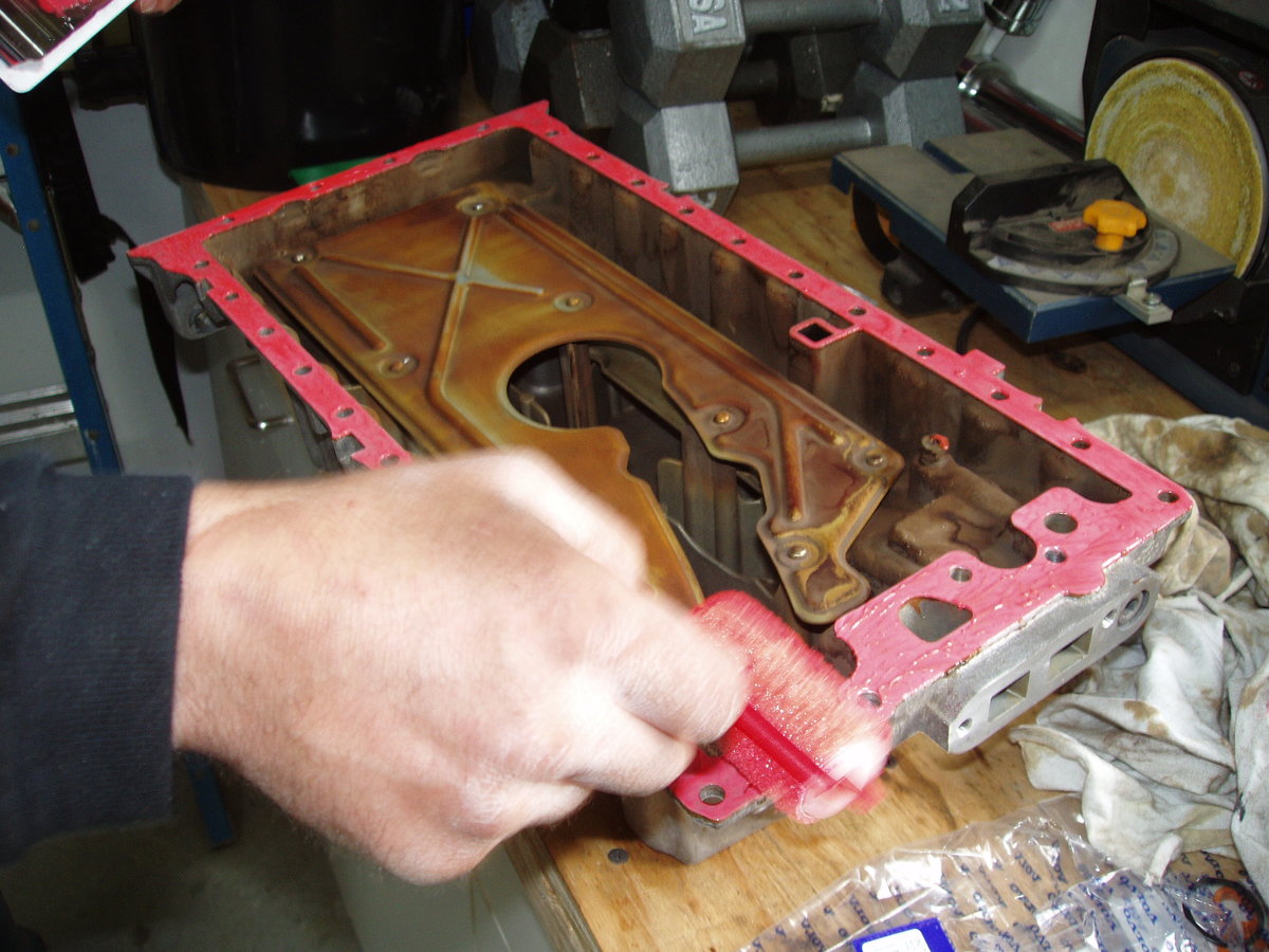

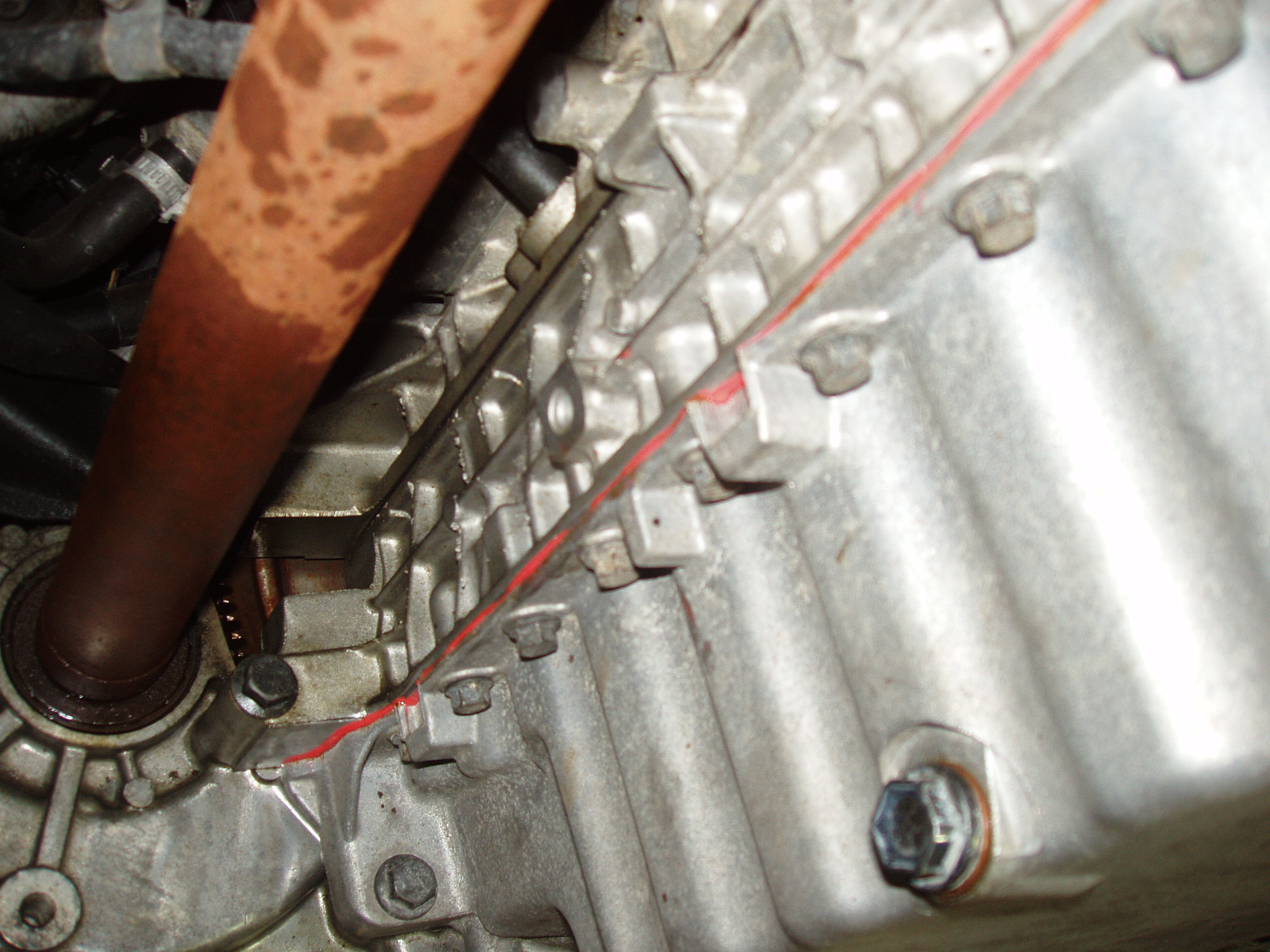

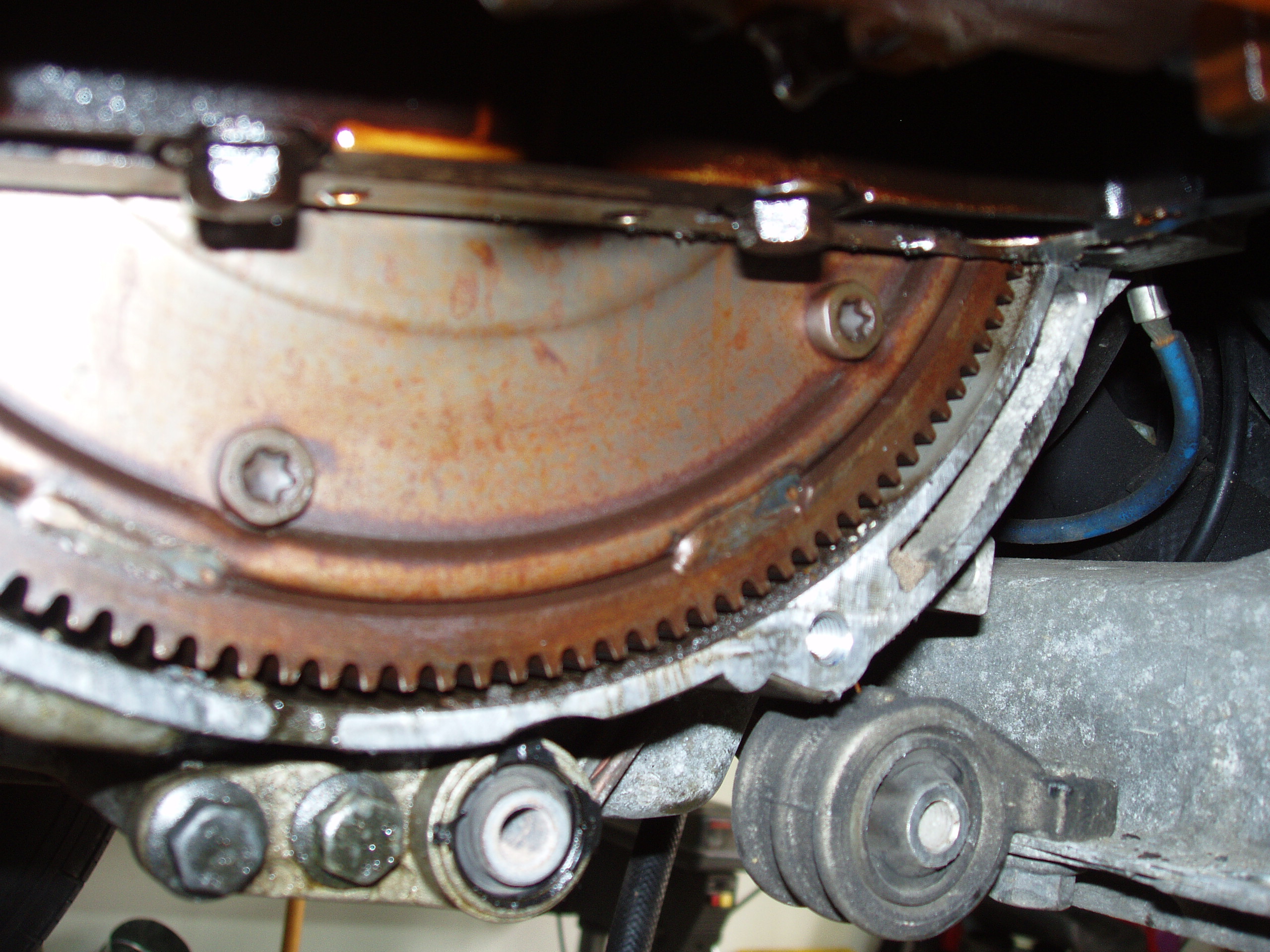

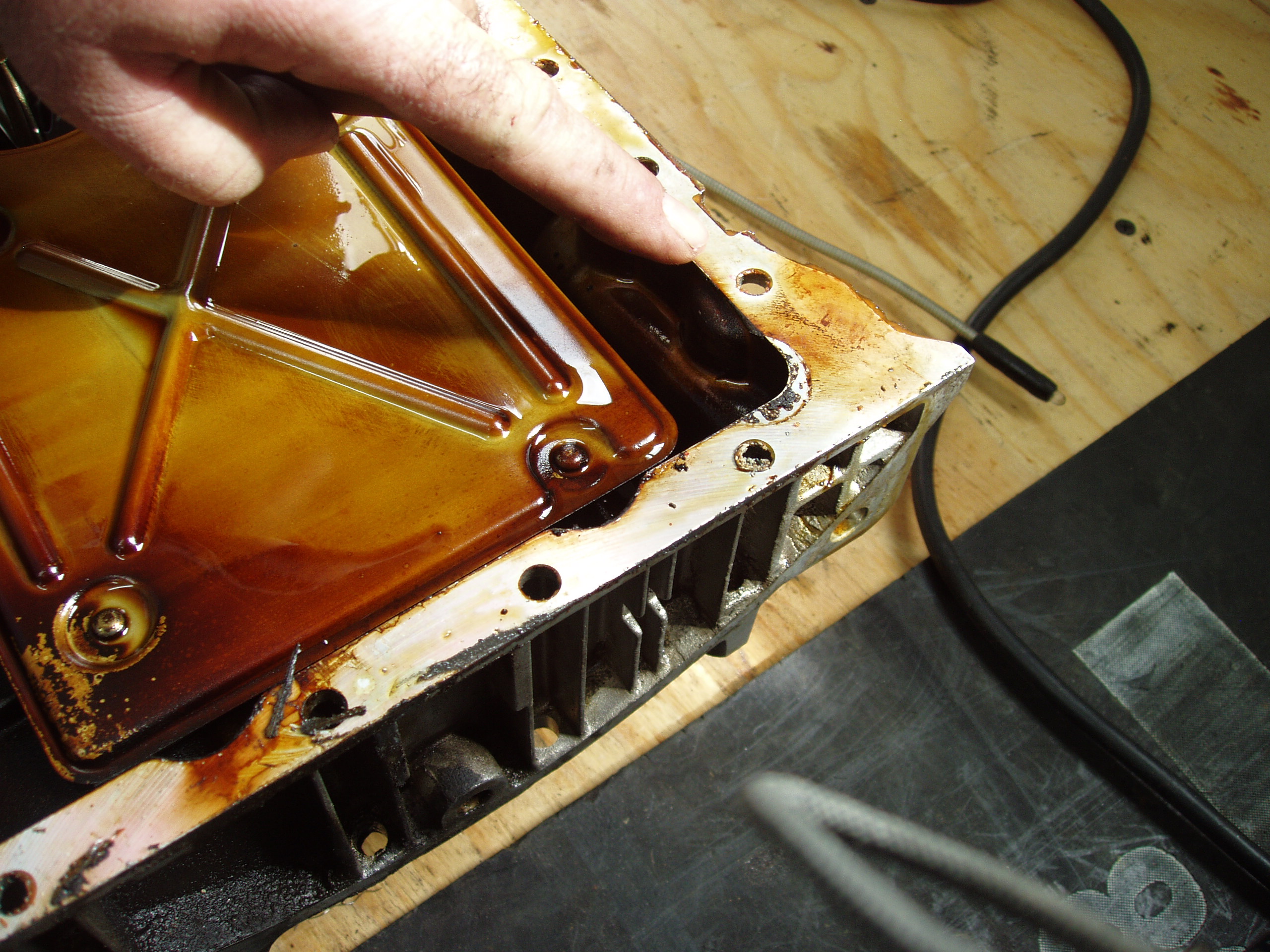

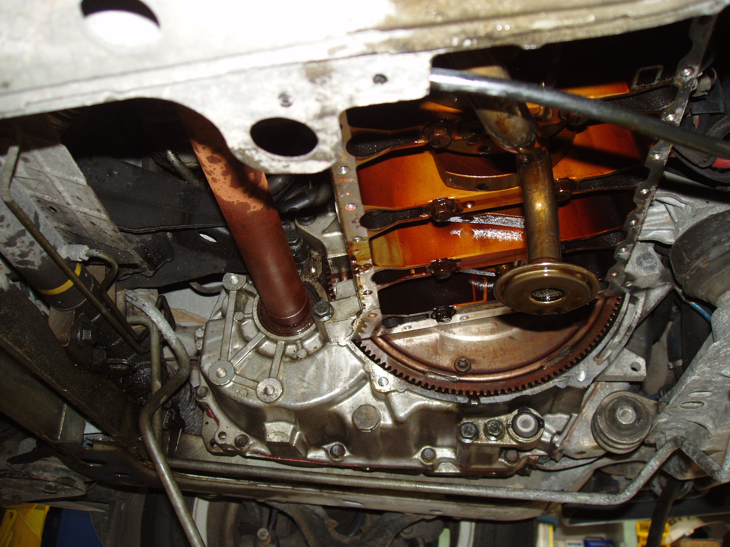

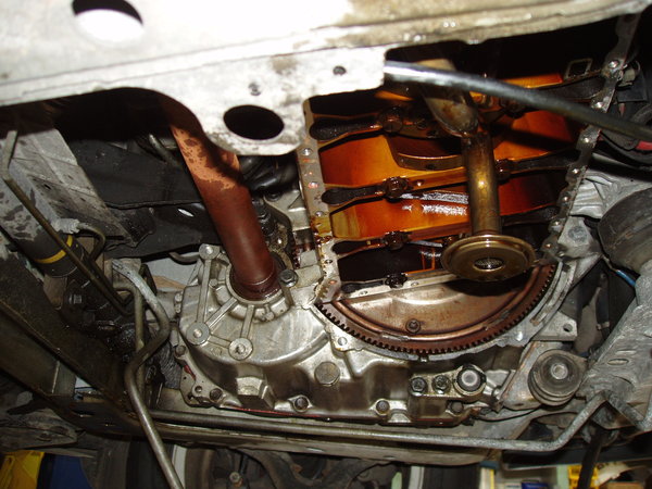

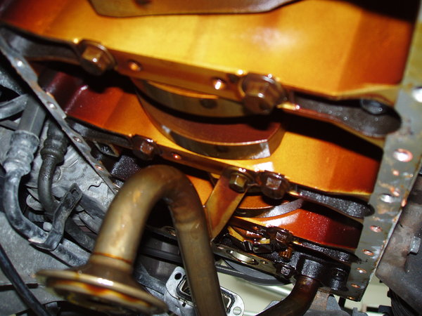

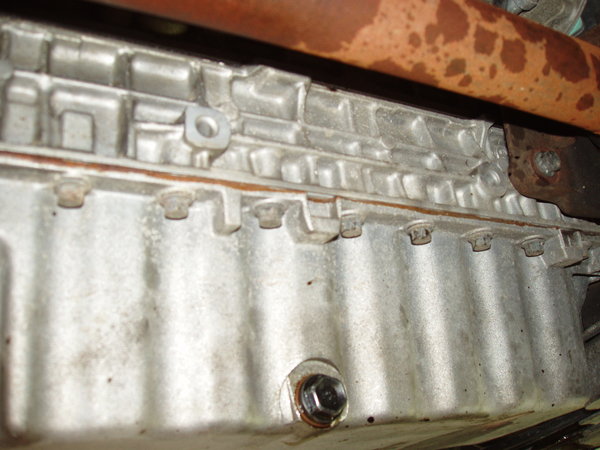

Well here is the latest update on my oil leak. The pan was indeed leaking. A few of the pan bolts worked there way loose and broke the seal causing a ever so slight leak. (As shown in pic, signs of leak shown at corner of pan resulting in a discoloring of mating surface) The problem was that, though the pan was leaking it was not the oil leak I was seeing. As stated in prior post by many, the culprit was indeed the RMS. I have some pics of that too, I will try and post them sometime soon.
The job overall was quite easy. You need only basic tools, a few o-rings and gaskets, a tube of pan sealant and a 3in paint roller.
What must be removed is
1. Oil cooler block from passenger side of pan
2. Transmission motor mount
3. Power steering lines
While I was in there, as suggested, I replaced the o-ring on the oil pick-up tube also.
Overall the entire job is about 2-3 hrs if you take your time.
