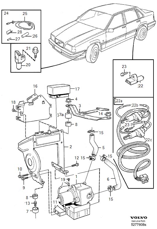

Thanks for the reply. Take a look at this. Part # 17 - 3515632
This is the part I am talking about.
Thanks

Did you read all the codes before trying to clear it? All codes must be read first. You might look at a junk yard for one like yours and see if it your ABS Module.
I am going to replace my ABS Relay first.
