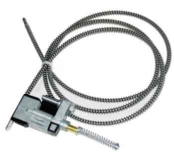

Hi Paul,
Most likely the coil wrapped steel cable is worn in the area that is slipping. Possibly you might be able to get some more life out of it by lubing the cable and felt window tracks, but it sounds like its worn pretty bad base on the video you made. I have attached a pic of the regulator assy and a sunroof steel cable just so you can get a sense of what you’re dealing with
Not sure how difficult the job is, but would estimate it to take 1-2 hours.
Good Luck with it.

great, thanks for the reply and help. i did take the door panel off, and played with the switch, but didn't see anything unusual...
i attached the two images the ipd guy sent to me, does that sound like that could be the solution?
