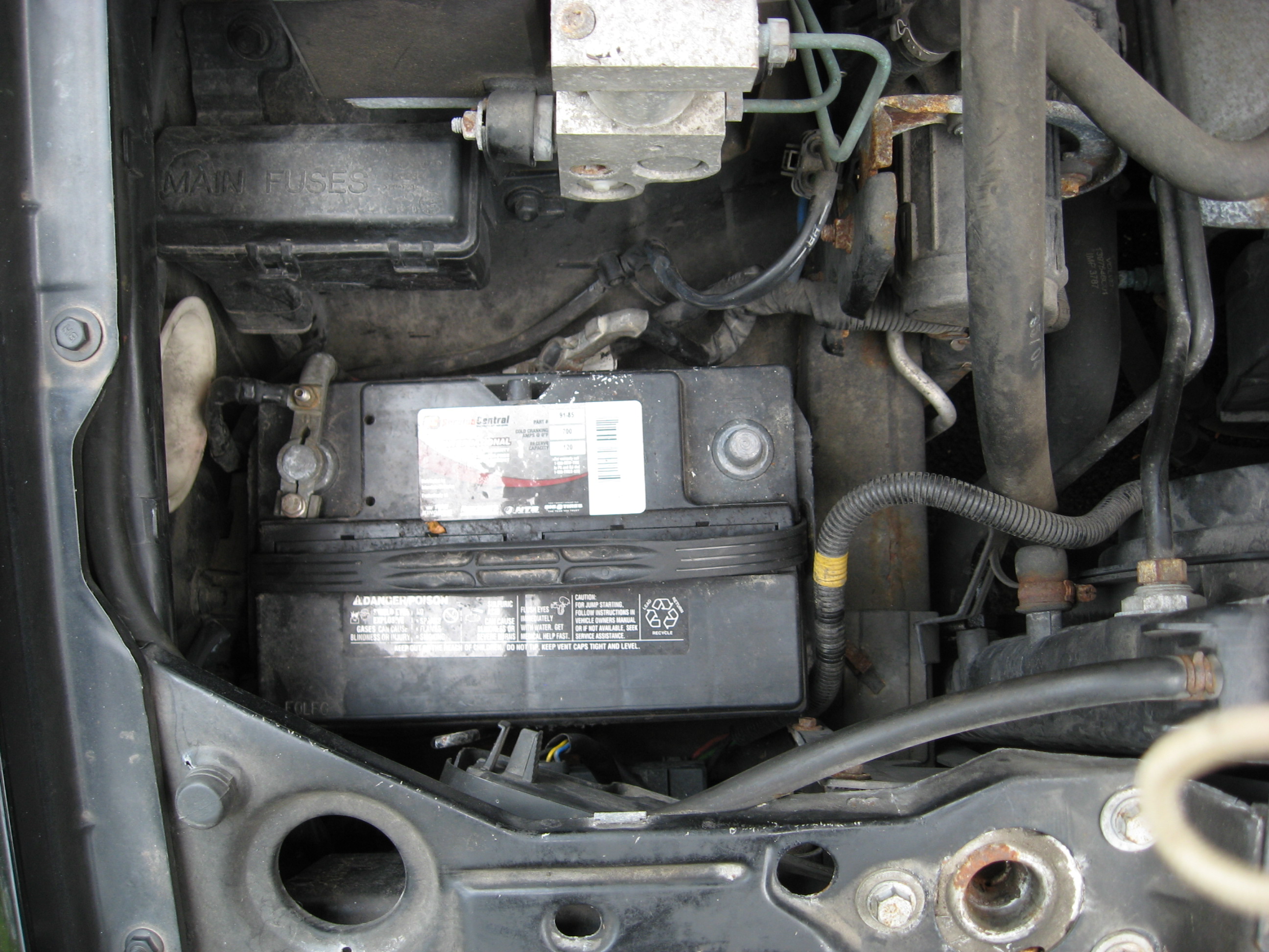

2.) Disconnect the negative battery cable because you're going to be messing around by the fan.
Battery Negative Terminal
