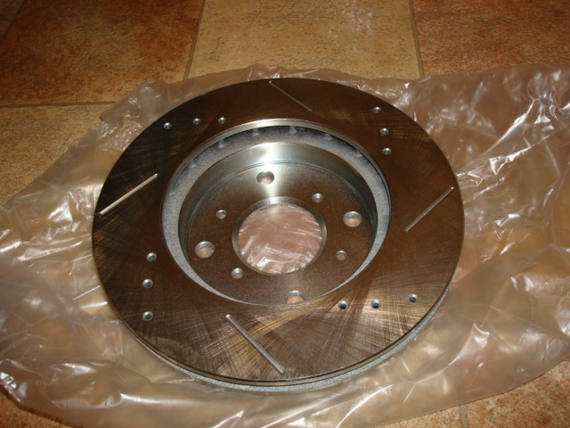

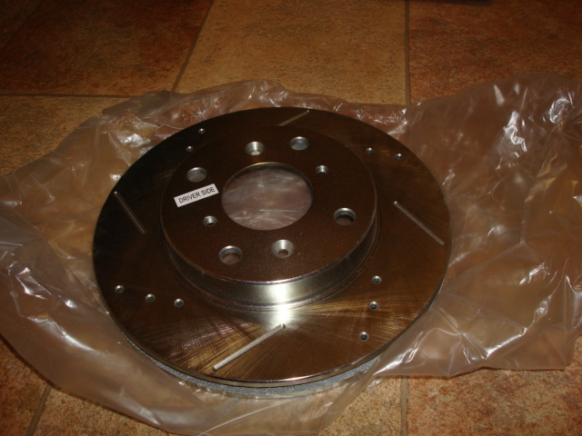

Which surfaces do you paint: both inside & outside surfaces that mate w/ the hub & inside of the wheels? or including the inside/outside cylindrical surfaces?
