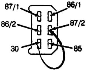

Whoops, missed that. Fuel pressure should be 42psi but I'm not sure about the flow rate as I have never checked that.
The in-tank pump is a priming pump for the main pump. The main pump can keep the car running without the in-tank pump but, obviously, it works overtime and will wear out quickly. Usually when the in-tank pump stops the car will run reasonably well whilst there is more than 1/4 of a tank of fuel. Once the level drops too far the main pump can't cope although it is still working. Another symptom of a dead in-tank pump is engine cut out during a turn.
Pull the fuel relay and connect a jumper between terminals 30 and 87/2 of the connector. Switch on the ignition and you should hear the pumps run.
