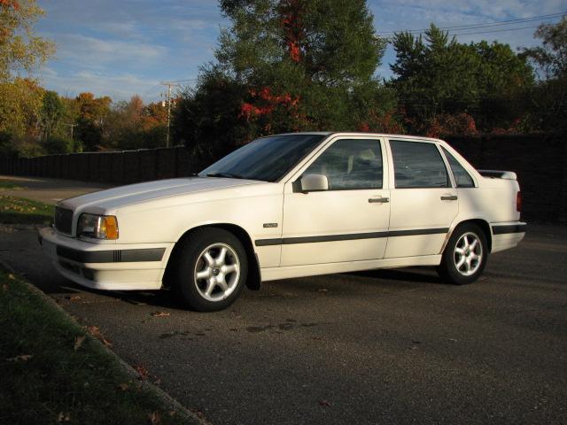

'93s are fun aren't they? It's a challenge to own what was essentially an experimental year. Mine has since evolved.
When I first got it a year ago.
original '93.jpg (66.8 KiB) Viewed 2561 times
