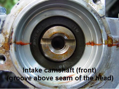

At any point in the process, did you remove either one of the cam sprockets from its cam shaft? If not, you should be able to re-align the marks on each cam and the crankshaft.

If you use the diagrams attached you should be OK.
There should be a mark on the cam sprockets which line up at 12 o clock.
Make sure the crank mark is set.
- exhaust cam.JPG (34.55 KiB) Viewed 2295 times
- intake cam.JPG (35 KiB) Viewed 2295 times
i did a head gasket replacement,both cam sproket was remove ,,i have been doing a lot of reading on this but its still beating me i think i kinda need some step by step instruction i tried making a cam lock tool but i am not sure where the the cams supose to be aling,i am determine to do this project on my own ,with all the help i can get from this site which seem to be the best volvo site
