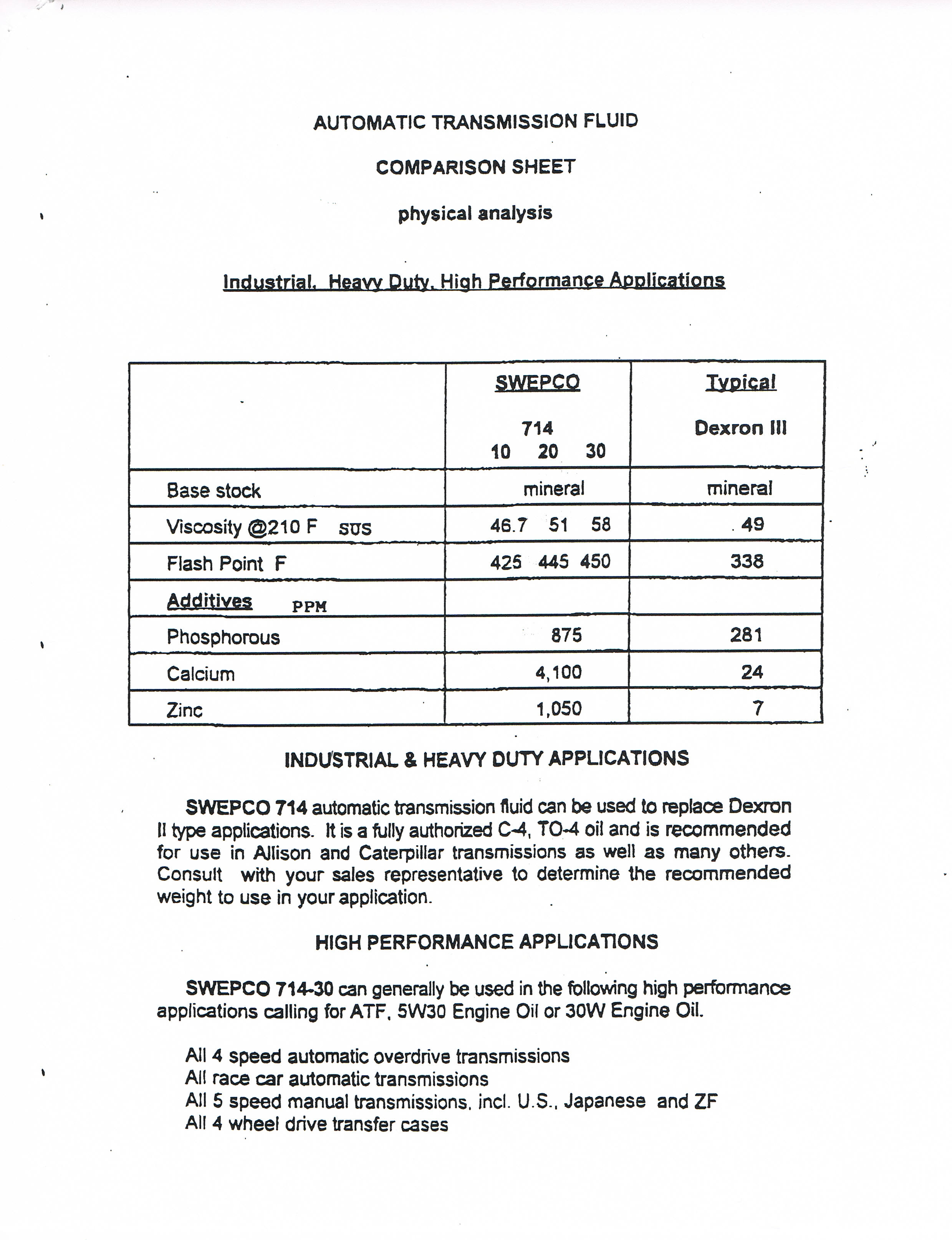

The 714 20W is all I use unless I am out or just need a quart or two... Attachment was provided by my Local Swepco Rep.

SO...you like the Swepco product for a direct replacement for the original Volvo tranny fluid? Which weight...10 or20w?BKM98 S70 T5 wrote:AlanS wrote:I hear so many opinions. I have a 2001 S40 with 100+K miles on it. I want to 'drain and fill'. What fluid do I use? It is an automatic, NOT manual.
