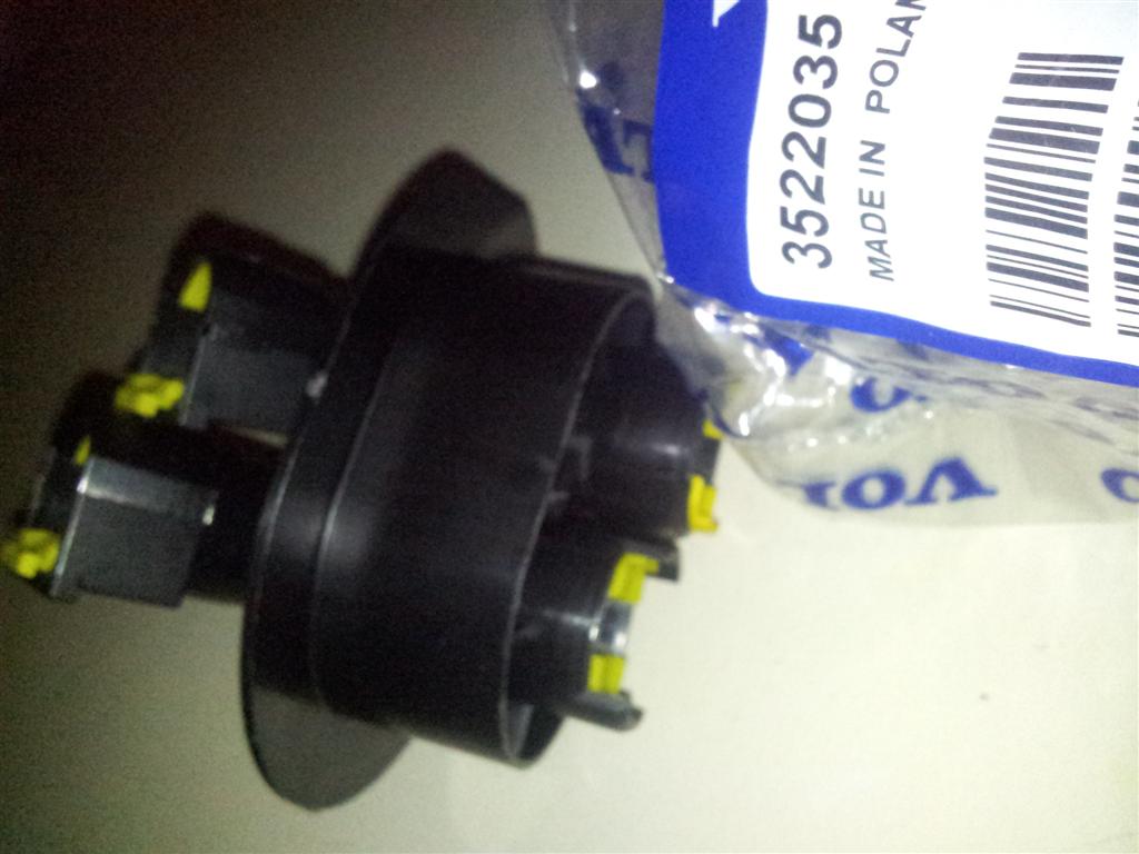

I'm about to do the same repair on my 2000 V70 after breaking the coupling by trying to use an extension spanner to reach the O2 sensor.
The seal kit made by URO for the firewall side has had mixed results and I can't remember reading a post where the repair has been successful. I tried this kit myself after totally cleaning out all the old spacers and clips from the coupling and it leaked everywhere. Both here and Volvospeed seem to report the same problem with the URO seal kit.
That's why if you want to do it right the first time order a new OEM coupling which comes with all new cips/seals for both sides or you'll likely be bypassing the heater on the day of the repair and be cold for another week while wating for a coupling.
