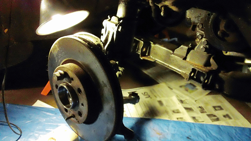

Below is a photo from my project.
In addition, Ozark Lee and cn90 refer to ride-height in their notes, where the axle/CV is most at ease.
It may cooperate.
axle removed...
axle removed...
